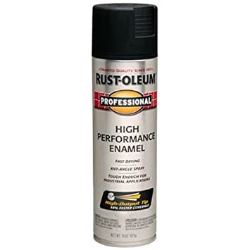

What paint did you use? Also, did you brush it on?
Same, I like to know. That looks great!
I believe I started with a basic primer for plastics, then used this enamel spray paint:
The paint I used said it was safe for plastics as well so I took their word. I finished with a semi-gloss clear coat. It came out a little shinier than I wanted so I rubbed over it with #0000 steel wool. Still a little glossy but I like it and it has held up exceptionally well.
