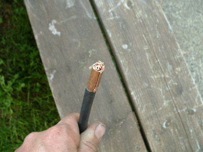

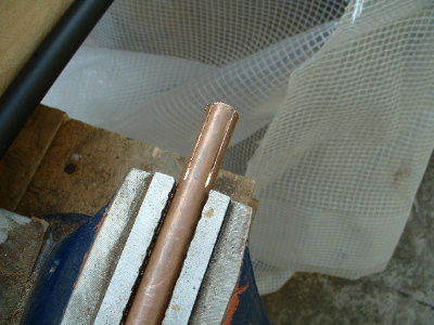

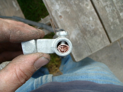

Learnt this one today from the boss, asked him about fitting new clamps to battery cables.
Strip back the inch of sheath and expose the cable to put into the clamp screws but slip an inch of 'half-inch' copper pipe over it before hand. This will keep the strands in the cable real tight and undamaged and they wont spread out away from the screw. The copper pipe might even be too large for the job but you can slice a section out like I did in the pics
Nice one :cool:
