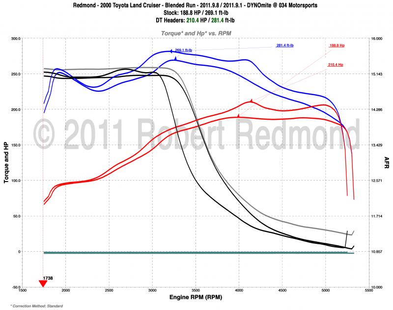

Things like headers/free flowing exhaust may improve hp/torque curves at the higher speeds but are going to do little overall and even less for low end torque. Maybe an average +10 ft-lbs across the range?
Reducing weight (especially unsprung weight with lighter rims/tires), regearing for larger diameter tires as already mentioned are more effective. Most people have gone to the headers primarily because their OE one(s) cracked, and then, why not?
Take a look at RobRed's dyno with DT headers:
Ok...can't resist: ^ "Why not (Doug Thorley headers) you ask :D?
Because they are NOT legal in CARB states...including California :deadhorse:
If not for the cracking OEM manifolds :(, as you stated as the primary reason for headers on our 2UZ-FE engines, I wouldn't know what a great stand up company Doug Thorley is all about. Not.

The DT headers do look promising.
