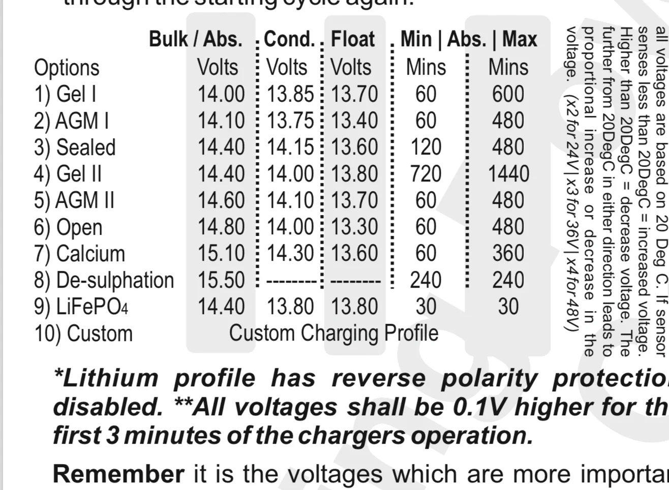

No direct experience with gel type batteries here but here's the page from my Sterling DC-2-DC 1260 charger FWIW.
Holey zoom out! Oh well, better than having to get out the magnifying glass :D
