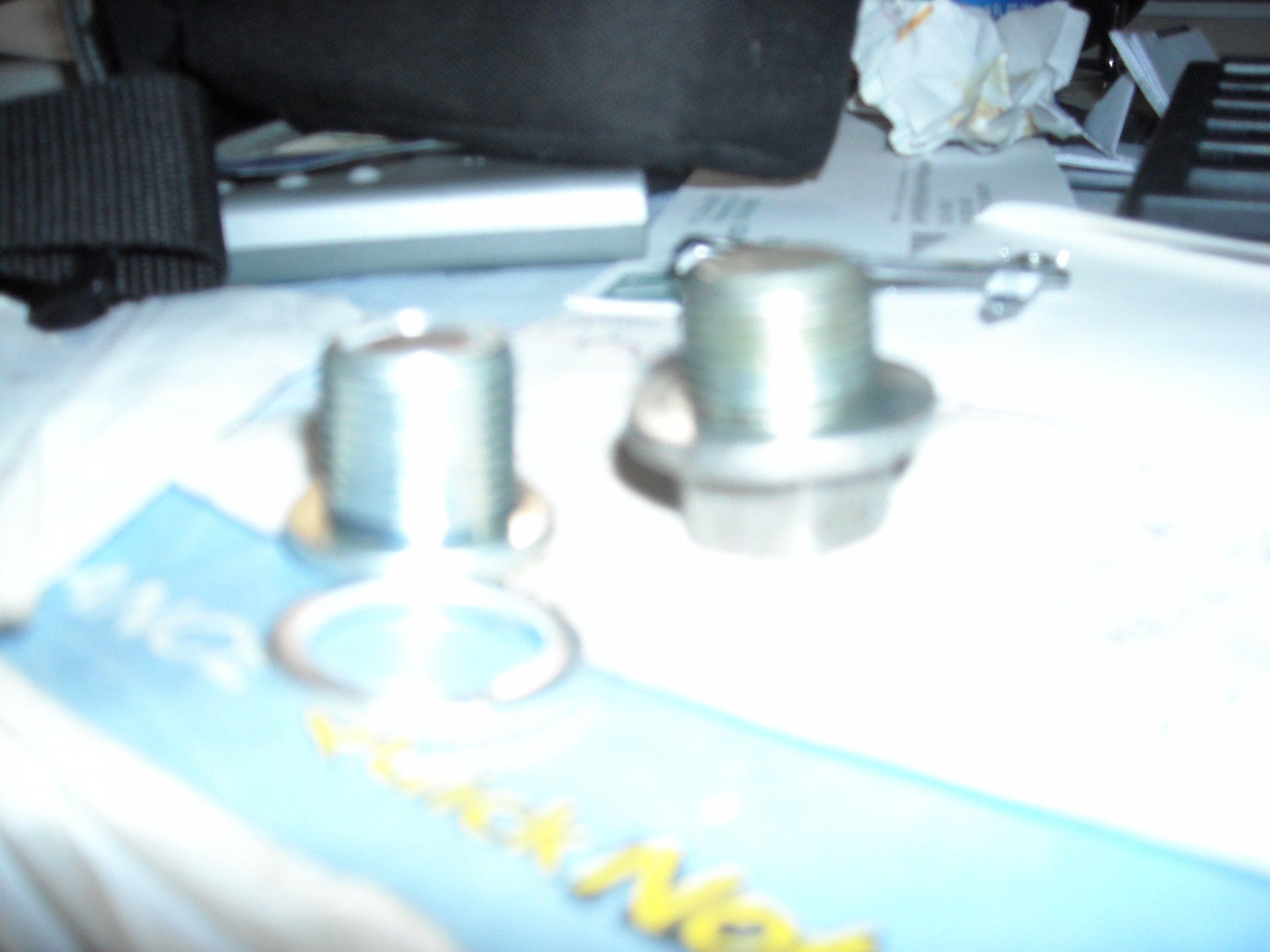

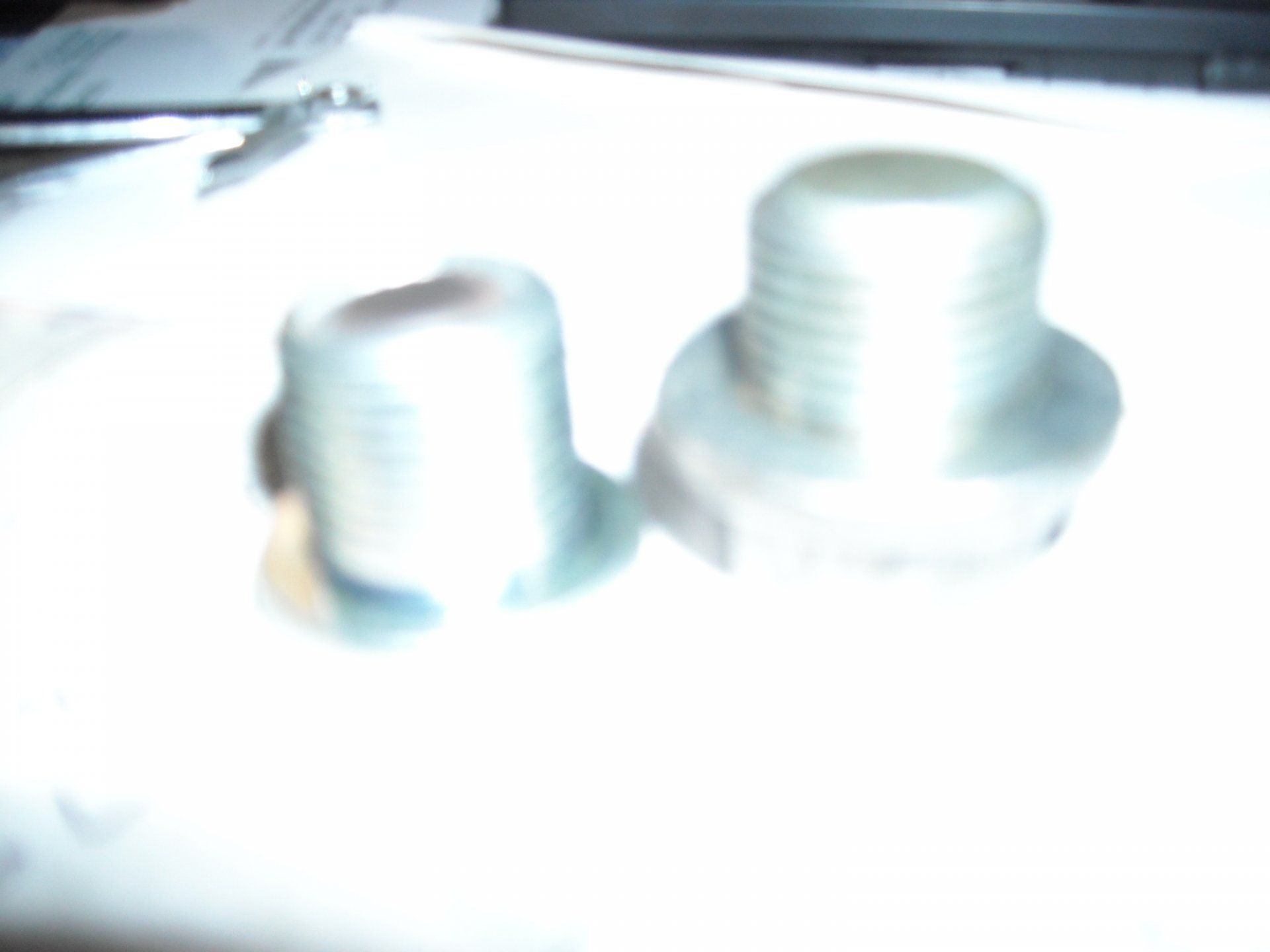

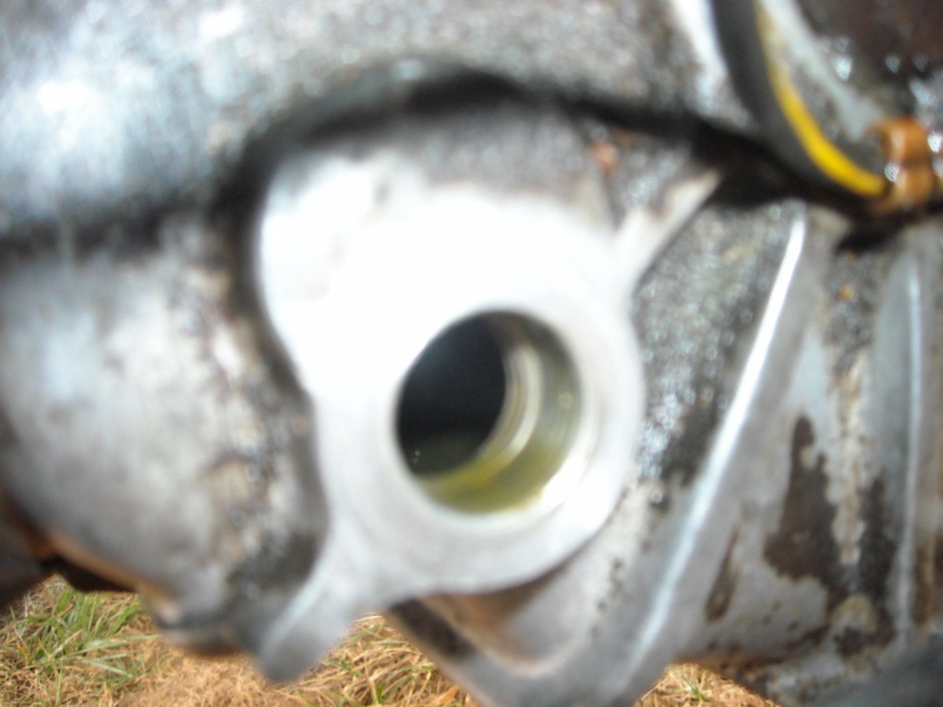

My transfer case fill plug hole is stripped. I noticed there is probably a 1/4 inch of good threads further in the hole that the plug can't reach. The plug is 18mm x 1.50 with about 1/2 inch of threads. I am unable to find a longer bolt in any hardware store. for now I have replaced the gasket with a thinner paper gasket so I can grab a few threads. I noticed that some 4x4 websites offer a magnetic round 10mm (female) hex head for replacing the axle housing drain plugs. But that plug is 24mm or at least the head is. Is there a 18mm plug I can order from toyota from a more modern vehicle that would be slightly longer...about 1/4 inch???

Personally I wouldn't want to band-aid that stripped drain hole. If that happened to my transfer case, I'd remove the rear case & take it to a machine shop & have them make a proper fix whichever way they thought was best.
The OEM magnetic plug link'd above is about twice the length of the stock plug and will reach those end threads, HOWEVER, as OSS states, chances are good that those remaining threads will go, too. If you can't do a proper fix and if you install the magnetic plug, use a bunch of BLACK RTV and only torque to 10 ftlbs or so and wait overnight for RTV to cure before refilling. And check it once in a while.

Happened on my transfer case a while back and my mate at Smart Automotive Solutions managed to fit a helicoil and new plug. I still put a dab of silicon on the thread when I refit it though.

definitely wouldn't count on just a few threads at the rear of the opening

Got this plug from wit's end today. Exactly what I needed. the plug does have about 1/4 inch more threads on it.
