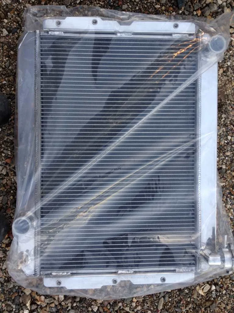

I purchased cc1213 that says it has a transmission cooler. After pulling old radiator i realized where the stock location of the transmission lines was not on the new one.
Did I receive the right radiator or do I need to send it back. The lines should go in on the left side of the picture
I don't see any bungs for a tranny cooler.
Think they sent you the wrong one. I have installed several of the championship radiators and have had good luck with them.
The one shown is not for the FJ62. There's no tranny cooler.
Looks like it's for the FJ60.
