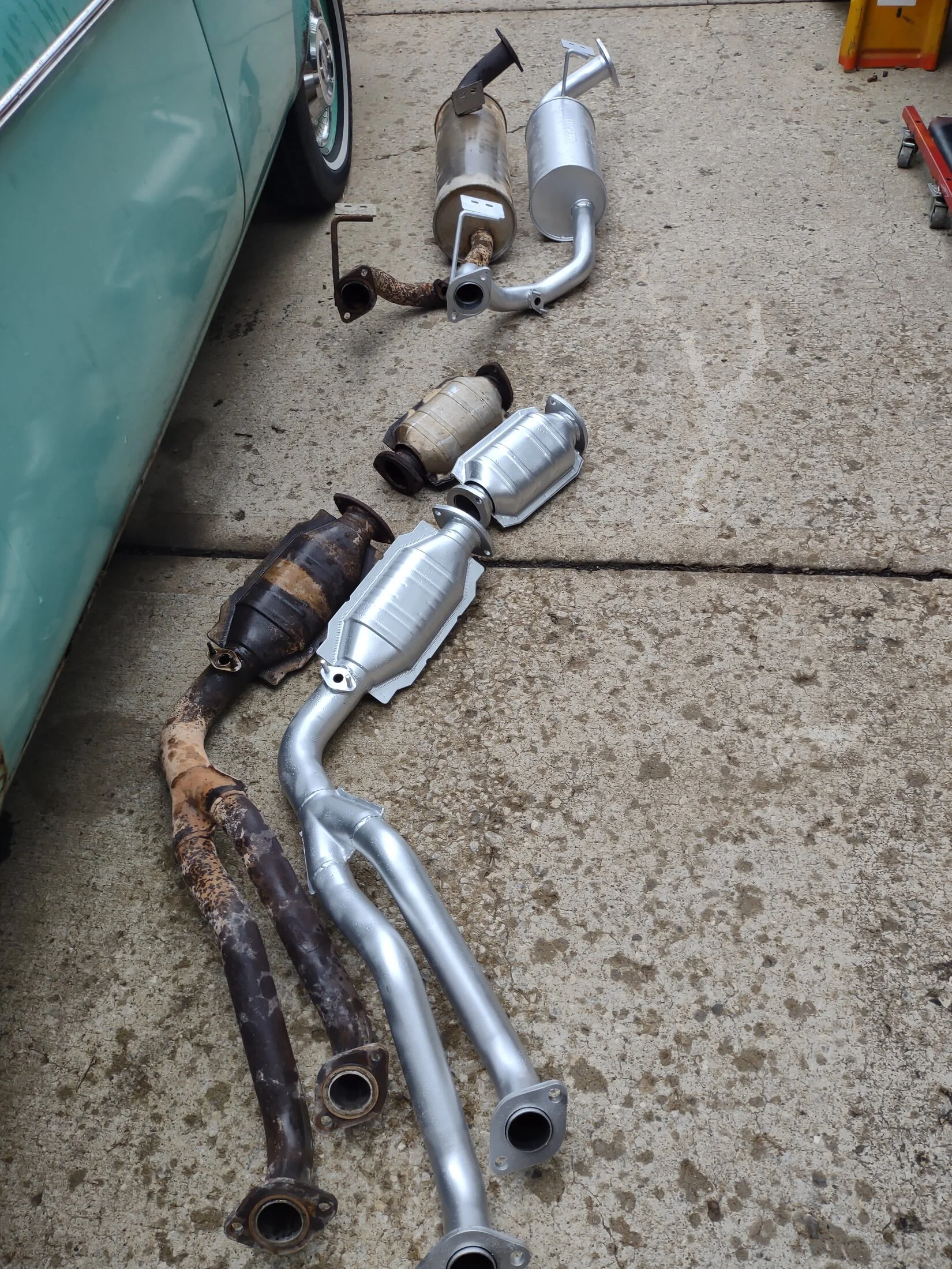

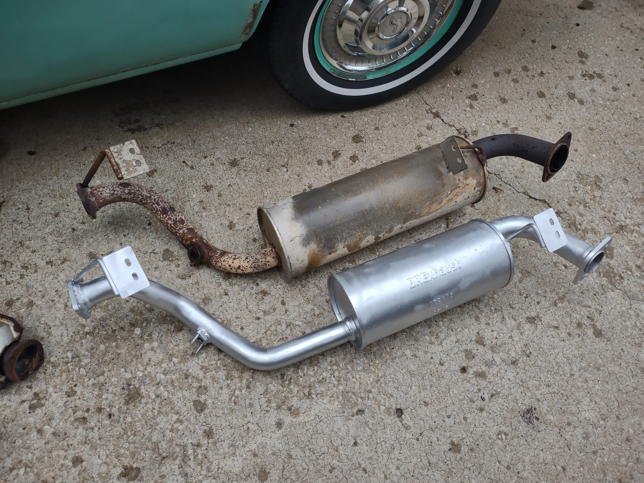

My old Magnaflow system to my new one.
Fit was excellent.
Still nice and quiet.
Changed out due to a cracked weld on muffler, rusted out bracket on muffler, and what was thought as a clogged cat.
89K miles in 6 years.
I got code 420, reset the code, bout 6 months later wife complained of f lack of power and truck being loud, bout 8 months later cat clogged blew the y pipe, no power on the hwy. Replaced with used y pipe with 175k and two used cats.

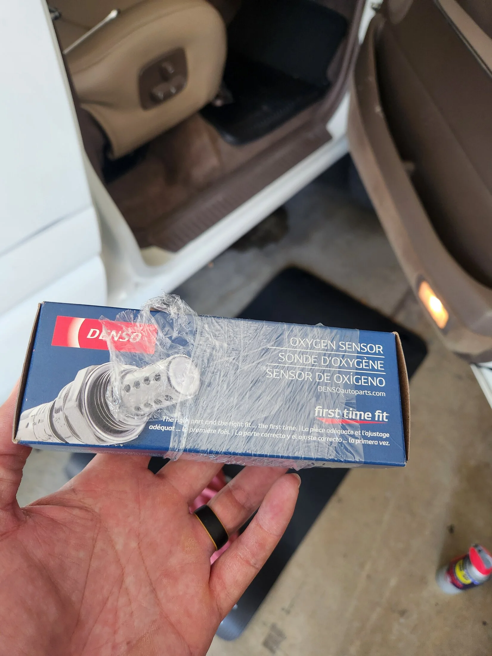

Just want to post an update. I just replaced the upstream o2 sensor and rest the code with my scan gauge. Attaching pic of the old o2 sensor. Still looked okay appearance wise but replaced it anyways.

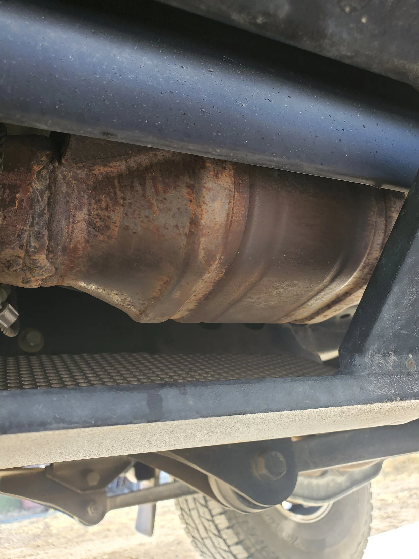

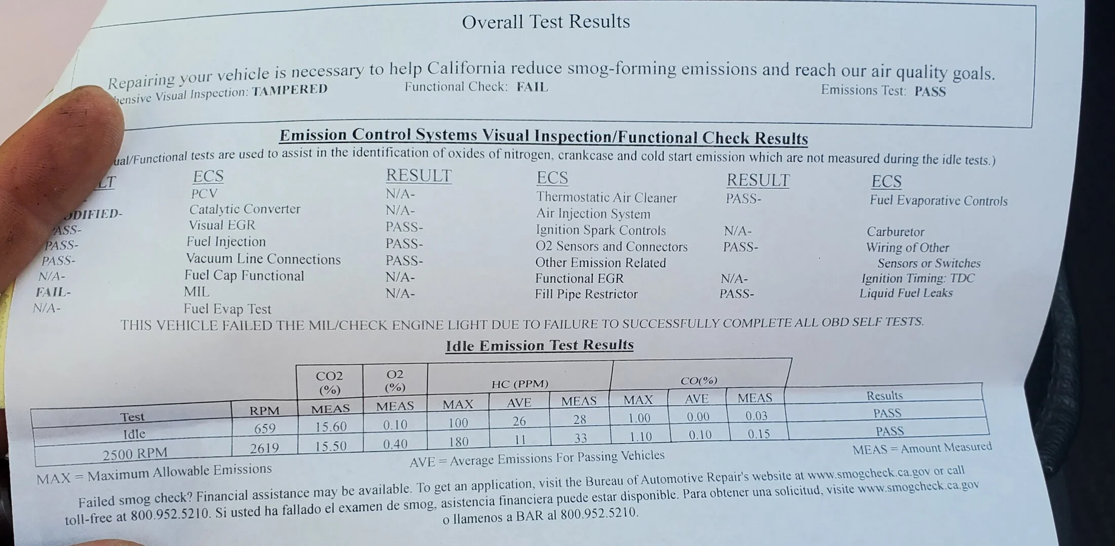

Just failed my smog in SoCal, my magnaflow cats are less than 10 years old with less than 150k miles. Actually passed the sniffer test with flying colors but failed the visual as the technician can no longer read the EO laser etching....says I would need to replace them both. Goes to show the priority isn't really about clean air.
Maybe a different shop?
