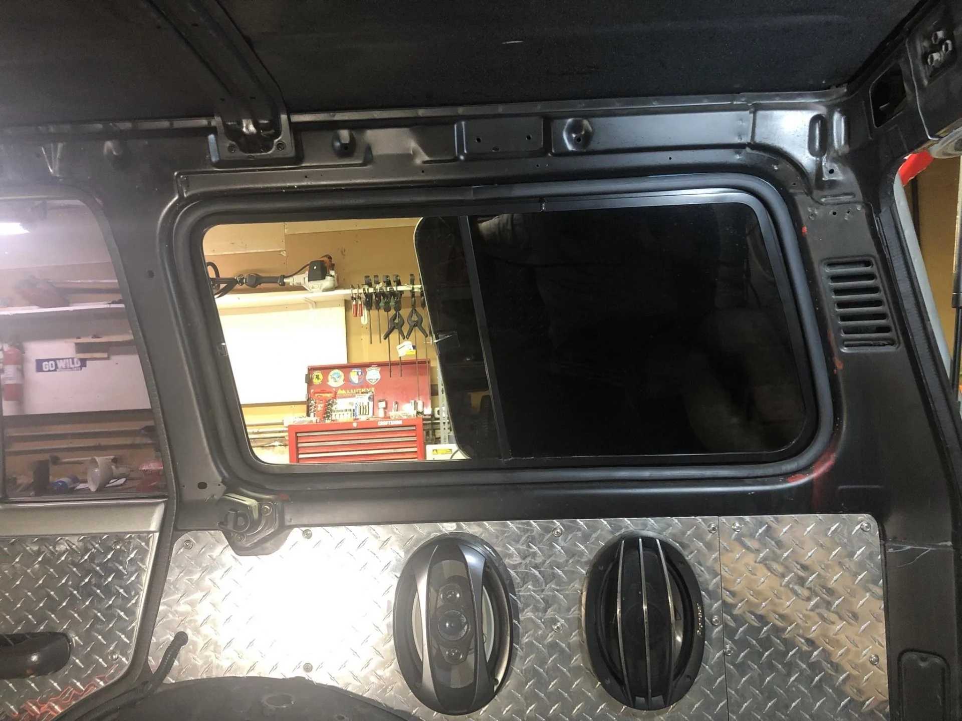

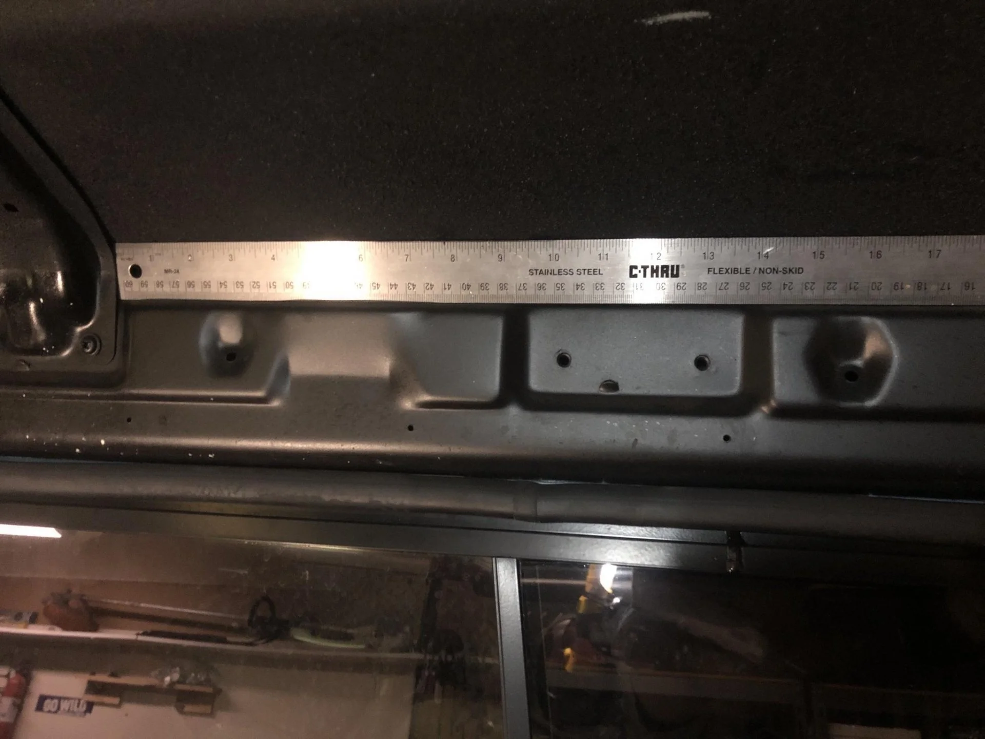

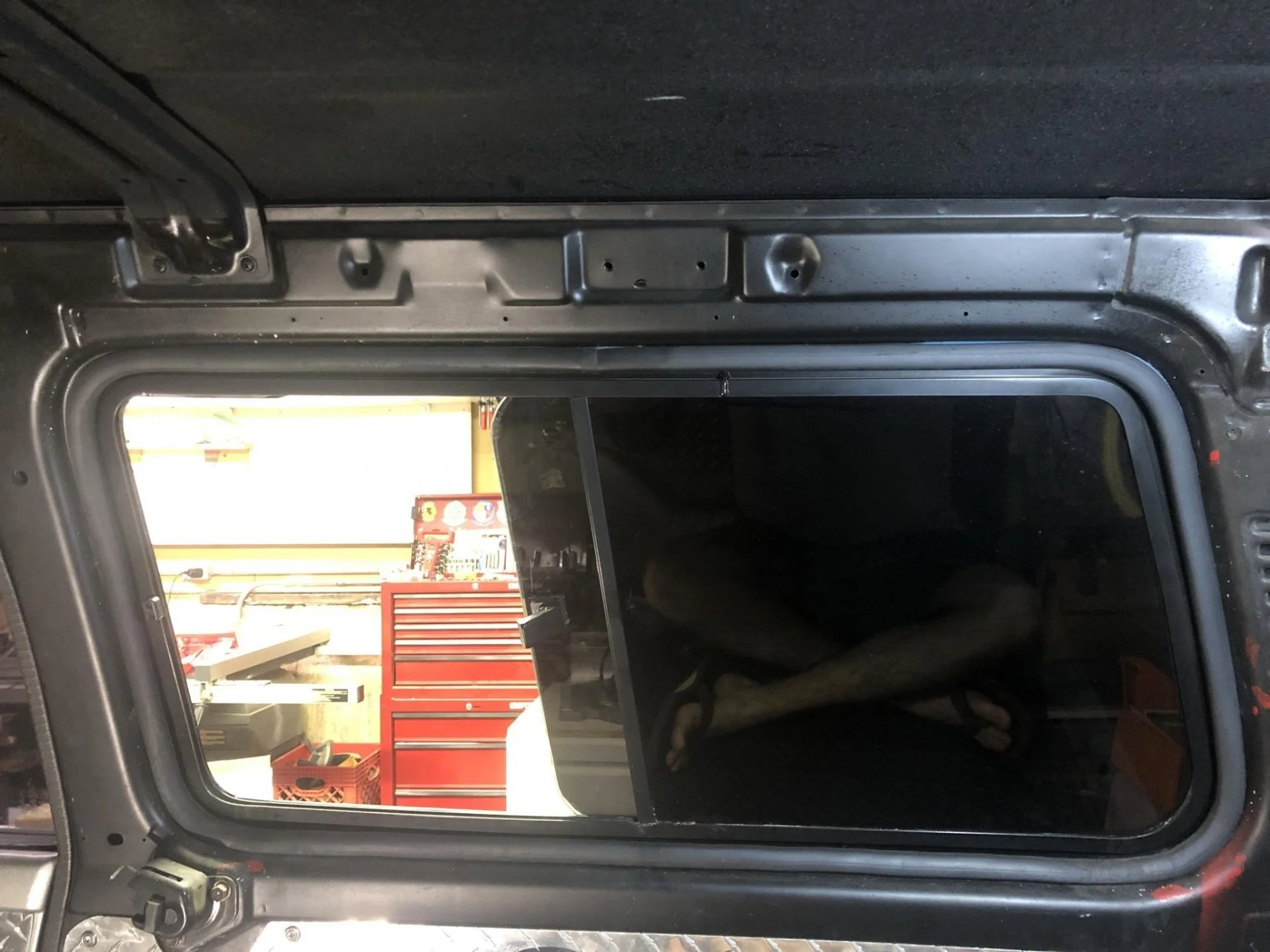

Heres a few pics from my 60 with no headliner. The two holes in the rectangular cutout above the center of the window are threaded M6-1.00 and I imagine thats where you would mount something. The outboard holes have no thread. Don't judge me on the diamond plate, it's on my list of things that need to go. Hope this helps.
that you so much that what I need, you did more than I even expected to see
