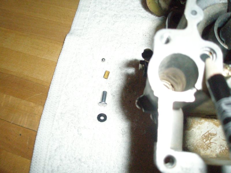

I'm looking for two parts from the photo- the aluminum looking stopper and the small black gasket below it.
My carburetor is the oem 1974 aisan. I believe these parts are the same in '69 to '74 models. The FSM isn't particularly helpful in naming these parts, just list them as 'stopper' and 'gasket'. The rebuild instructions list it as 'pump passage stopper'.

I suspected that it might but wasn't sure. Too bad that's not the case for the stopper. May have to buy an entire parts carb for that one little piece...
Form follows function. I would file a nail down to perform that function if I didn't have access to some. I stopped selling carb parts like that years ago to make sure I could supply my in-house rebuilds.
In case you haven't seen what the gasket looks like in person, it is flat. Like a rubber garden hose washer, but smaller. I would guess a good Ace hardware store might have something that would work. Perhaps even a round o-ring would work.
An important detail on your rebuild is, make sure the air horn mating surface is not too warped. And don't overtighten your sight glass screws, if you do and yours is actual glass, it WILL crack.
To add to what @thebigredrocker posted, the two things can be related. If the rubber gasket is too thick, it can keep the air horn from sealing properly, contributing to warping the air horn. Unfortunately,This is not academic . A fair number of gaskets supplied in rebuild kits are exactly that: too thick.
What makes matters worse is that THAT chamber is right next to the slo-jet that supplies fuel to the idle circuit. So if the gasket keeps the air horn from mating to the fuel bowl, it's also very likely to induce a vacuum leak that disrupts the idle circuit.

Mark & Redrocker- thanks for the advice and suggestions, looks like I'll have to get creative with this! Does the gasket just sit on top of the stopper or does it wrap around the flat part and create kind of a seal?

I used the rivet idea to make a stopper and found a tiny gasket from ace hardware (thanks redroccker!) and reassembled the carb. No change in my problem, I'm still getting hesitation on acceleration. Any hope for this carb or is it a goner? Stacking two gaskets between the air horn and carb body probably not a good idea? With the carb assembled and running, I can see the air horn gasket become 'wet' but not actually leaking. Is this warped air horn possibly causing my rough/hesitation on acceleration?
