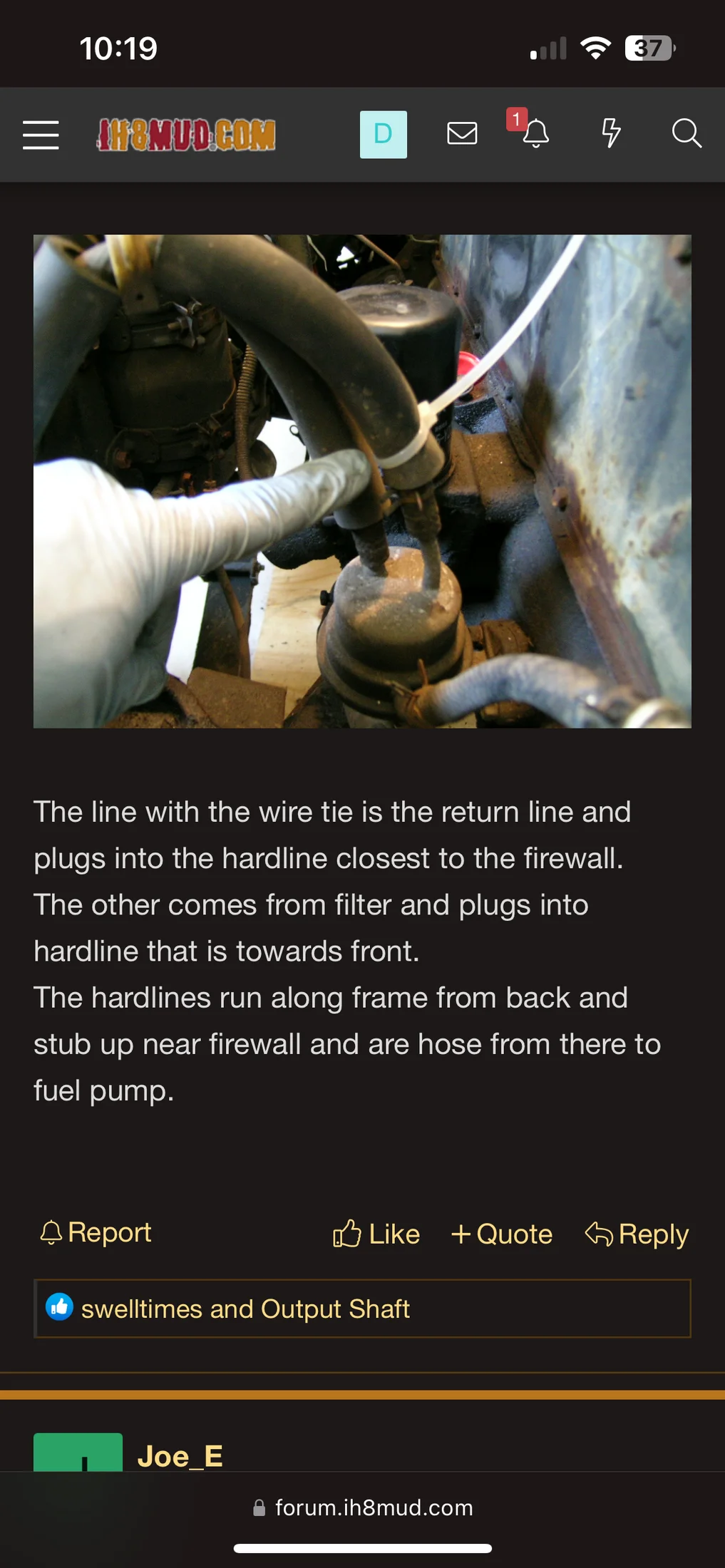

I forgot to mention I also replaced the fuel pump with a new OEM one. I checked the sight glass and there is nothing in there. The fuel filter is half fuel though, so I’m guessing the issue is somewhere between the filter and the carb. Thanks for the tip. I’ll check the FSM.

Make sure you have the fuel pump spacer installed. Also verify you don’t have the fuel lines mixed up. Starting and dying just sounds like lack of fuel.

I definitely replaced the spacer and gaskets. Can you let me know if the description of the fuel line order is correct in this previous thread? I relied on it when I reconnected the lines.
