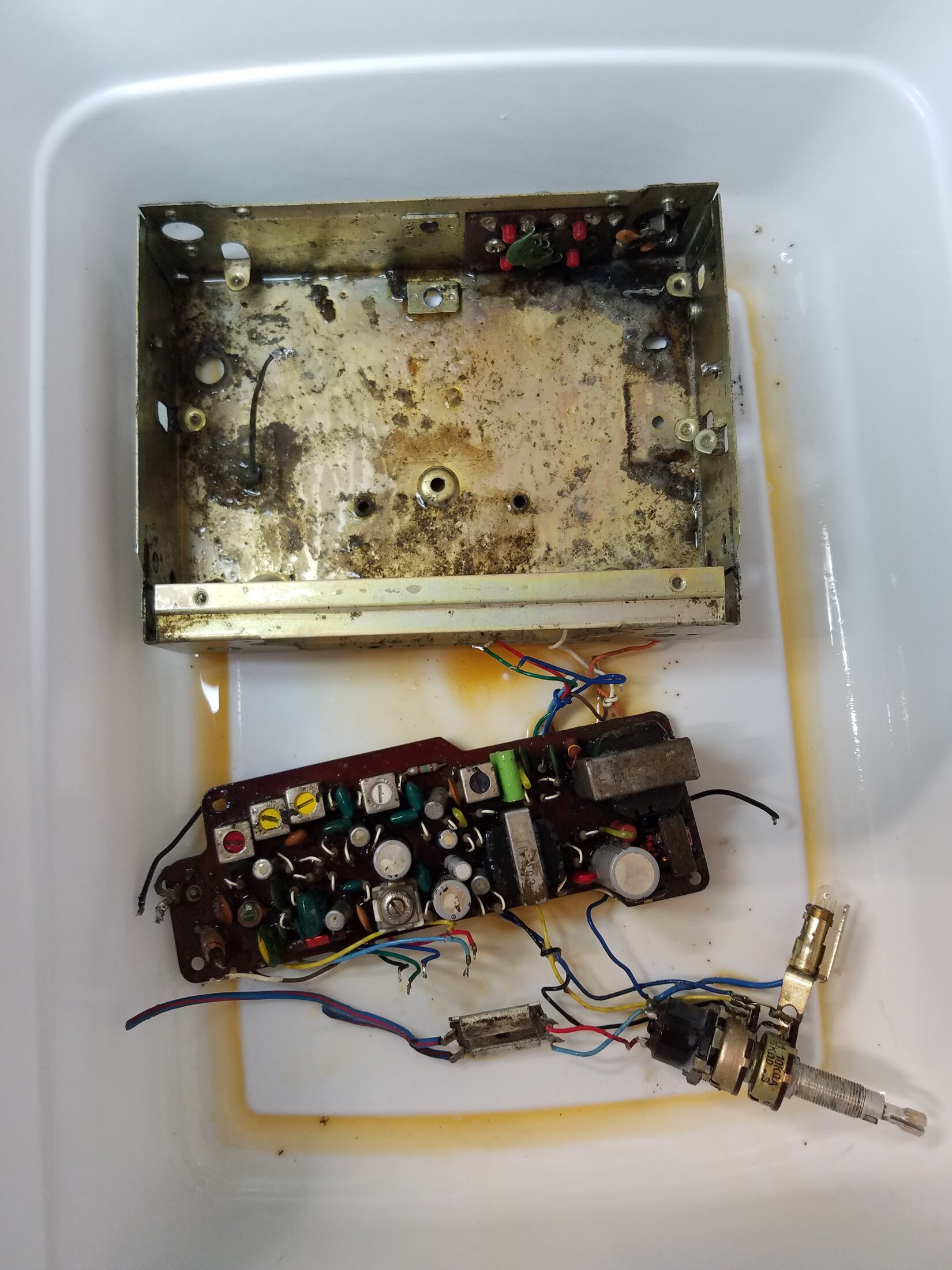

You never know what you will find when you open up these old radios.
cleaning

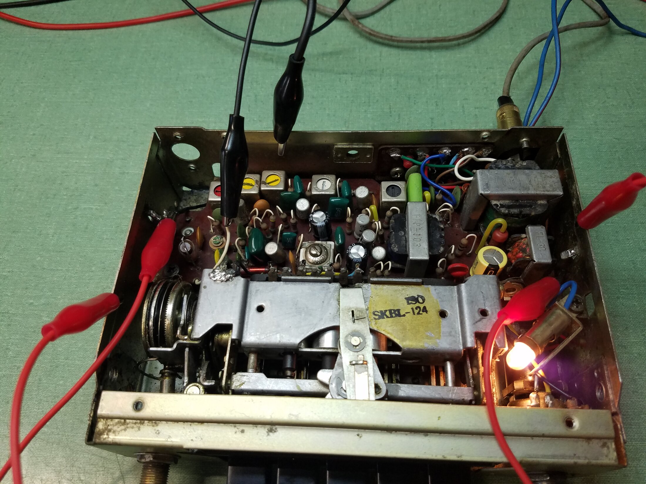

after cleanup and return to service, this one also had some bad solder connections on the circuit board

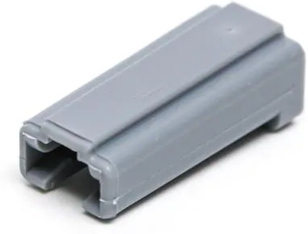

Looking for connectors recently, I ran across this 1P terminal that is used for the oil pressure sender.
PN 6190-0516 or 12015306
I'm assuming a bunch of different models of Toyotas used this connector. Thanks for the p/n. Good to have a spare, or two, of these.

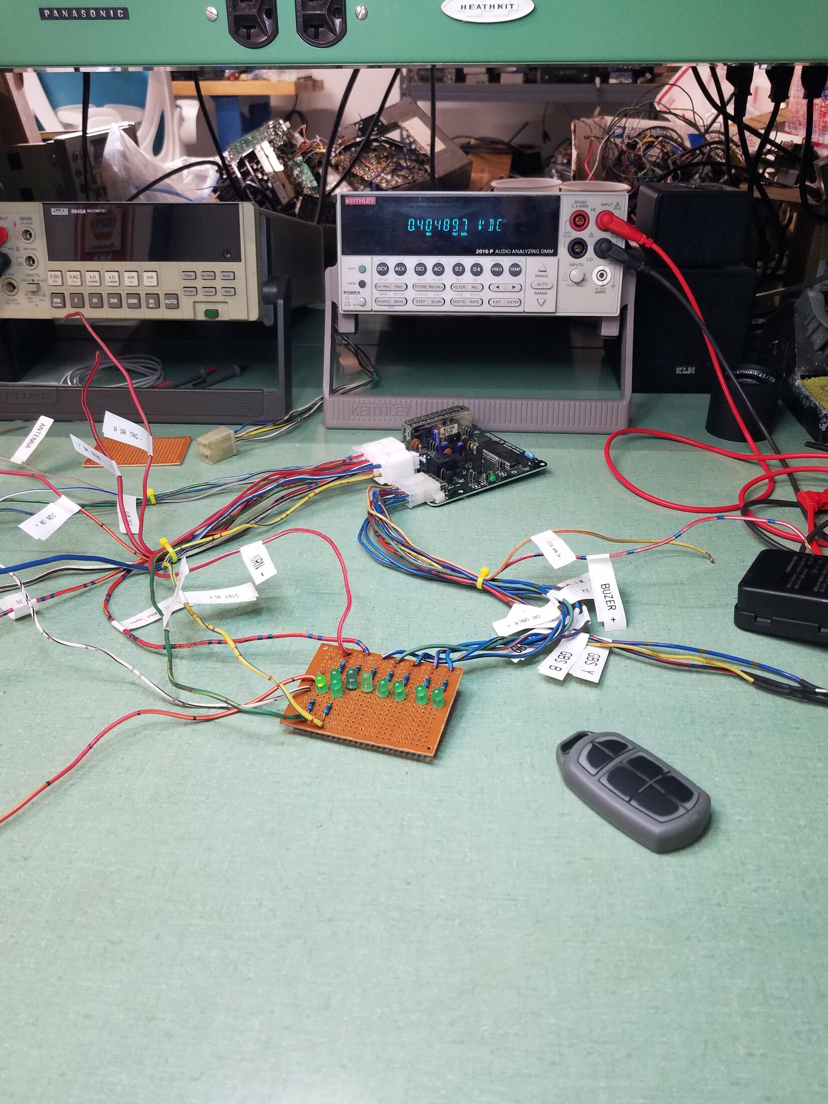

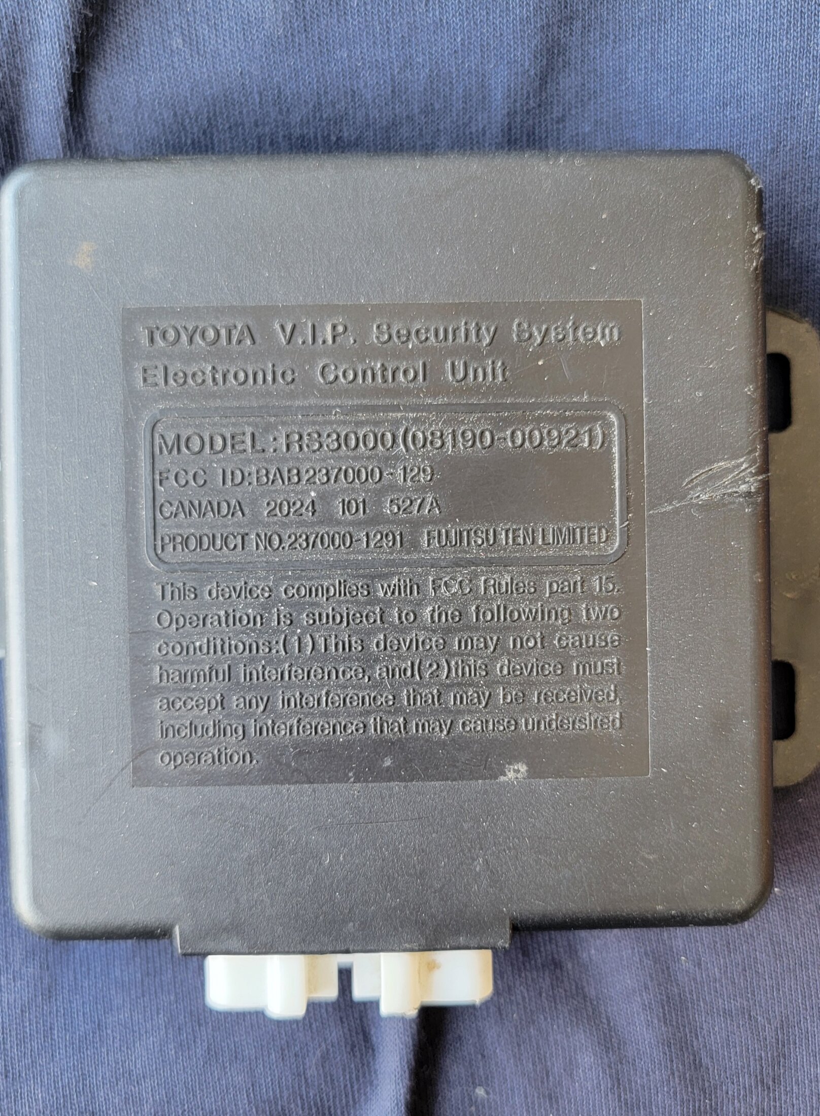

I've been working on this lately, for testing the RS3000 Security Control. I have some switches on order for the inputs, a buzzer, and speaker for the glass break sensor.
cleaning

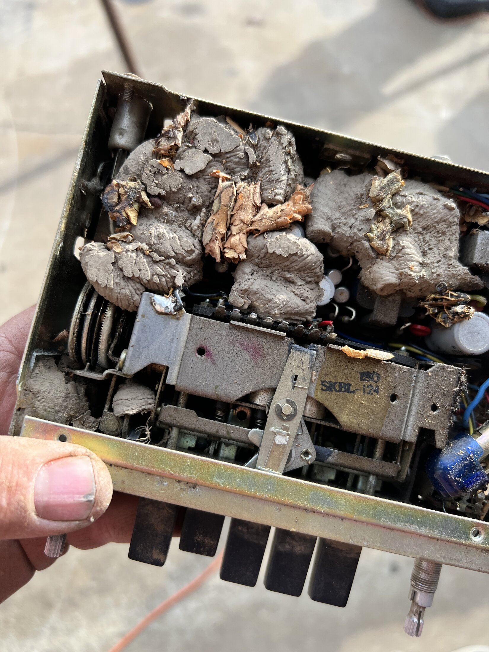

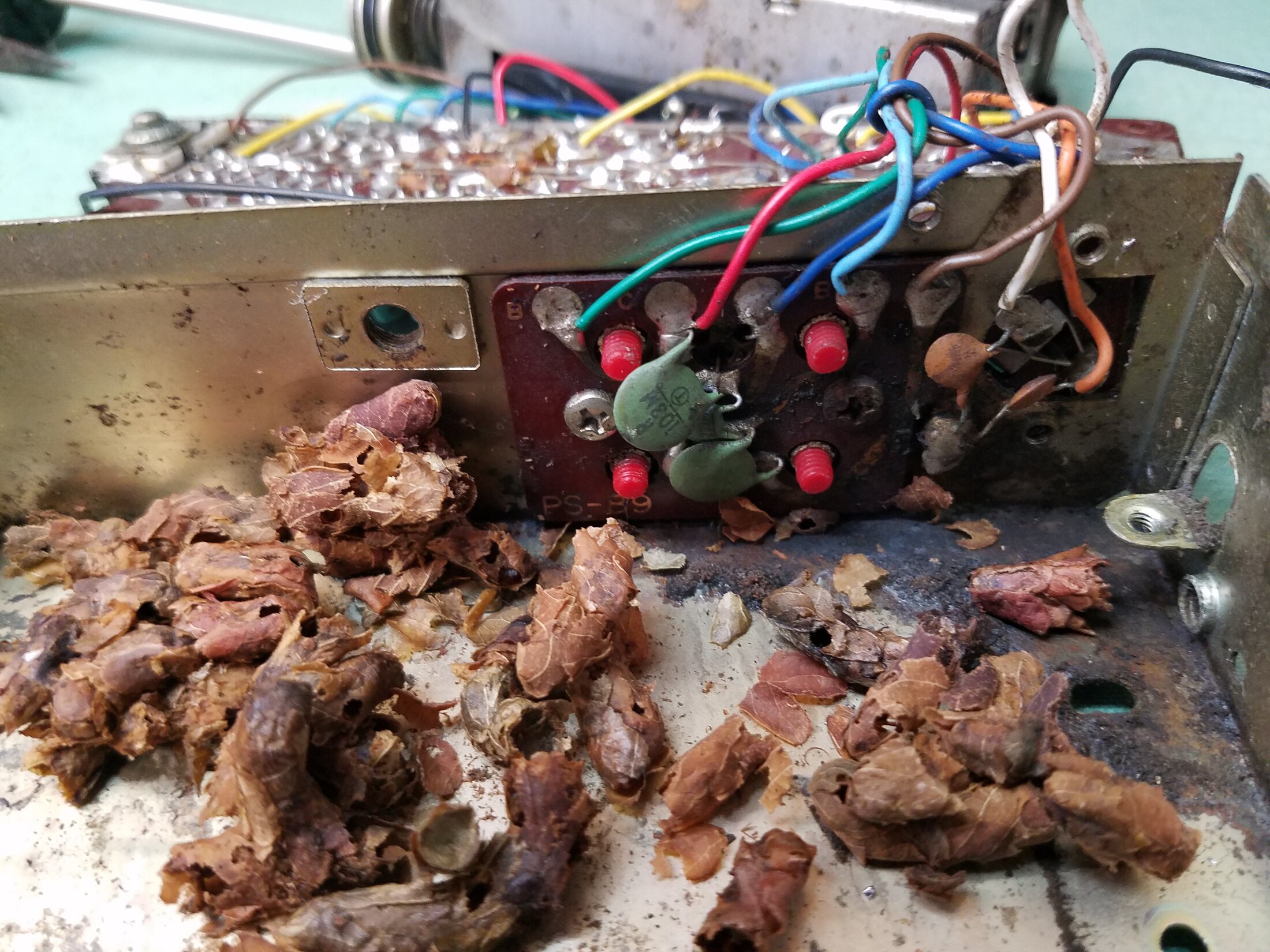

I know this radio. It was a customers of mine. When I did the build of his 40 I opened it up to find this below.
I’m not an electronics guy by any means but i
cleaned it up and had it working well. Crazy that it succumb to the same fate again in only a years time.
Thanks for bringing it back to life once again!
It was still working intermittently. I always tear these down to bare case and clean up, you never know what is lurking below.
Mud Dauber Life cycle, they like black widows:
Mud daubers undergo complete metamorphosis, which means they pass through four stages during their lifecycle – egg, larvae, pupae (cocoon) and adult. Depending on the species, they complete one or two generations per year. In the spring, overwintering pupae develop into adults. The new adult females will construct nests comprised of mud tubes of varying sizes. Each mud tube is provisioned with several spiders that the female mud dauber catches and paralyzes with her venom. The female mud dauber deposits an egg on the first spider within each mud tube and then seals them with mud. The mud dauber larvae will hatch from the eggs and feed on the prey left behind by the adult female mud dauber. Then, the larvae will develop into pupae, a process that usually takes about three weeks. The pupae will spin a silk cocoon to overwinter until the following spring when they become adults.
