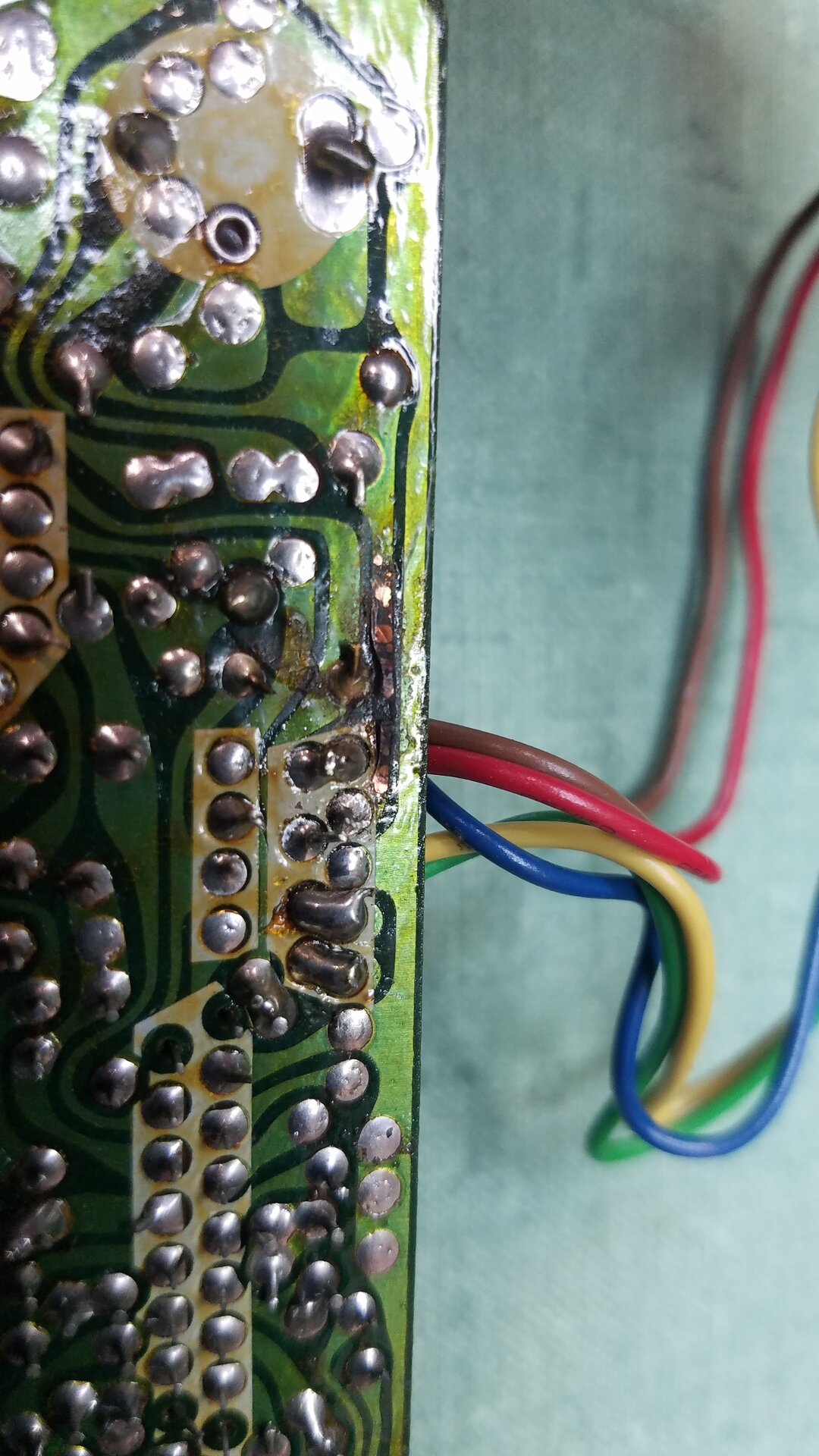

Giving away some free radio knowledge to the community. If you power up an fj60 radio with the power reversed, you will smoke it. I have seen this a few times, and knowing the value of these radios now, I will share with you the likely damage done. You will likely find a burned/open trace on the little electronic volume control circuit board. This board is in the rear of the radio above the amplifier board. Fix that first by installing a jumper wire between the nearest solder pads on either side of the broken trace. There may be other collateral damage, but this usually fixes it.

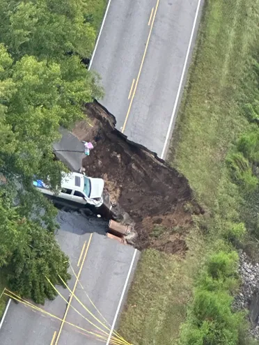

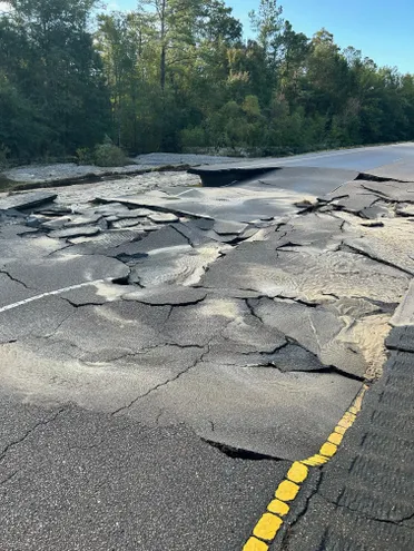

Just a heads up. PTC 8 dumped about 17 inches of rain on our little town of Boiling Spring Lakes on Monday. Most of the roads around us are washed out, others are still flooded. I'm saying that to let you know that if you sent me something, the mail will be delayed.
There are many more like these. Worse than Florence, I think.
NC 211
NC 133
US 17
