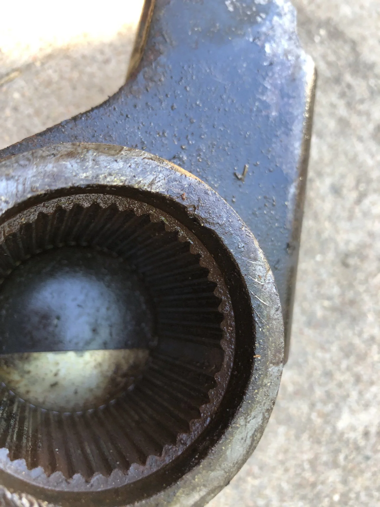

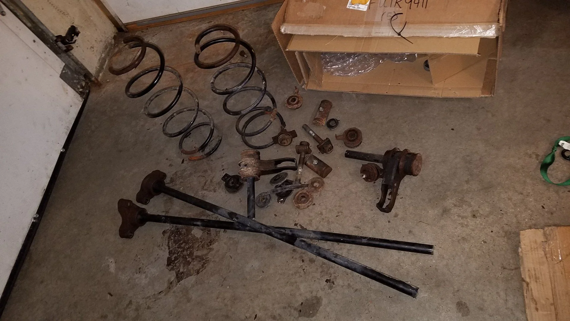

I am trying to swap in some OME torsion bars to replace the completely shot OEM ones. Quite easy to get adjuster bolt and torque arm out. No significant rust to speak of. However I cannot get the torsion bar out of the anchor arm. Have tried a couple different times on both sides. PB blaster frequently over the past week. Heat, brass drift, brass hammer, little bit of air hammer (don't want to destroy the arm)... can't get it to budge. Any additional ideas or tricks. I am considering that I might have to cut the torsion bar to get the arm out, but will need to have a replacement on hand (~$75 at least each side) in case I can't get the cut arm off of the torsion bar. Also considering taking it to a shop (Japanese auto or someplace) and asking if they can free the bar grease it and send me home to finish the job.

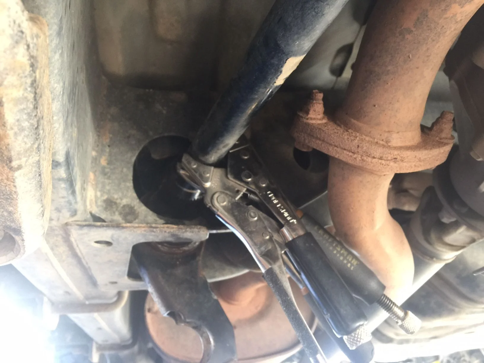

You need to hold the torsion bar with some kung fu grip while smashing the anchor arm, it's thick metal it's not going to get damaged, a few good whacks and it should come out. Mine was seized and rusted to shiets and that's how i got it off.

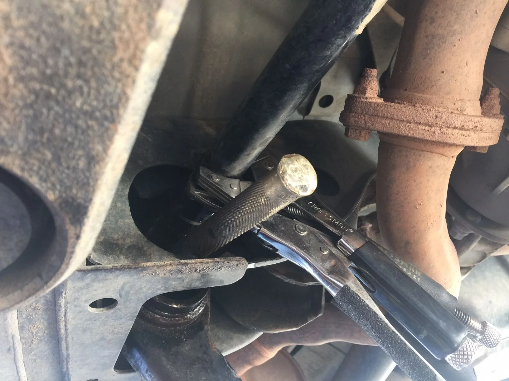

Here is what ended up working for me... vice grips cranked on the t-bar, then I could hit the anchor while the vice grips held on tight and locked the t-bar from moving by butting up against the frame cross member.

Ok, Gonna give it another try with this method in a day or two when I can get an evening free.

What ultimately worked for me was:
@REZARF 's vice clamp idea above. Remove the front of the torsion bar and free from torsion bracket so you can get the bar as far towards the front of the truck as possible. This gives you the best angle at the lip of the anchor arm bracket. Vice clamp up against the crossmember and a buddy holding this as steady as possible.
Then lengthy heating and pb blasting cycles along with some STRONG hammering with a brass hammer. Once I got it to move a little the air hammer popped that sucker out pretty quickly. Once we knew it could be done, the second one was done in 5 minutes.

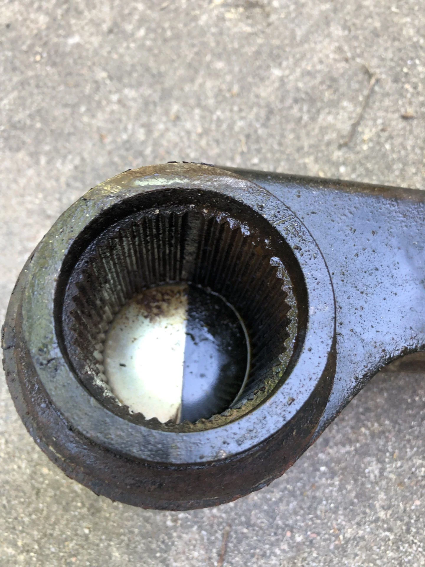

The arms are a little rusty, but nothing too bad, just a 19 year old rig. I will clean them out and grease with the OME going in.
