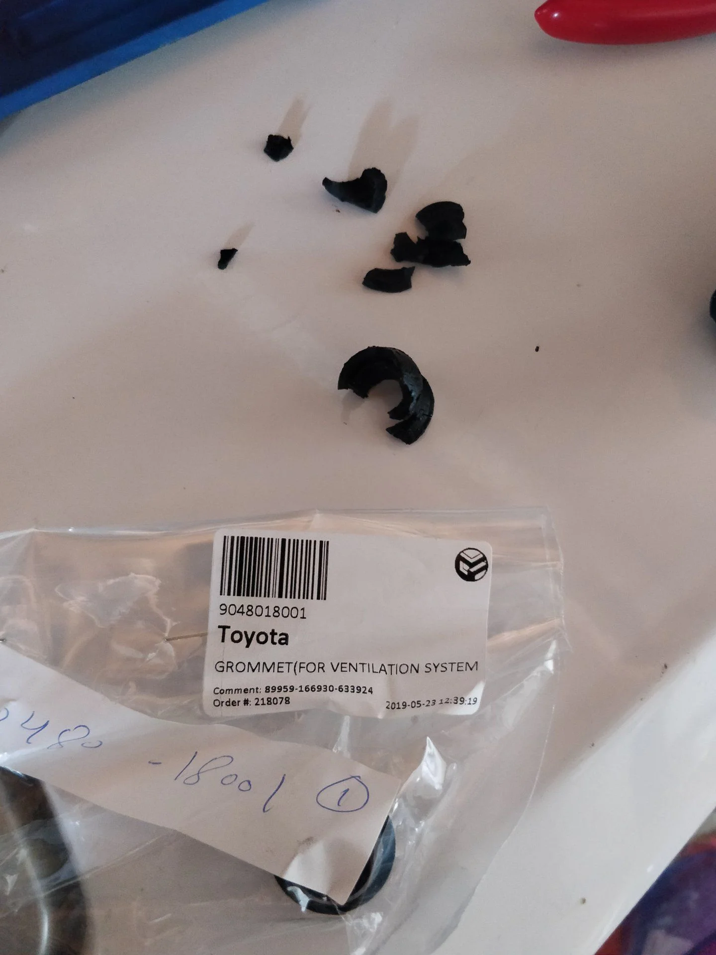

I'm trying to replace the PCV grommet but can't get it out.
I tried different methods/tools but it started to break into pieces and I stopped right there.

Dealing with fishing out my grommet right now... thank you @2001LC for the prior words of reassurance about the small crumbles i know have gotten past my ability to pick out. (There are more peices in the trash)
Bottom half of the grommet fell in. How serious is it @2001LC?

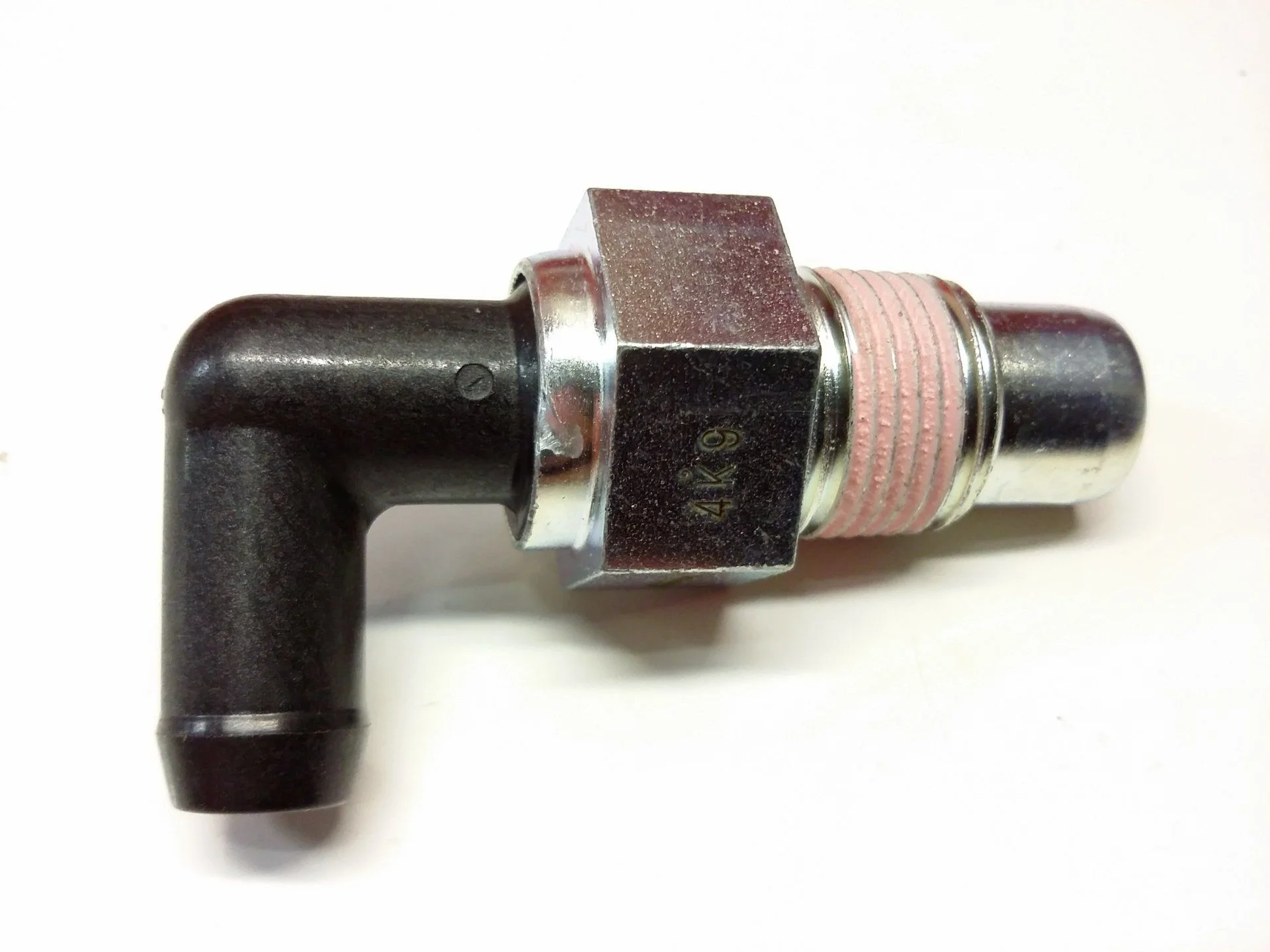

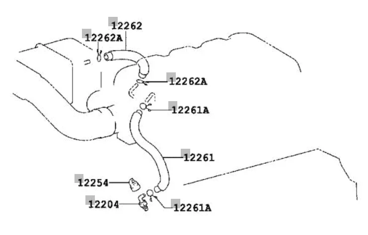

What part are you guys calling the grommet? I bought items 12261A, 12261, 12254, and 12204. 12204 is the actual PCV valve. Is there a matching part inside the valve cover? My PCV valve is stuck hard as hell. I put a 12" adjustable wrench on it today and couldn't get it to budge. I'm worried I'm going to snap it if I keep it up.
The part we are talking about is the rubber grommet on the early 100s. It gets very hard and brittle and pieces can break off during removal.
Try driving the 100 around to warm it up. Should get easier to remove.
What are you calling the "early 100s"? 98-02? My truck is an 03 with a production date of 06/03.
See kit from @NLXTACY (Wits End). If your cruiser uses the pull out rather than twist out (has a nut) PCV, this is what you need.
FLAG: Toyota lists the pull out grommet on build date 1998-mid 2002. Check before you order. The dates below are probably wrong.
That's not consistent with the the searches I do with my VIN on the parts.lexus website.
It should be pretty obvious which one you have if you’ve been under the hood. Compare the pictures.
It is. And it's threaded, with the smaller diameter hose, bigger foam elbow cover. I guess I'll just PB blast the s*** out of it and get a bigger wrench.
