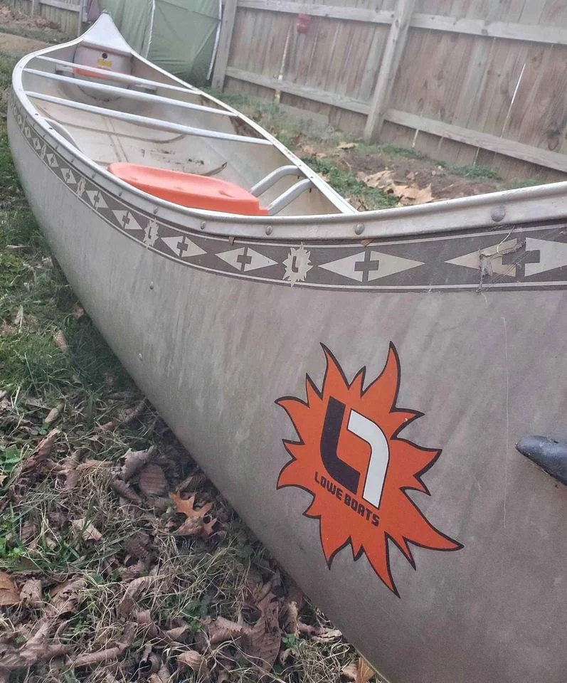

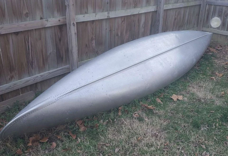

My kids love canoeing. I don't mind it either so I bought a cheap Lowe 17' aluminum this weekend. No dents, damage, missing rivets, just a little bit dirty. Flotation is still good. It's probably a 1980s build.

That looks like a rebranded Grumman. I used to have one...great rugged canoe that kids will have a hard time doing anything but add a few scrapes and minor dents...at least until they get behind the wheel of a car.

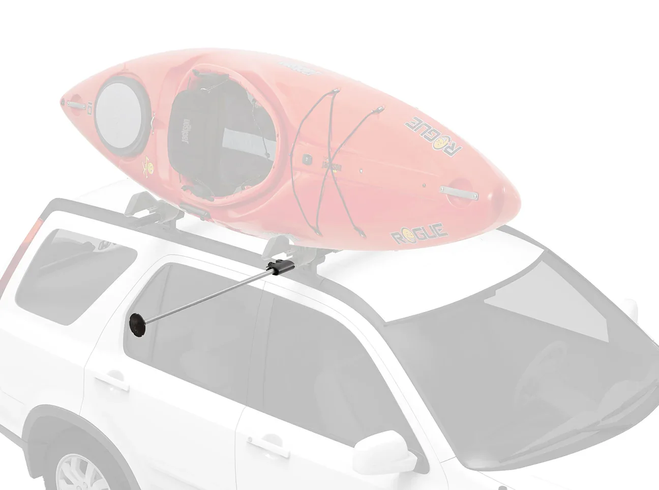

Companies like Yakima make loading bars for putting canoes and large kayaks on roof racks. They can extend from the cross bars (I have this set-up for my current canoe, a 17'9" Old Town Trekker.). You lift one end up onto the extended load bar and then switch ends and push the canoe forward while lifting from the lower end and then sliding the boat across onto the center of the cross bars. It's awkward the first time you do it, but much easier once you learn how.
The other easier option is the receiver hitch T-shaped load bar where you load from the back in a similar manner (the Yakima Long Arm does this when in the 90 degree upright position). Lift the bow onto the rear crossbar, then pick up the stern and shove it forward onto the cross bars. Reese also makes a hitch mount canoe loader. (Reese Towpower | 7018100 | Hitch Mount Canoe Loader - https://www.reesetowpower.com/product/7018100_canoe-loader-trailer-hitch-mount)
A hybrid approach might be to add a receiver hitch to the rear of your Harbor Freight Trailer and use an extender-style load bar such as the Yakima Long Arm to give you another support at the rear so you can slide the canoe back on the trailer body and compensate for the short tongue problem. Yakima LongArm - https://www.rerack.com/yakima-longarm/

Yeah, that's a beast. As mentioned, reminds me of Grumman from scout camp a million years ago. That hunk of aluminum will likely outlast human civilization.

Still manufactured. Now under the Marathon brand.
