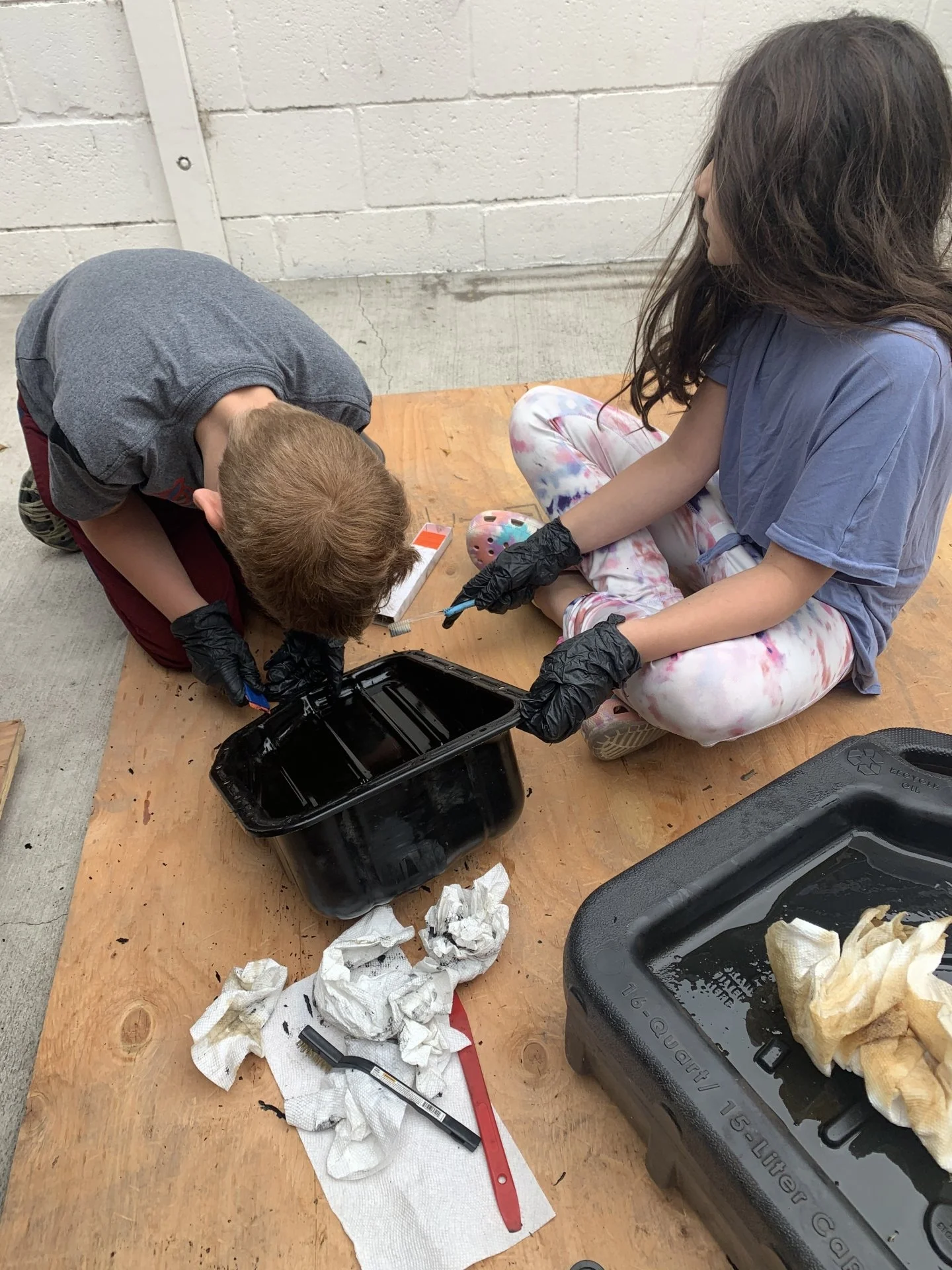

Thanks all for the input. Just got it back into place with Permatex Ultra Black. The kids helped me finish cleaning up the pan.
I torqued it all to 69 in/lbs last time, this time I did 69 in/lbs for the bolts and 78 in/lbs for the two nuts (but first gave it an hour of set time at fingertight as per the Permatex instructions.). Going to let it dry over the weekend and fill Sunday evening. (Have to move the truck by Monday 7am)
