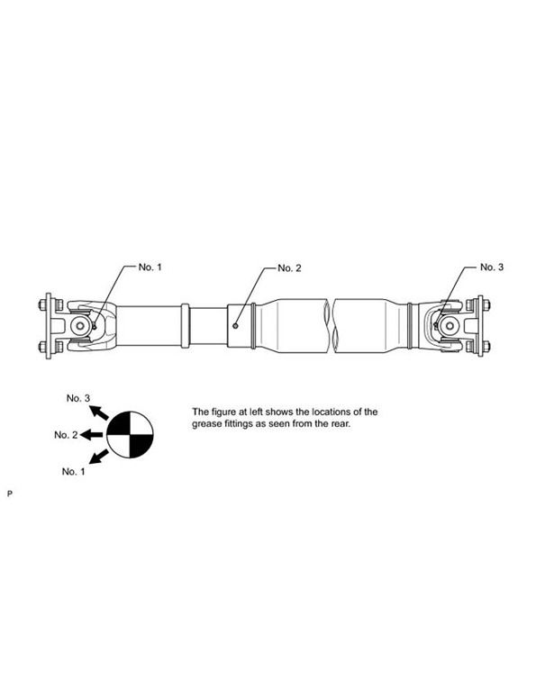

I just had the dealership do it on my 2013 LC a couple of months ago. I do all the other maintenance myself, but didn't want to hassle with rotating the propeller shafts (front and rear) to reach all the fittings - and dig through my "miscellaneous tools" drawer for that weird shaped socket extension that would reach all the bolts to re-torque them.
Dealer said it was easy, did it for free, and gave me a print-out of a 15-point "safety" inspection when the service was done.
Here's what the front looks like:
And here's the rear:
HTH
