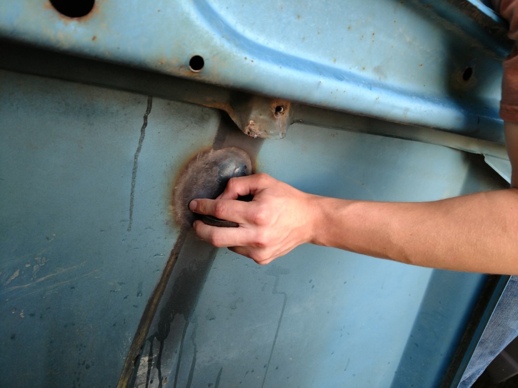

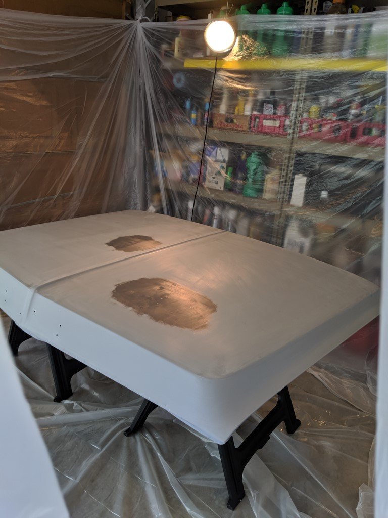

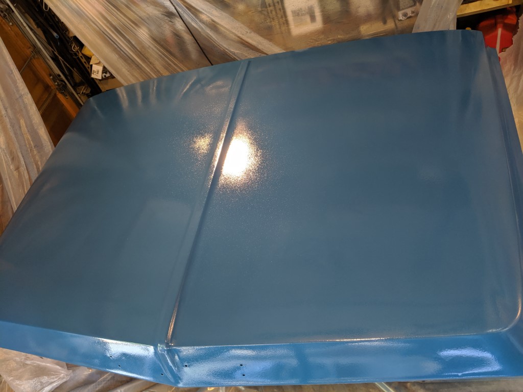

My son had a huge dent in the top of the hood on his 70 GMC, where a tree branch landed on it. (About a 5" diameter end)
He pulled the hood and we discussed the possibility of heat shrinking and working the metal to flatten it back out and clean it up. Mind you, he had NEVER done body work of any sort (he was 19 when he decided to do this) and he researched it on YouTube as well as listened to his Old Man how to approach this. I have not done this personally, but I work with metal all the time and I have seen results of some "Old Timers" doing this.
So, here are a few pics of him using pull pins, hammer and dolly, then heating and cooling, then ultimately sanding, priming, skim coating, and painting the hood on his truck. It's not perfect, but you have to be looking for it to know it's there.
Each time he thought he was done, I asked him if he could still see it. He would reply "Yes". Then I told him that in two years, as he's driving down the road, STARING at that dent while he's driving and asking himself if he felt he did a good enough job to be happy about it. "Good Point" he said, then he went to the next level.
So, not only is what you have repairable, YOU can do it. This was done with a MAPP gas torch, a buzz box welder, a grinder with a soft pad, and a wet rag over and over. For his first time doing this, he has probably 20 hours in this, but it became a challenge for him and was not about the cost of a new hood at all.

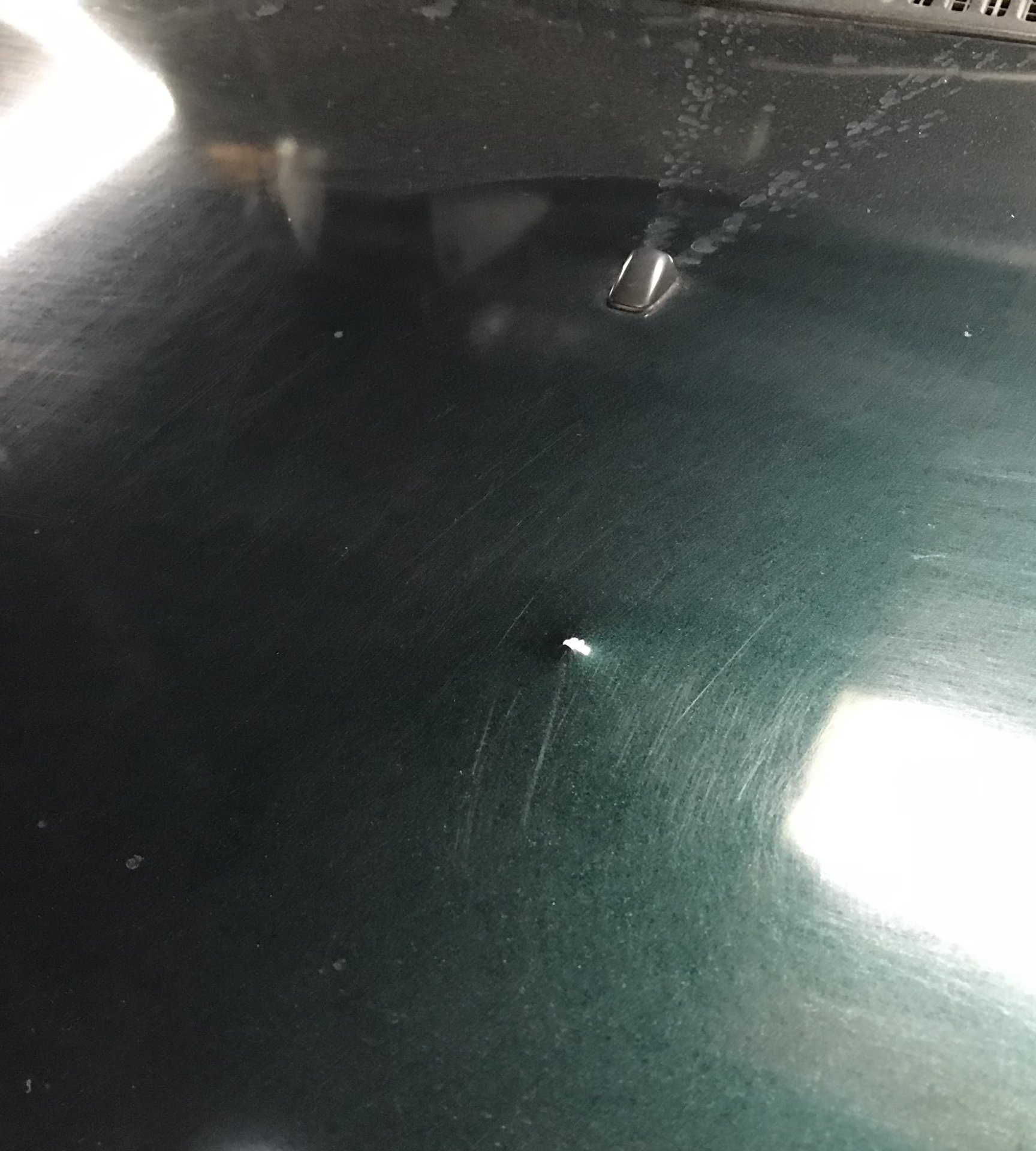

I’m willing to try myself for sure. Removed the insulation last night and was looking around. Looks like a dent from the underside and a big zit from the top!
The hood is rust free and perfect. It’s even been repainted once because the clear coat was terrible about 9 years ago.
Here is what I see from the drivers seat to remind me to put all caps back on and remove all tools from under the hood before shutting it!!:mad:
