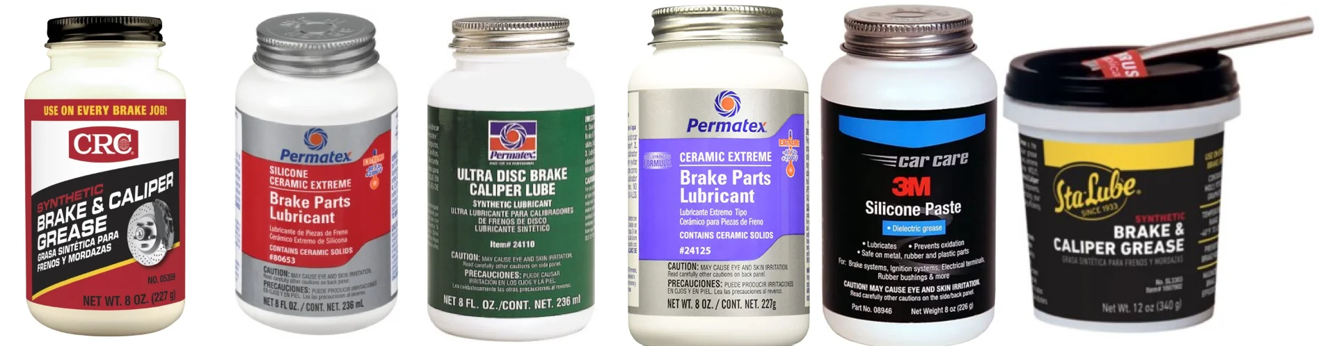

Can I use the Permatex 80078 anti-seize lubricant for the caliper slider pin?
FWIW, I use the high-temp anti-seize for those.
Thanks! I just want to make sure it's not detrimental since I use the Permatex 80078 anti-seize lubricant for all my slide pins. I've seen Permatex 24125 Ceramic Extreme Brake Parts Lubricant on Amazon and the page made it seemed like this is the right one to use instead of the one I have. So I just want to make sure I didn't damage my vehicles by using the Permatex 80078.

High temperature brake grease. It comes in a permatex screw lid container like their antisieze, with the brush in the cap.
Permatex 24110 is the correct product.​

For sliding pins there is caliper grease available at any auto parts store. Caliper grease is not to grease the pistons as some may think. It is for the pins. Hi end calipers like Brembo pistons require a special grease not common at auto stores. The rest of calipers including our trucks rear ones just use break fluid for assembly.
Back to op question, go buy some caliper grease (translucent) . Do not buy molibdem or general brake grease łblack) as that's thick and will make the pins hadr to slide in and out!

TO recap for complete caliper overhaul you need 4 kinds of grease:
Piston assembly grease - special to interact with brake fluid, just use brake fluid if you don't have it
Pin grease - misnamed caliper grease designed for smooth sliding, resisting high Temps, no hardening over time, to work with rubber
Pads sliding grease - commonly known as brake grease, designed to rezist high Temps and resist washing away, being exposed to the elements
Pad grease - also known as quieter grease, it is to be applied on the back of the pads, it is quickly drying to a high viscosity, acting like a vibration dampner
One more use for brake grease is as corrosion protectant inside the piston cups. Some calipers have pistons with the cup opening to the pad. Overtime water makes its way between piston and pad/shim and given enough time will rust the piston. Nothing bad functional but if you're like me hating rust, applying some of this high temp washing resistant grease will keep them like new.

Base on this page, the moly high temp grease is only from -40F to 325F. If we're talking about high temp the Permatex 80078 is from -80°F to 1600°F (-51°C to 871°C).
I can't tell what is in each, but looks like mostly silicone grease, which is good to 500°F. That will probably be enough. I'd go for a non-lithium thickened moly grease, it will be messier but it will stick around. I used a tube of Volkswagen CV grease for years on all my brake pins, it was always still there on the next brake job. Except when my wife drove with the parking brake on and melted the rubber pin covers, but the pins still slid.
If we're strictly talking about high temperature, the Silicone Ceramic Extreme is from -54 to over 3,000 deg. F.
I wonder where they get that temp from, when the carrier is still silicone? Maybe the ceramic in suspension will still lubricate after the silicone is dried up? Honestly, worth a try, see if it is still there when you do the next brake job.
