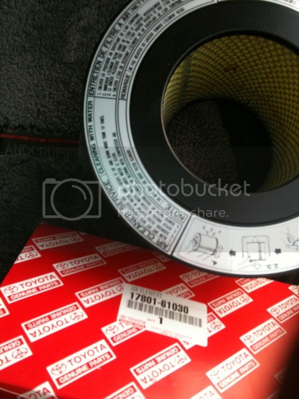

These are great, this is for a hdj-79 not sure if there the same through out all engines
I think they are the same from 40 series to 2006 or whenever the square type came in.
