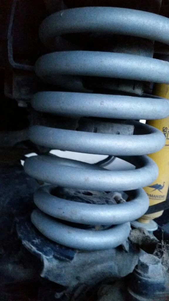

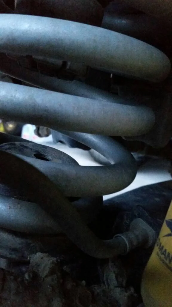

So I braved the cold (Hey it was 60F but felt like 65F because I was warm from riding my bike home from work, but still extremely cold, just sayin') to get some measurements but realize I may have gotten the wrong ones.
Anyway, Slee 4inch heavy springs, dual batteries, Arb bullbar M12000 winch to weight it down, and a 2 inch slee bumpstop spacer.
3 inches from the bottom of the bumpstop to the stop on the axle. Some pictures to follow. Let me know if there are other measurements you would like.
Pics of dirty springs, spacer
Perfect, thanks! It looks like we have the same amount of lift for the most part (if you take the bumpstop spacer out of the equation). Alex's maybe has a little more due to being stripped down.
