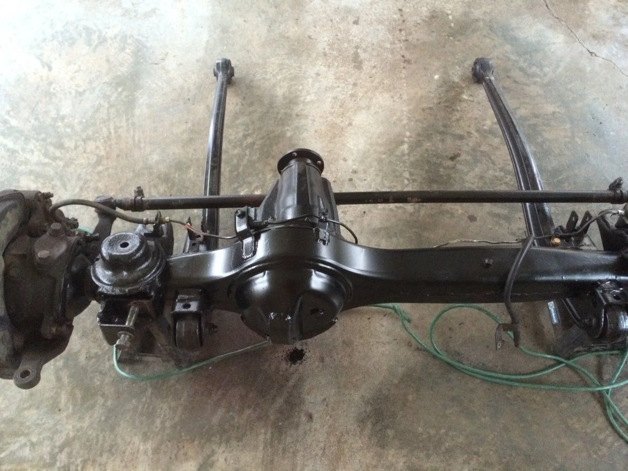

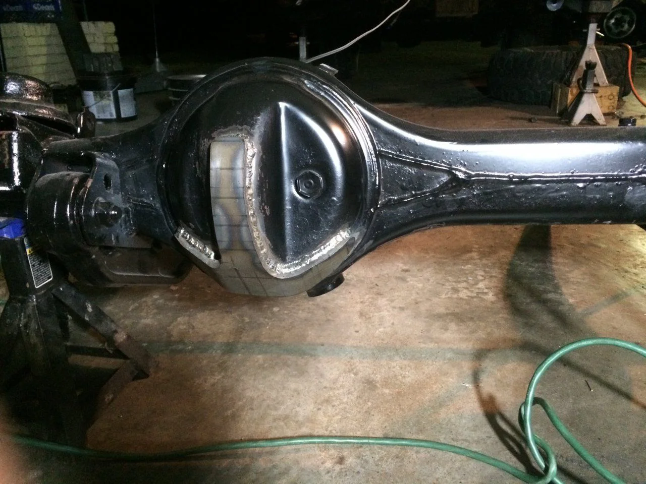

I took @TrickyT 's advice and put some diff protection over the ring gear. I looked at my 60 housing and it had a few dents up front, so this was definitely worthwhile.
The steering box is in for good and all hoses are re-plumbed. We had to sleeve the last hole and patch some swiss cheese in the frame right by the box mount.
I also got the hard brake lines on and ready to tie back to the drop from the frame. I re-used the brake tee fitting from the 60, as well as the mounting bracket that is welded to the housing. I also re-used/re-bent the long hard line from the 60 housing.
Not the prettiest, but it should work.

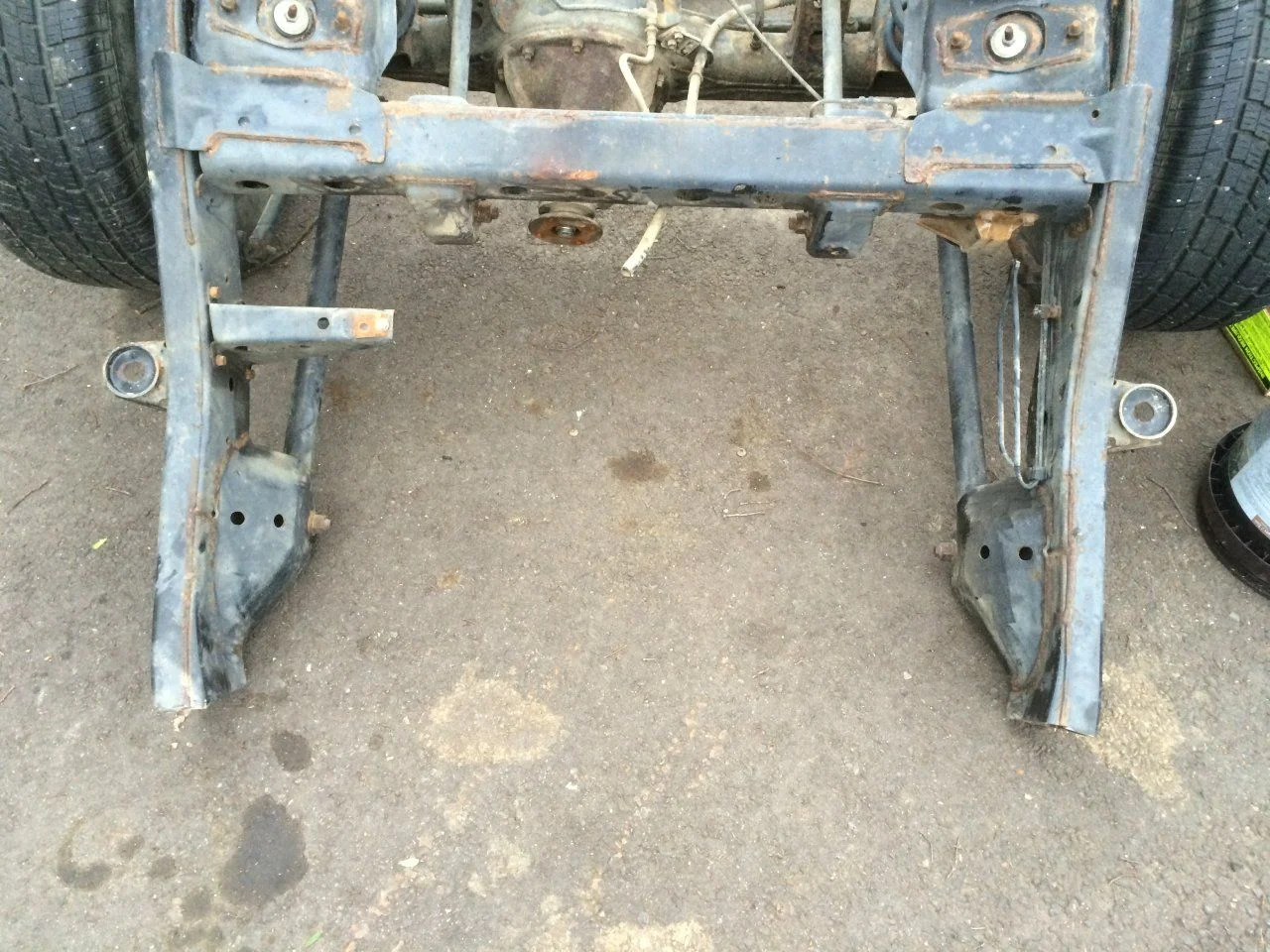

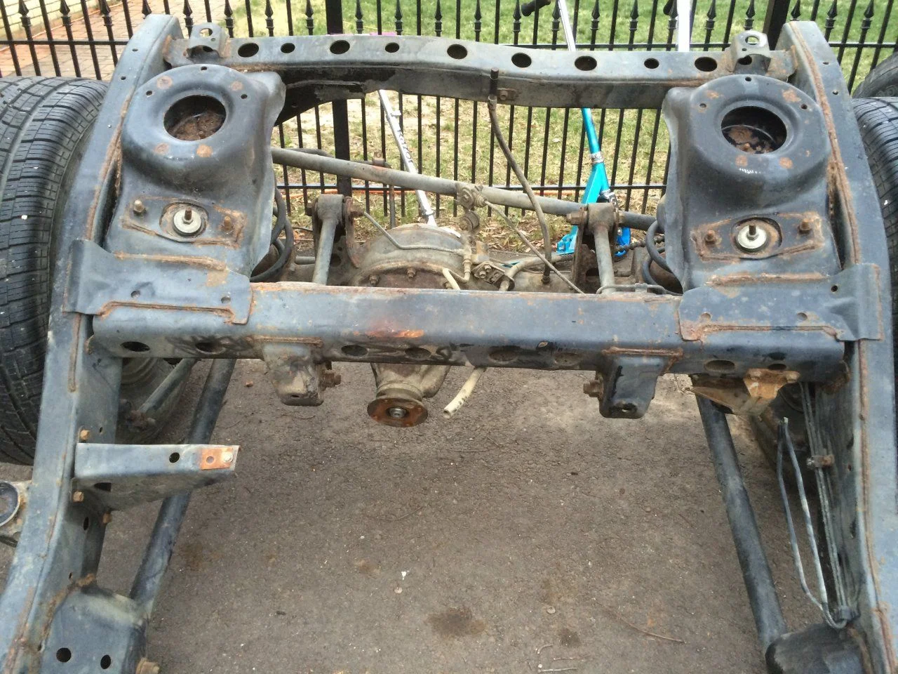

I did crawl under the rear last night to get a better look at things. Unfortunately, I have even less room to work with than I thought, so I will have to come up with a more creative solution than what was in my head. The problem with coils in the back of the 60 is the gas tank. It is right behind the center of the axle, so there is barely room for coil buckets, let alone any additional structure.

Here is my half-cut...
The 60 is roughly 3-4 inches narrower between the frame rails in the rear vs. the 80.
This makes mounting the lower links easy, since the brackets attach directly under the frame.
The buckets will need to move in, as well the lower mounts on the axle by the same amount.
The front structure/upper link mount will get the ends chopped off and welded in the the 60 frame. Shock will mounts stay the same.
The buckets will get the rears chopped/capped to the absolute minimum as in the link above to clear the gas tank...
These will get welded to the frame, just like on the 80 series. I wanted to use a piece of pipe as shown for the rear support, but it doesn't look like I have room. I may just have to tie it between the buckets. We'll see what we can think up.
The panhard mount will be a Ruff Stuff bracket, with the stock panhard bar...

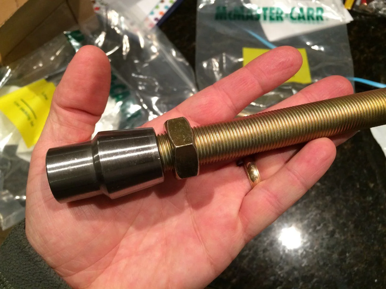

The stock panhard will be shortened using the McMaster Carr adjustable panhard kit... Adjustable Rear Panhard Bar How To
Fuel line, brake line, and exhaust routing will also need to be tweaked.

Unlike the front, I won't have to cut everything out of the way to play with it, so I won't have to part it out if it doesn't work. But it will work. Somehow. The tank can't be moved. There isn't any room to move it.
Like the rain and the cold weather, this is just something we'll have to deal with.
The front buckets don't have much holding them to the frame, and they don't seem to rip off too often. I may tie the back of the bucket to the frame similar to the fronts. I will have full support on the side and front of the bucket, so it may not need a full rear crossmember. We'll see when we get in there.
