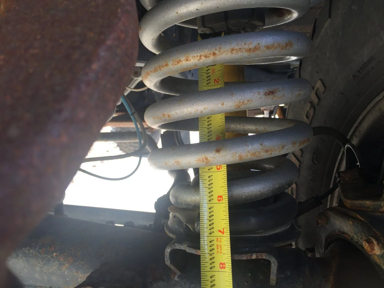

Mine is naked now prepped for a repaint job so it's sitting like a treehouse. I don't think you want me to measure now do you? I can get those measurements if you want a fully unweighted slee 4 inch lift measurement?
I'll get measurements today, I promise. Maybe, depending on how cold and dark it is when I get home!

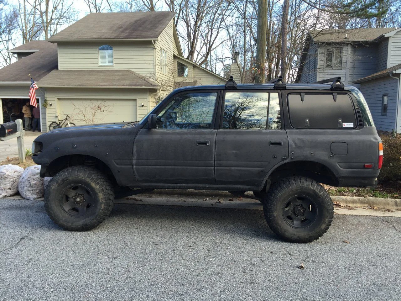

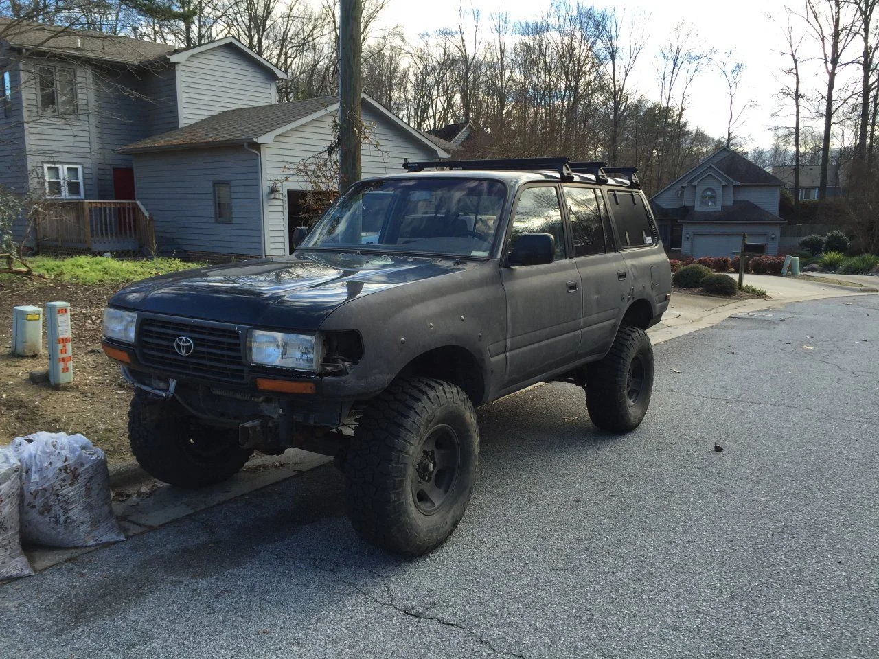

If I can get the rear to match the front, I think it'll be a good height.
It does look huge in the front, but if you step back, it looks tight. Perfect for the 80 width.
(Pic is deceiving, it is not as level as it looks)

Let me know if you want measurements this evening?
Measurements would be good, just for my curiosity more than anything.
Height does look good.

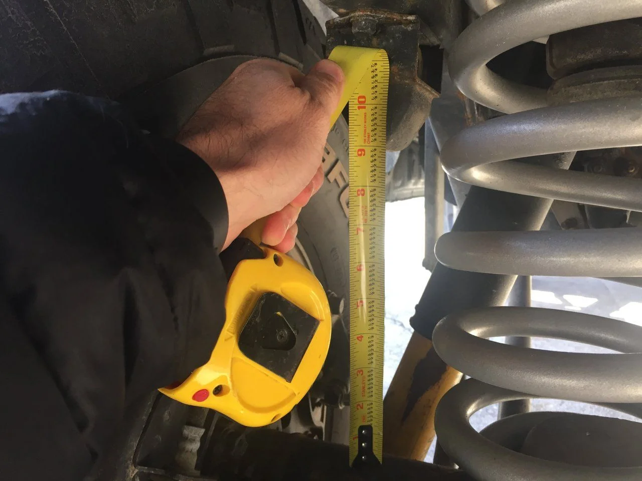

Cam, just went out in my business clothes and tried to take some measurements... didn't do to good so i'll get dirty later if you need. Here is what i was able to get. rear and front.
Perfect. It looks like I'm pretty close to yours in the front as they both sit right now. Thanks!
