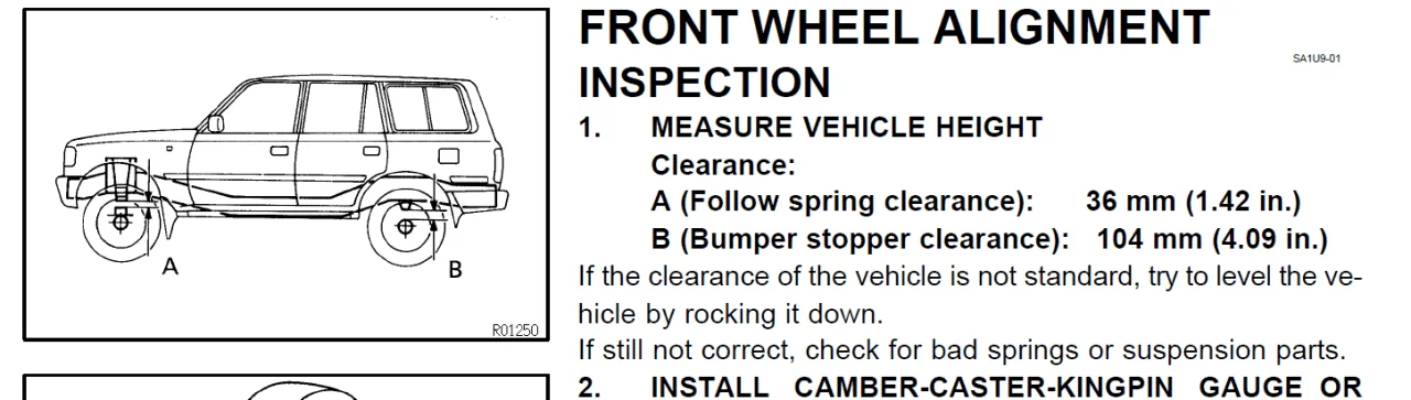

Comparing mine to Mark's 80 - mine sits 1-1/2" taller measuring the bump stop to lower coil mount. He has Ironman heavies + a 1" spacer. In theory they should be pretty close. I can't imagine the Vortec is that much lighter.

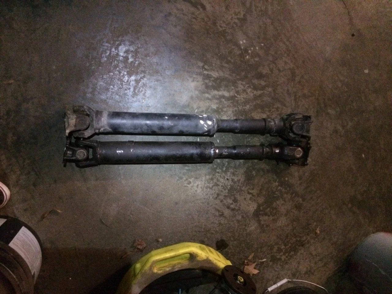

Check out the stock 80 vs. my cut down 62... identical lengths!
Sure enough, the @bhmmapping method worked like a champ and I made a hybrid out of the two.

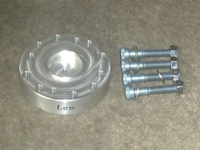

The driveshaft is now stretched out another inch or so at ride height. I'll post a pic later on to see what the concensus is on whether or not I can run it as-is. If I need to lengthen it, these driveshaft spacers are the cheapest & easiest solution...

Physical progress is in a holding pattern for a few days, but I did play with the driveshafts.
Not that it's relevant to what you're doing but one of the FJ62 driveshafts is a perfect replacement for the rear shaft in an 80. I can't recall if it's the front or rear from the FJ62 that matches up but I'm running one in our 80.
Good info! I have the rear from the 80 and it might be close to mine, which has been shortened to be close to a 62 rear shaft.
It might at least make a free trail spare if nothing else.
