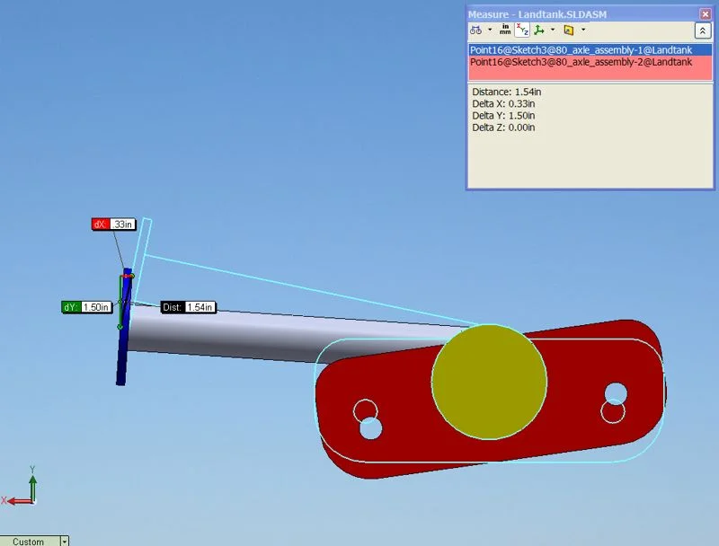

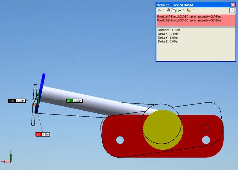

I went and read the caster thread. It does move the face of the pinion back .49", Landtank's - .33".
Pics below, courtesy of Christo.
Slee's plates, everything rotates on one of the bolt holes...
Landtank's, which rotate around the axle's center...
I like that pinion angle better than what I have now (mine looks like these pics) - should be able to run 80 in 4wd. Slee's are easier to install and cheaper.

As far as the castor goes, it will be interesting to see what the number really is as his control arms are probably mounted lower in relation to the axle than the 80 series (almost like MAF drop brackets). We need to measure the angle and compare with mine next time I am over there.
That's cool...I was wondering about the possible differences in frame mount location last night when thinking about the caster. Interested to hear how they compare.
Cool Slee CAD work - just keep in mind these are likely nominal parts; don't get interesting until tol stack ups and nonlinear deflection analysis comes into play. Christo probably has a seat of ANSYS hidden away in the back office and is just keeping it on the down low.

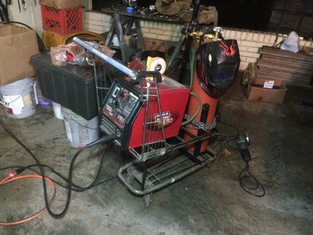

Like the Super D welding shopping cart?:hillbilly: Without a doubt the finest custom vehicle we have turned out to date.
