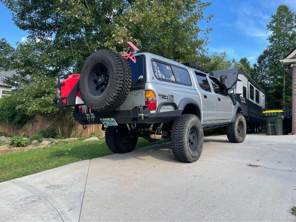

I'm looking to buy a fully built out Tacoma with 250k. Am I stupid for buying a vehicle with that many miles? and am I overpaying? This would be my first overlander--I'm just trying to get into it.

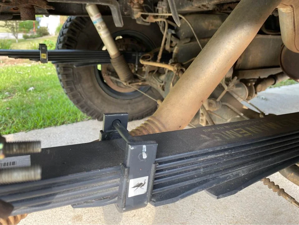

  • New leaf springs with bushings Bilstein 5100s in the rear Bilstein 6112s in the front with

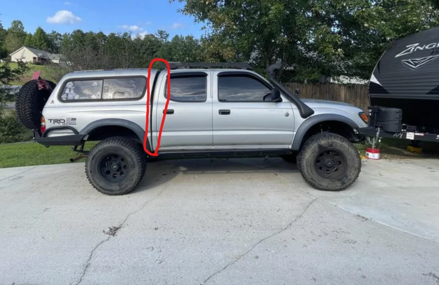

I'd take a look at the frame condition closely. It looks like the body/bed line is a little out of whack, narrowing at the base.... but maybe that's just exaggerated by the camper shell.

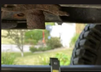

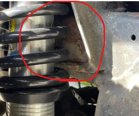

Either way I do see some signs that would bring about concern...Spare tire carrier appears to be pretty well rusted...and behind the coilover in the bucket...

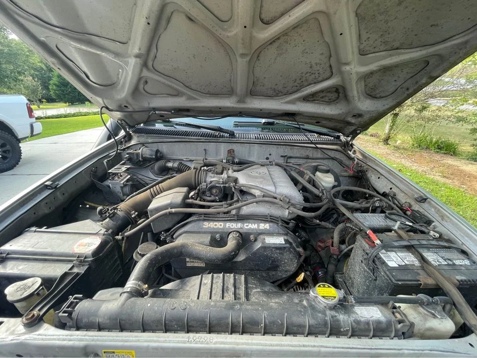

It all boils down to what you want and what the market is like in your area. I'd say for a nice one that needs minimal work...that would be close to max pricing, but likely worth it if that's what YOU want. Either way I'd plan on replacing the valve cover gaskets and timing belt/idlers/tensioner/water pump if it has not been done with OEM parts recently. Good luck!
