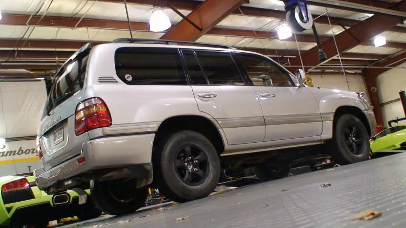

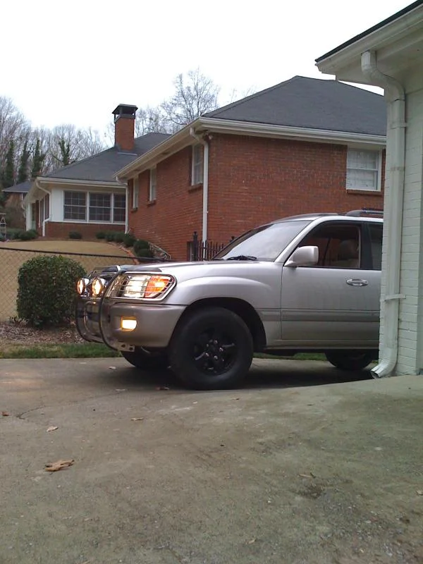

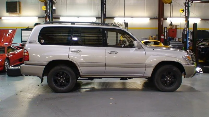

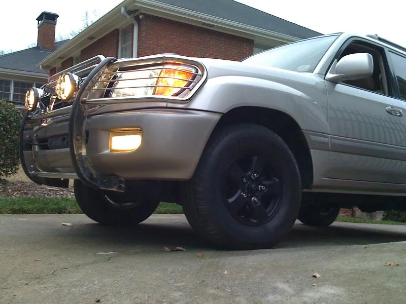

1: this morning...
2: later today when I finished.
3: ehh same shot, just different angle.
not bad but your priorities need to be straightened out. That damn chrome manik bar needs to be painted like yesterday! :D

Write up after dinner, here are some shots from earlier (an hour or so) of my truck.hope ya like them

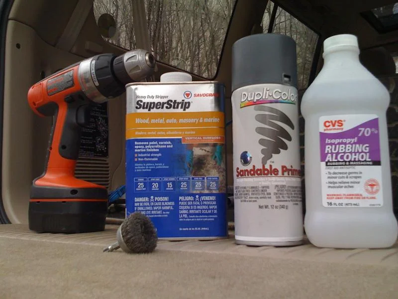

Here is the write up guys.
Supplies are in first picture.

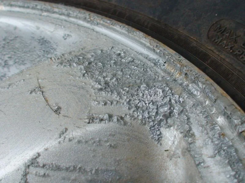

I did a 2 stage strip. I thought about just using acetone. but what if it doesnt strip 100% of the paint off and leaves little specs of paint and dirt still in the groves and scratches??? so i got some paint on stripper, it literally LIFTS the stuff out, even makes your nose bleed.
Stripper at work is the 2nd picture. works like a charm.

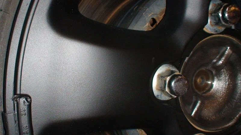

Sanding: using a med. wire brush on a drill (not cordless, mine died every 10minutes :mad: ) then going to 100 grit sand paper (non-clog), then pressure wash the rim off. inspect and see where your attention needs to be. move up to 320 grit sandpaper (non-clog also) and sand the WHOLE rim. go over a few times. wash again. dry.
Last step for primer prep: most think the rim is "clean", but dont let your eyes fool you. take a WHITE shirt, and put some water on it. rub the rim with alot of pressure...... black/grey stuff on the rag ehh? take rubbing alchohol or grease penetrating soap/stuff and wash the rim. then ya do the "clean test", if you prime over the dirty/grease, it wont bond to the rim, itll be more of a mold... therfor chipping, peeling, lifting, bubbling. whatever you wanna call it..

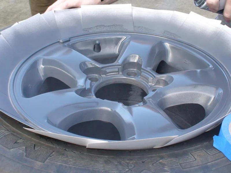

Priming: I sprayed 2 coats. the first one I dry sanded. then second I sprayed over for the smooth surface.

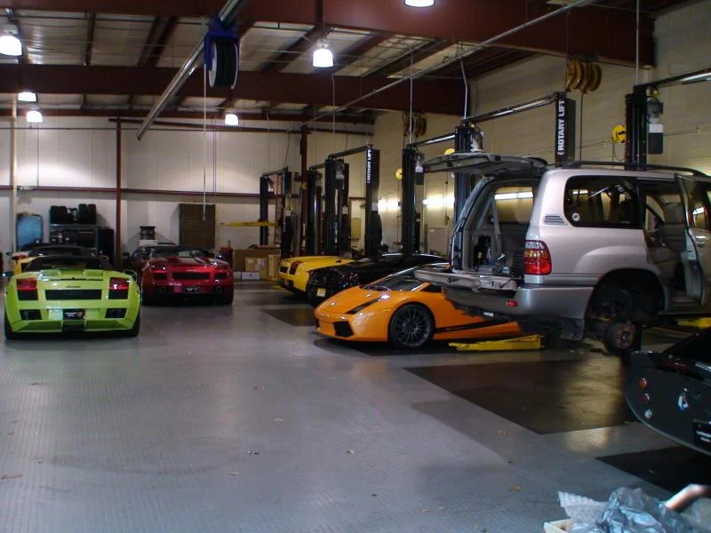

Looks good. The Lambo's in the background aren't bad either! :cool:

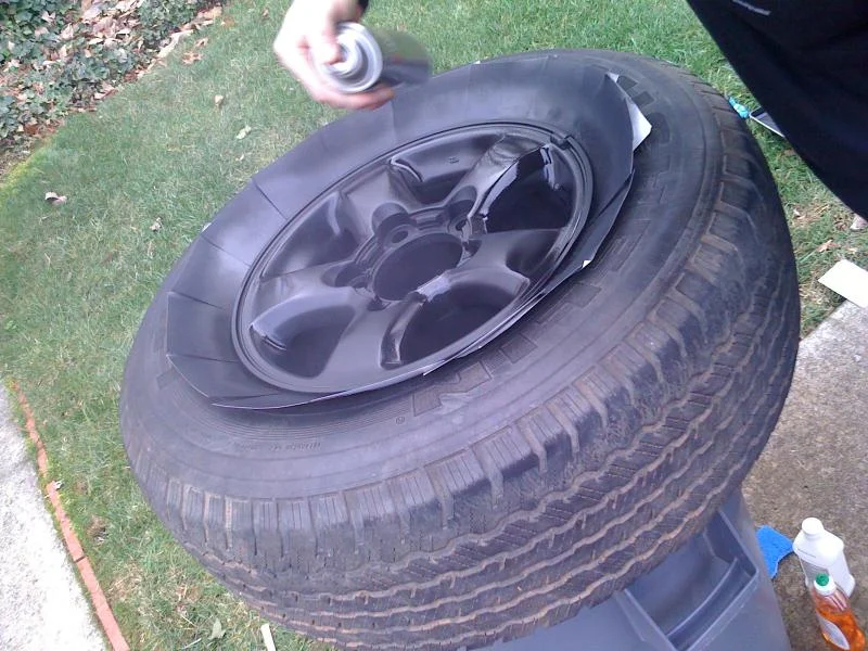

alright, normally now....
painting:
Rustoleum High Enamel Matte black
Looks great, goes on glossy, and dries matte (im sure thats same for all spray cans)

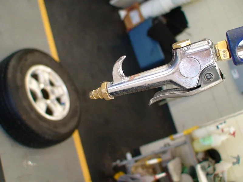

after prepping. i used a air compressor to blow the rim free of dust/dirt, or anything that might be laying on the primer (please make sure the primer is dry, you might make a mess if its not)
