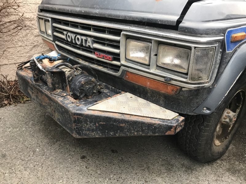

Not pretty but may give you some ideas...
I finally got round to do it and cut this front porch a bit shorter, rather pleased with the result for now.
I might alter the height of the side bumpers sometime. Deliberately I bolted them in place to be able to alter them at a later stage.
Just posting some pics from the now. Have made several from the building process and will post them later.
Hope that these give others some ideas - would love to see other similar projects too.
Here are more pics from the manufacturing. I had some sort of design in my head, then started to build things out of cardboard....got steel and luckely the neighbours plasmacutter. More pics in next post...
I have to mention that I fitted a better condition worm gear into the winch. I had annother winch lying around for a while which had less corrosion inside. I only figured out later that that winch must have been from a 70 series as they sport a opposite direction of rotation. I sort of proved handy for the new setup.
Quite pleased with the result .... had it in my mind ... basicly since I got the truck which is 5 years ago.
