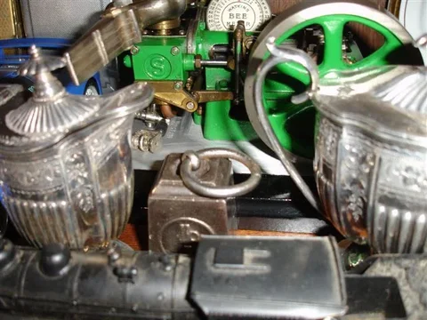

Who am I to judge? Well I'll have you know that I'm been collecting well-made metal stuff for decades. Here's a small sample to prove it :lol::
(I felt I had to rummage around for some qualifying evidence because most people know that my metal-working skills are on a very basic level.)
