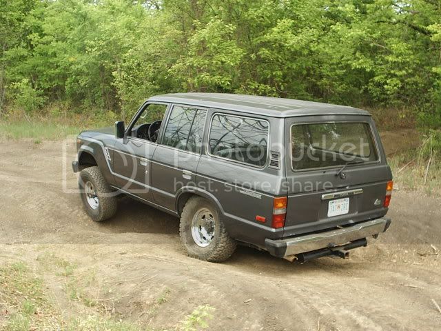

The tires are TSL Radial 33x12.5
As for the Hoop questions; By giving the shock mounting points further distance betwe
en them, you can fit a much longer shock and still have enough compression travel without bottoming the shock. The longer shock enables the axle to travel down further without running out of shock. I was only able to get 22" top/bottom with the old setup fulled drooped. It streched to 30" top/bottom with the new setup and the shock still has another 4" of shaft left. I'm working on some other mod ideas to get max flex from this setup.

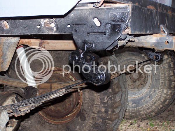

You can get some more flex out of the rear by using a double shackle. I don't know if a second stock Toy shackle is narrower at the top, than the bottom. If it is, you can bolt the two shackles together. Then put a piece of square stock on the lower one to keep them from completely collapsing on one another.
Here is a pic
I wouldn't use this set-up for the front. In the rear it gives alot more droop, but doesnt open on steep hill decents.
