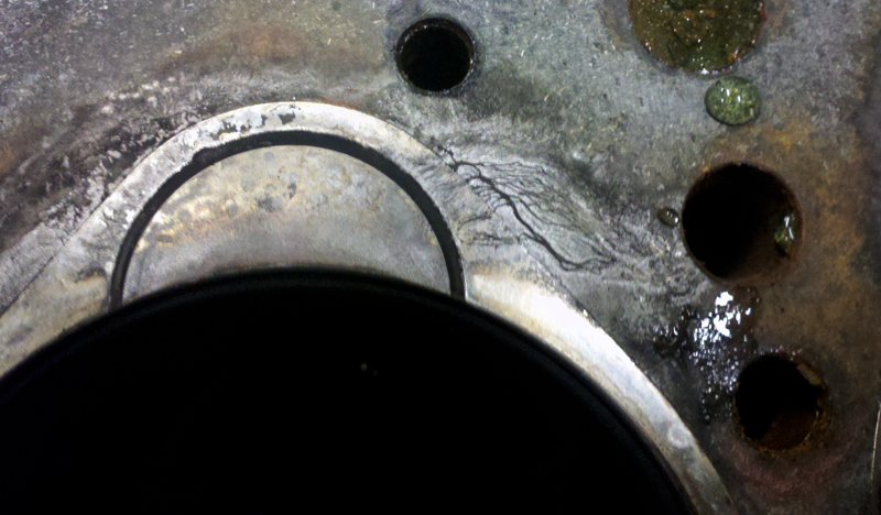

It's turning out that the H might not be the best platform for a turbo. I'm replacing the headgasket again.
This is what an intermittent head gasket failure looks like
I had a custom copper gasket made by the folks at Cometic. I went with .063" thickness which is about .008" thicker than the gasket I had on the engine. Hopefully it lowers the compression ratio slightly. I could calculate the decrease but I don't have my FSM handy at the moment.
I searched for replacement head bolts. The stockers are M13x1.5. ARP and others don't do M13 head bolts or studs. Bummer.
At least this time I do have an M13 tap to chase the threads. I'm surprised how much gunk came out of some of the holes. Third time is a charm. (And less stupid than the previous two times that I didn't chase the threads.)
Don't know if it's the gasket. I haven't taken it apart. At this point I don't care. I'm sick of diagnosing cooling troubles with this engine. The problem is the worst it's ever been. No bubbles at idle but it will blow a half gallon of coolant out the radiator cap in a half-mile of driving. It's bad enough that I no longer feel like fixing it.

The dirty old H motor cracks heads often enough without a turbo. You've persevered more than I would've.
I think it's a cracked block. The head was checked for cracks when I had it resurfaced before installing the copper head gasket.
Hmm.... I dunno man, seems like a tall order to get a crack like that on a sleeved engine. The sleeves are probably uncrackable so its hard to imagine how that'd work.
Bummer.
Its a cracked head , only way to really look for cracks in magnuflux , where u look visualt look for cracks with ultra violet with a magnatizer or spray that most engine places do , they cant trace internal cracks ,etc . In-direct or precumbustion hesd designs are renown for crackd heads , how much are new heads? Tho i heard 3b handle it better .
What are ur symtoms besides overheating ?
