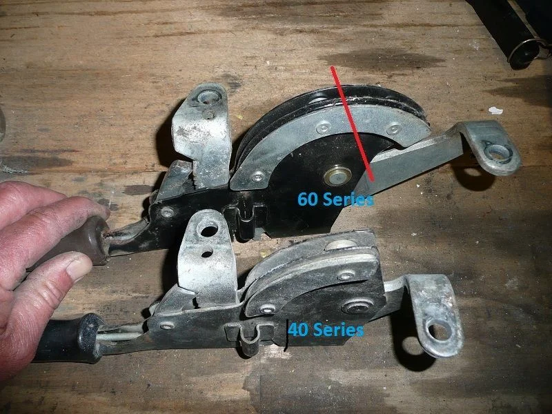

I was thinking of the same idea a few days ago. I was in need of a park brake lever for a hj47,so pulled the lever from a 60 for comparison, while not a direct fit for post 79 40 series Cruisers as the mounting bolt spacing are wider, I can't see why the 60 lever couldn't be made to fit a pre 79 Cruiser.
I can post some comparison pics if you like?

Mock up of the 60 series lever on a pre 79 floor hump.
If using the standard split case cable I believe the portion indicated by the red line on the 60 lever mechanism would need to be removed.
Thanks for the input and photos. I think the easiest thing for me to do would be to source a used lever assembly from the appropriate model year FJ40. The '71 already has a later FJ40 transmission hump - I replaced the original when I installed the 4-speed and transfer case from a '78 FJ55. The drum parking brake split case came from a mid-'80s BJ45, so I don't know how or if that complicates things. I'll take a look at the online parts diagrams and other Land Cruiser references I've accumulated over the years. Next best option, and fairly straightforward, would be to use/modify as necessary the spare FJ62 lever I already have.
