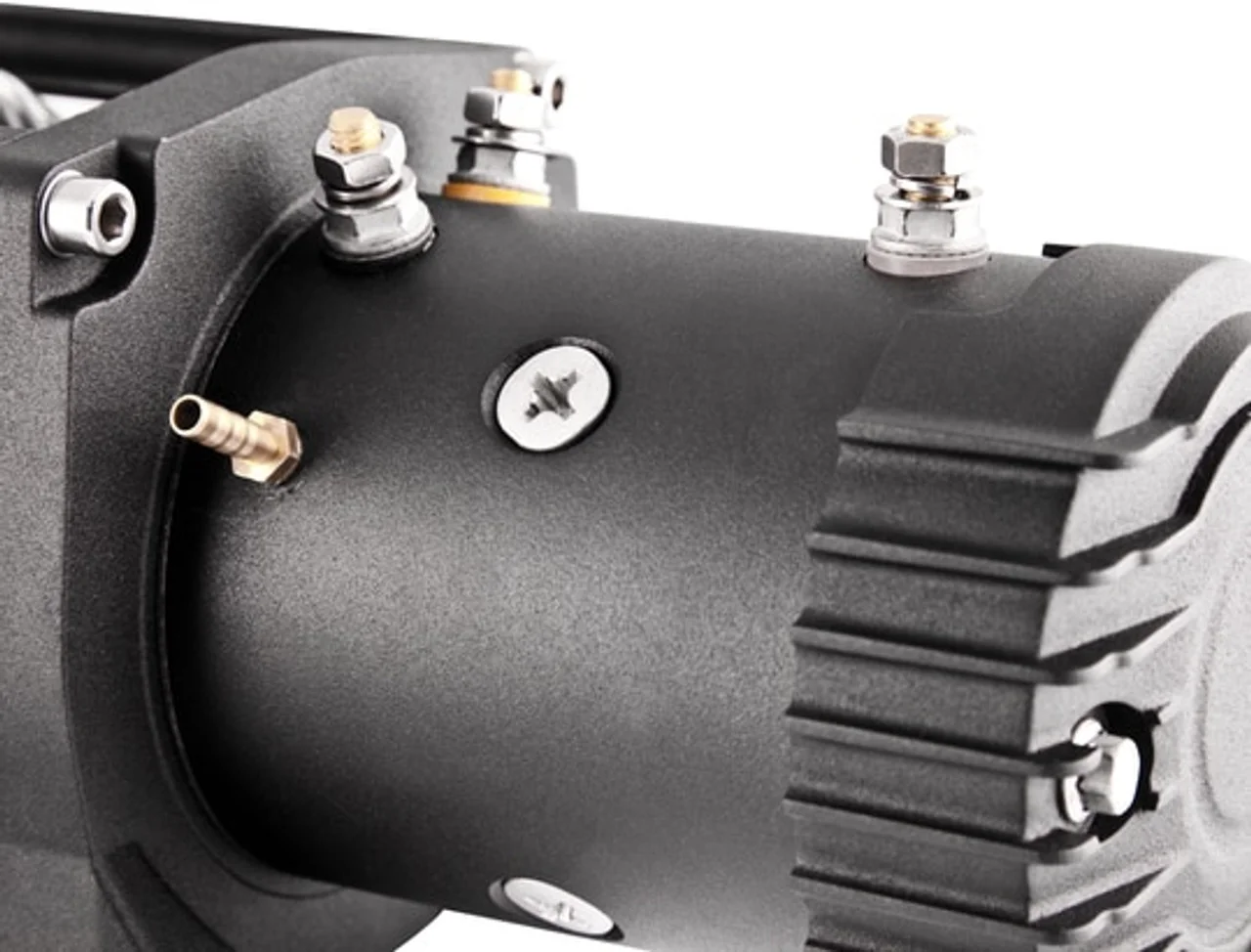

How the terminals look like:

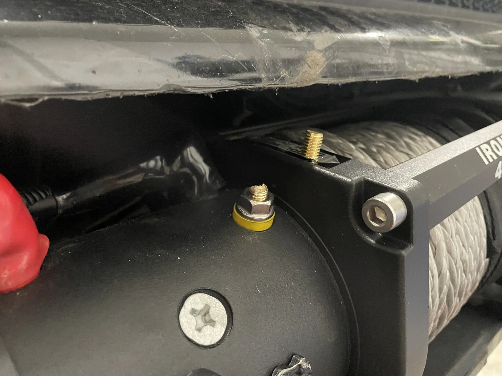

The broken terminal:

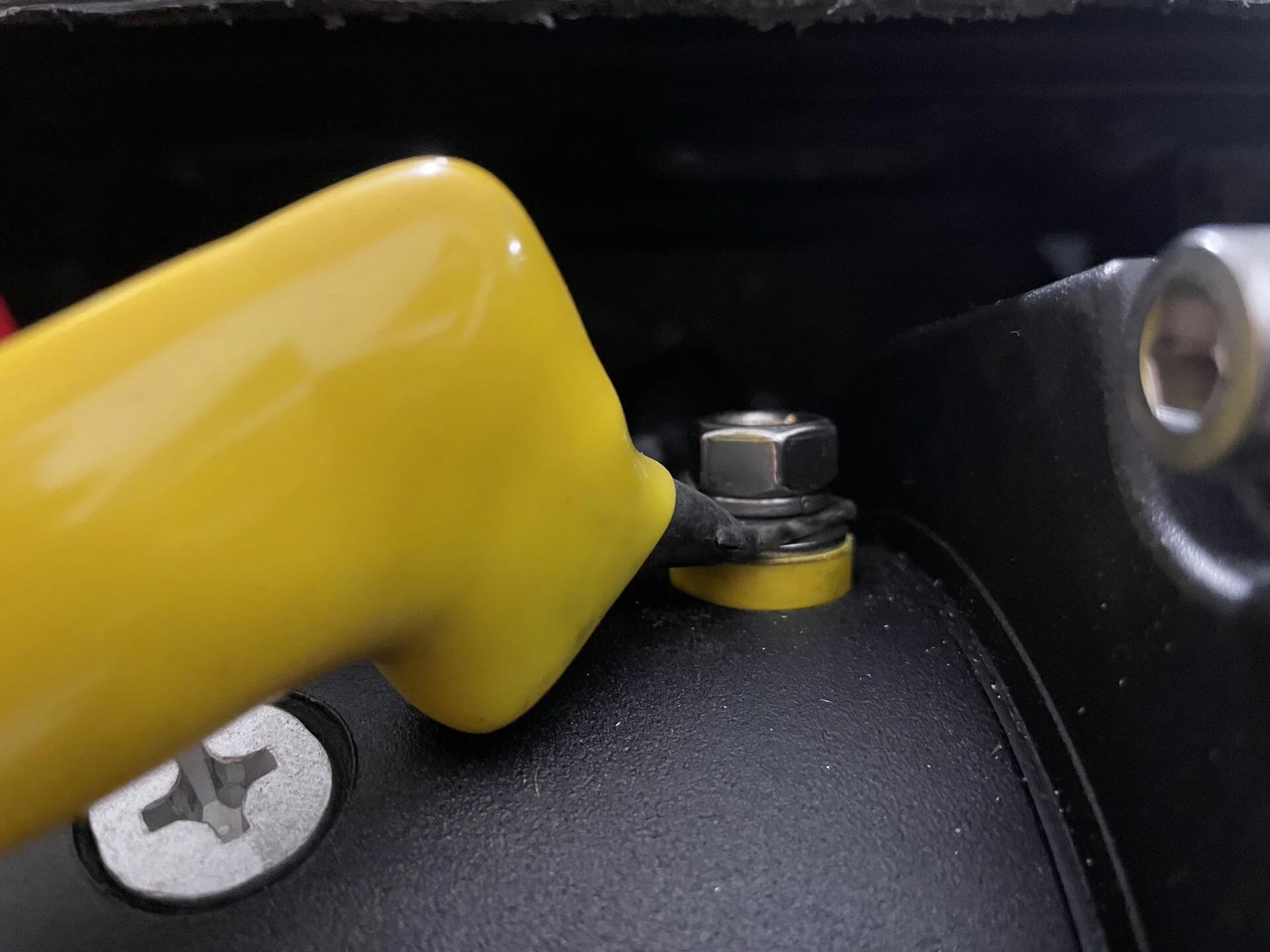

Removed the nut at the base of the terminal, put a washer instead and attached the cable:

take it apart and replace the stud. hit your local starter rebuilder
While I think it would probably work, I'd still replace it. There's a reason the manufacturers put 2 nuts on the stud, it compresses the wire terminal between the two nuts. With your current setup, you're relying on compressing the wire terminal against that insulator which it probably wasn't designed to do.
I assume any electric motor repair shop would have something that would work. It's probably a hex head or square head bolt.
Thanks for the response, @ducktapeguy!
I was worried about what you mentioned, so I got 2 thinner nuts (4mm) was able to have the terminal sit between them.
