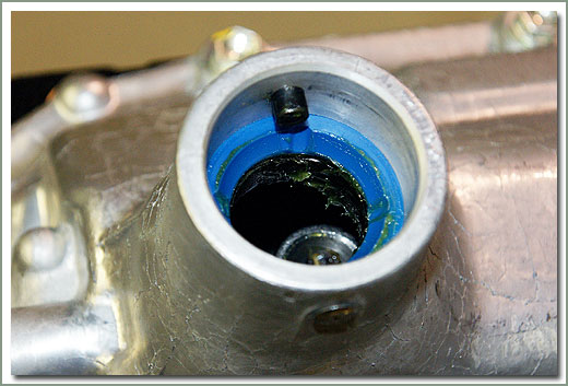

@Malahki ,First check the bushing under the shift lever. When they wear, the the shifter sticks. Simple low dollar check.
@beno will know what part number that is. You can pop it out and change it with your fingers
I support this suggestion.
The seat is probably 33505-60020 which is a non-US part unfortunately.
It includes the blue seat as well as a black spacer below it.
What I would do is get 33505-60011 (which is available from Toyota here) from American Toyota on Alameda and I-25 -- talk to any of the front counter guys and tell them I sent you.
You can take the old one out, separate the upper portion (blue) from the lower portion (black). Then get the new 33505-60011 glue them together and reinstall. Would probably work in a pinch until you could get the new, correct part. I don't have any in stock right now though have a few on the way from backorder.
