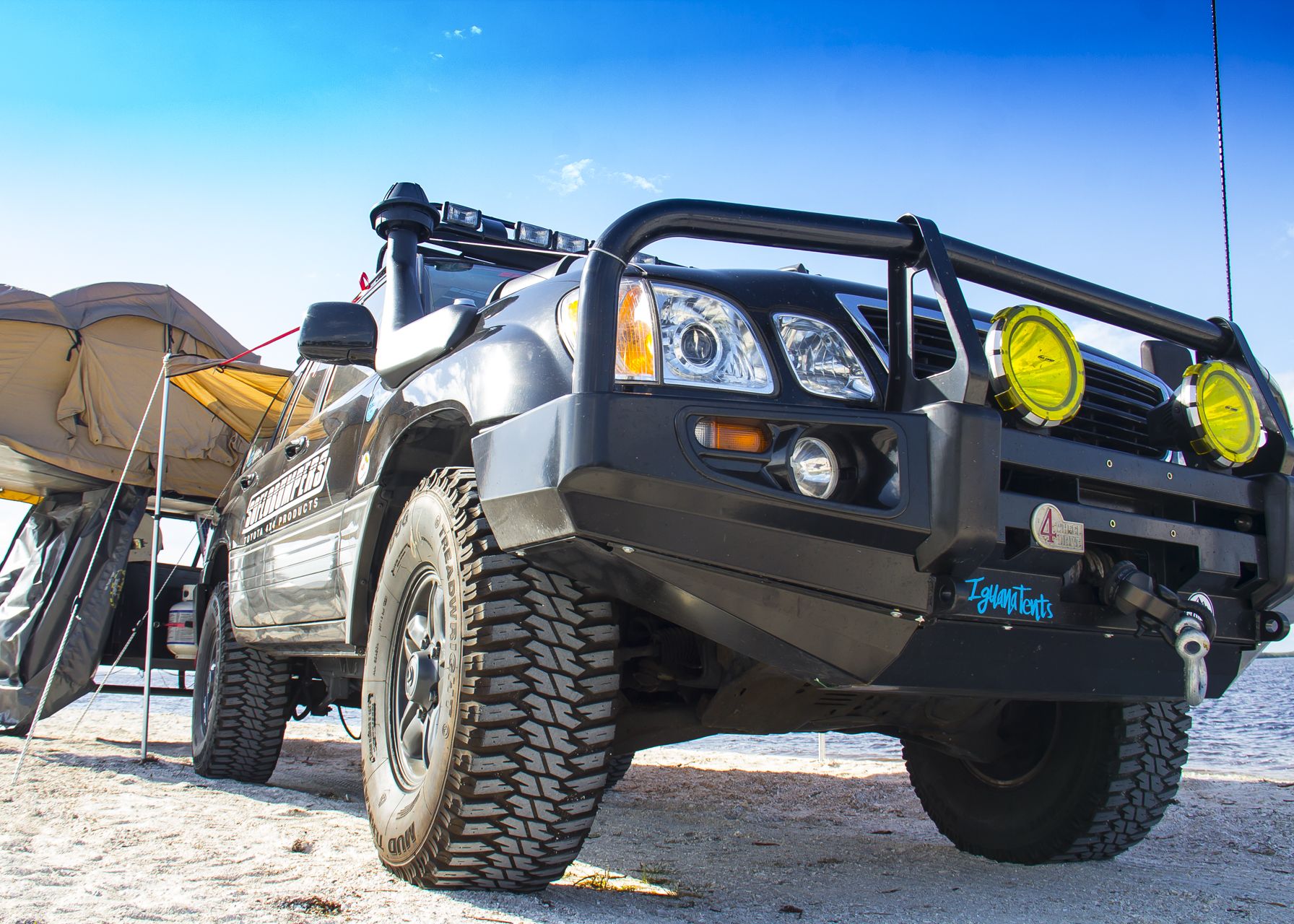

I flew down to Florida to visit my friend for New Years 2018, picked her up and drove her home to Texas. What a trip. Picked up the truck, and it had the christmas tree brake lights of death. I HAD to make it back with the truck so I hit the road, driving cautiously as I could, and tiring out my legs whenever I needed to stop. About 4 hours in, the adventure began. At about 69mph, the front left tire catastrophically failed, almost sending me into a car passing me. Managed to get it slowed and pulled over to get the tire changed. Dude was running some crappy chinese 315 33s if I remember right, and he had like a 270 31 on the spare tire swingout. Sweet. Made the swap and limped it to my friends house another 4 hours in the dark. Next morning I replaced all those terrible tires with 285/75/16 KO2s including the spare obviously. Got it all the way back to Texas the next day with no issues. What a start though. haha
Took it to the shop to get the brakes fixed since I was TDY and all my tools were in MS. Homeboy wanted $5k PLUS labor to fix it, I asked if he'd install a part I gave him, but of course it had to be a part they bought. So I took the truck back, parked it in the culdesac, and got on ebay. Bought a picked unit with the same warranty as a new factory one (1 year) and a rebuild kit. Ran over to the hardware store, bought a whole new set of tools and got to work. It was a major PITA, but got it swapped out and got the brakes bled. Took it to a different shop and had them triple check my work when they did the registration inspection on it, got the thumbs up!
By this time I'd started noticing some stuff about the truck as I got more familiar with it. It was a 20ft truck. From 20ft, it looked sick. But up close, it was completely hobbled together and just about looks. I had a lot of work to do. Some examples:
-CB antenna and radio, but no wire connecting them
-a winch that was installed, but didn't have the right leads to power up and was broken (and not even mounted properly)
-the bumper was mounted so poorly you couldn't open the hood
-the side awning poles were all broken and unusable
-the mirror is on the wrong side, cause it's a LHD car
-had a jankily mounted ARB compressor in the cargo area that didn't work
-ML speaker foam had died years ago
