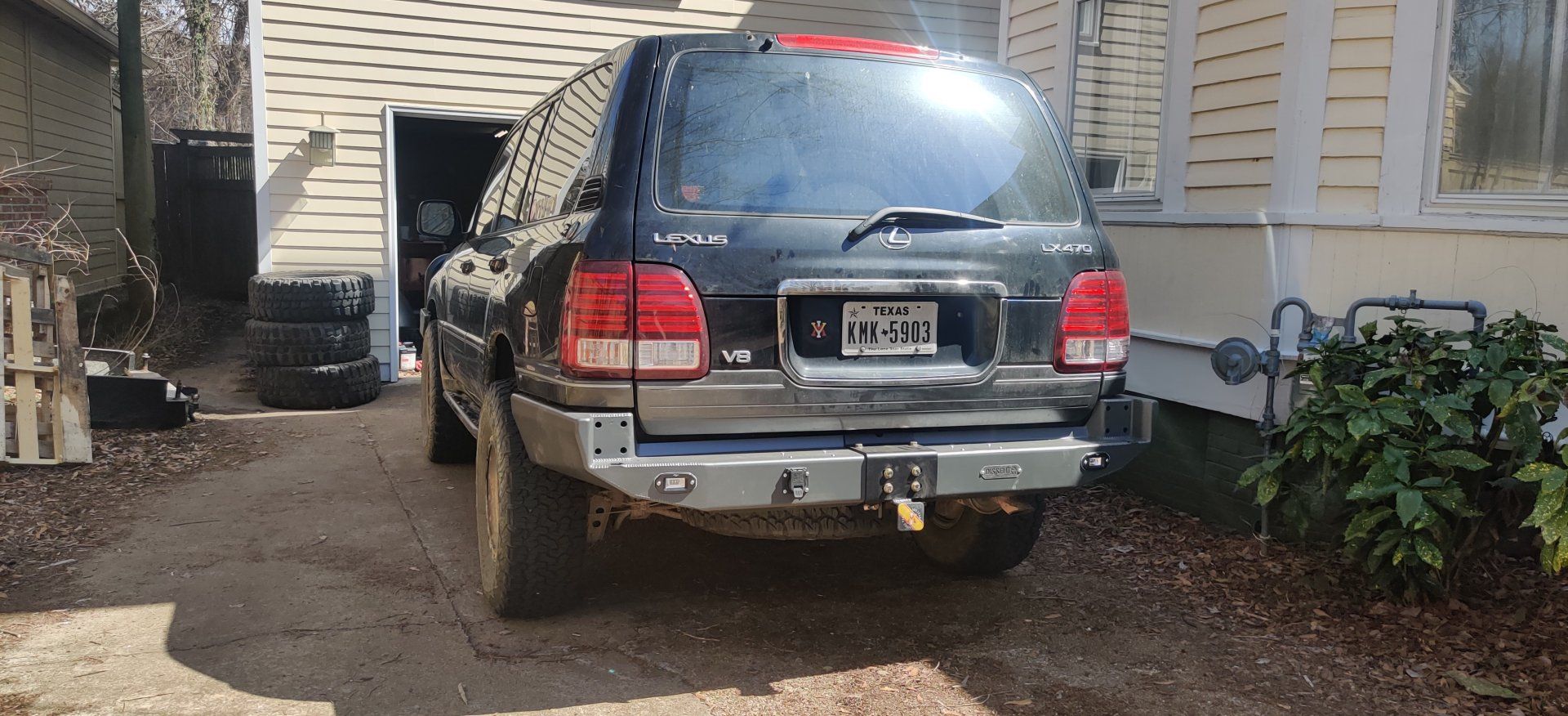

Finally got the Dissent rear bumper and skids on. Looks like a different truck now. Ben does some great work. Struggled with some broken off bolts/clogged holes but we got it on there. As far as the skids, I found that the middle plate front hook needed to be cut down a bit to fit around the crossmember, and my chinese knockoff Ironman bumper required me to cutoff the excess aluminum outside the side holes on the front skid. Thing is solid, should provide some much needed protection.
