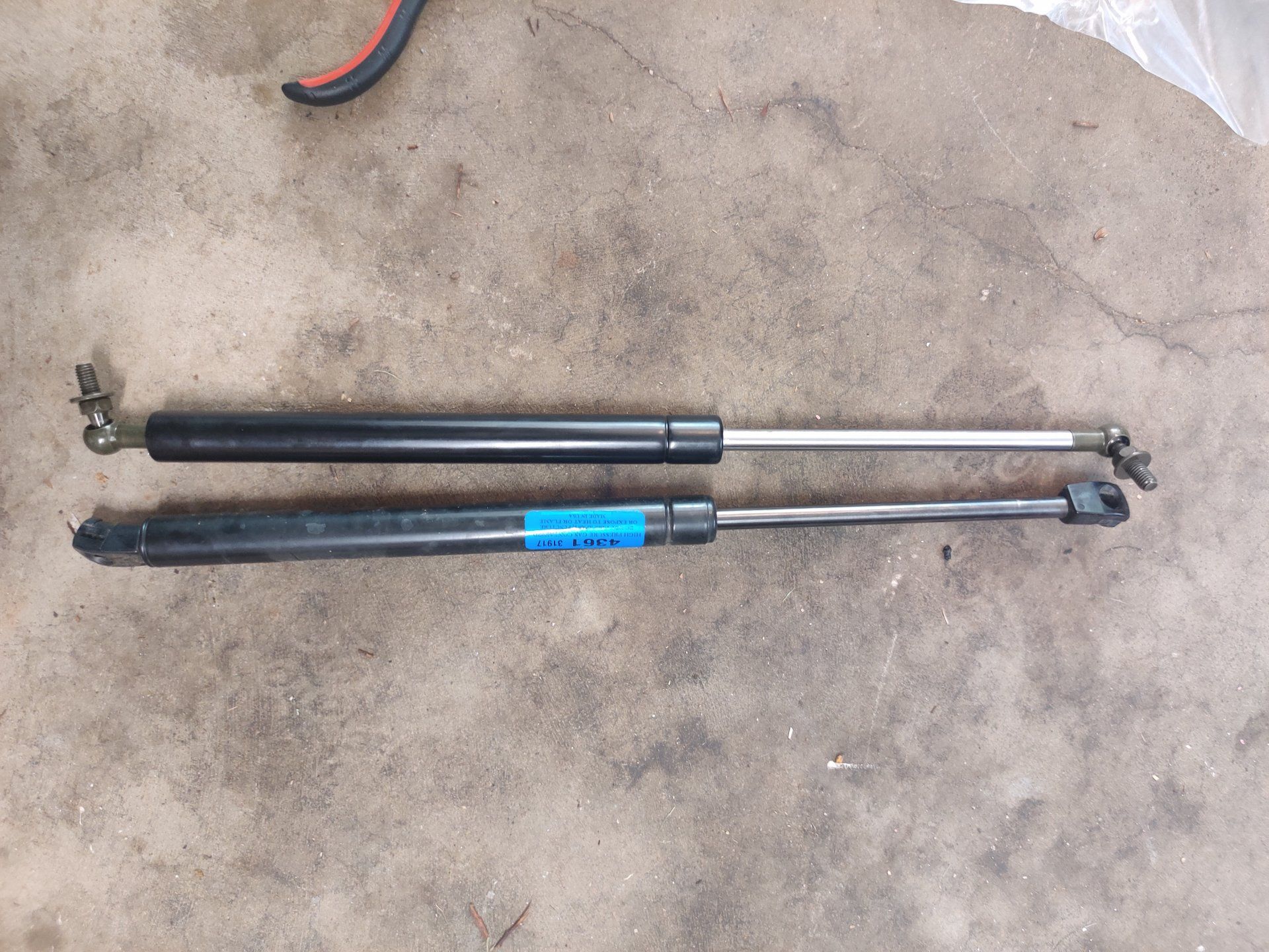

Hood & tailgate struts replaced. The last replacement Strongarm hood struts only lasted 2 years, hopefully these last longer, so to speak.
