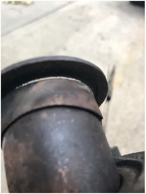

Definitely don't want to try and tackle a valve job if "you're fairly new to working on cars" try a timing belt job first or maybe a brake job. More than likely you have an exhaust tick which a very common thing on these vehicles. Buy a new manifold and since it's on the passenger side you got lucky. That's the easy one. You should never really open up an engine unless it's absolutely necessary.
I just repaired my drivers side tick. Check the torque on your spark plugs without undue delay (18 ft lbs). FSM calls for 13 but that is too light. Good luck!
