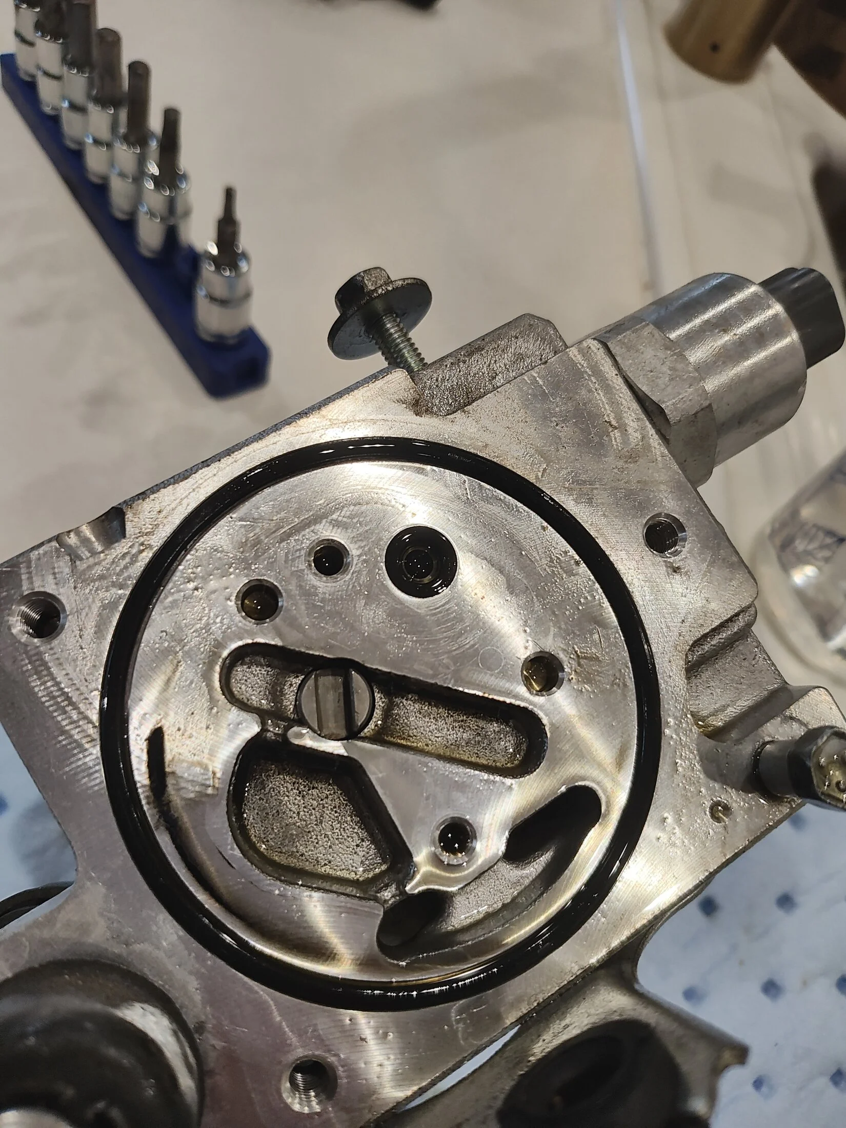

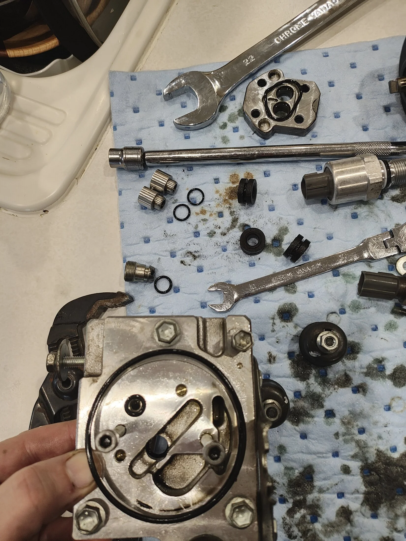

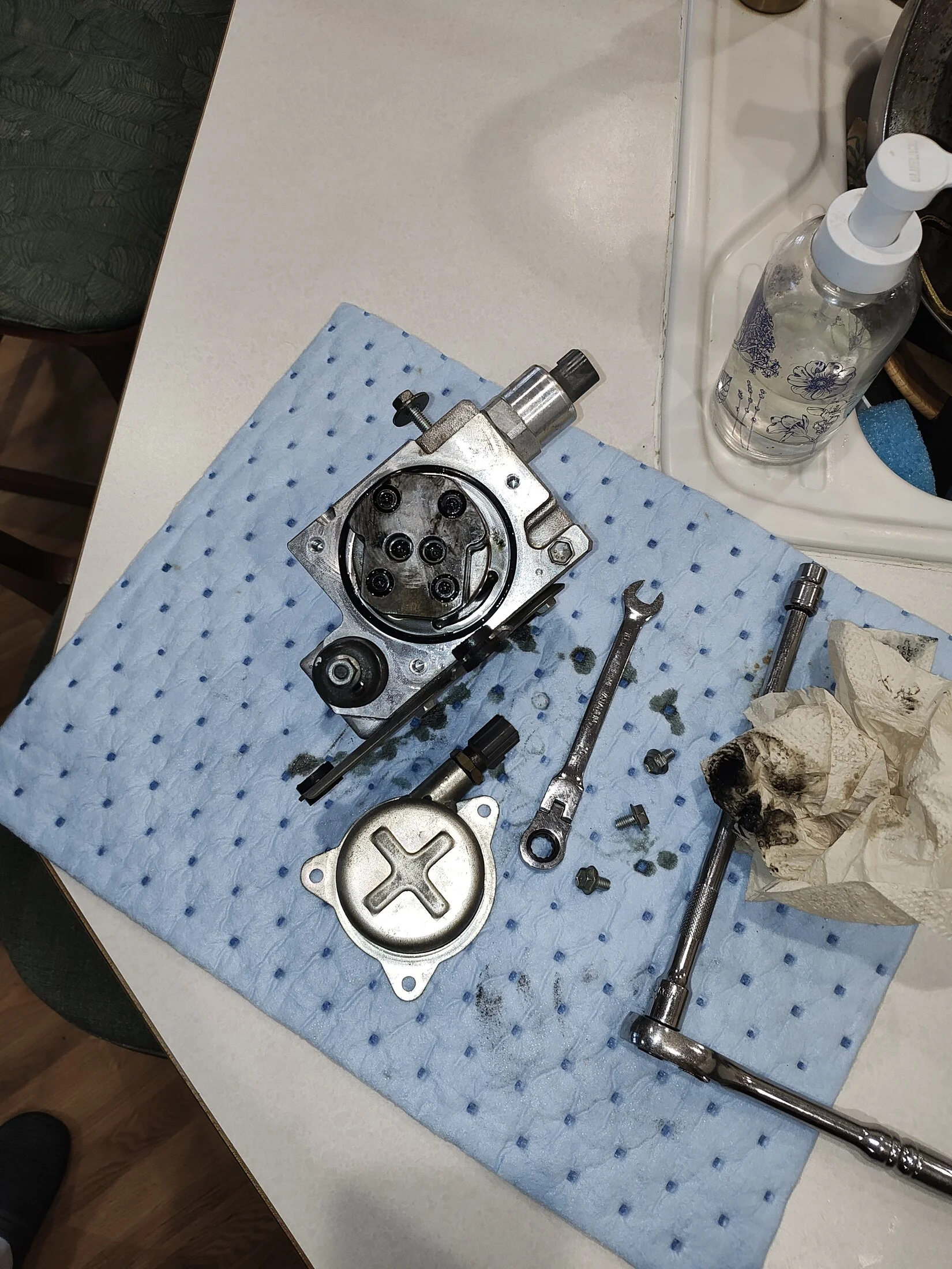

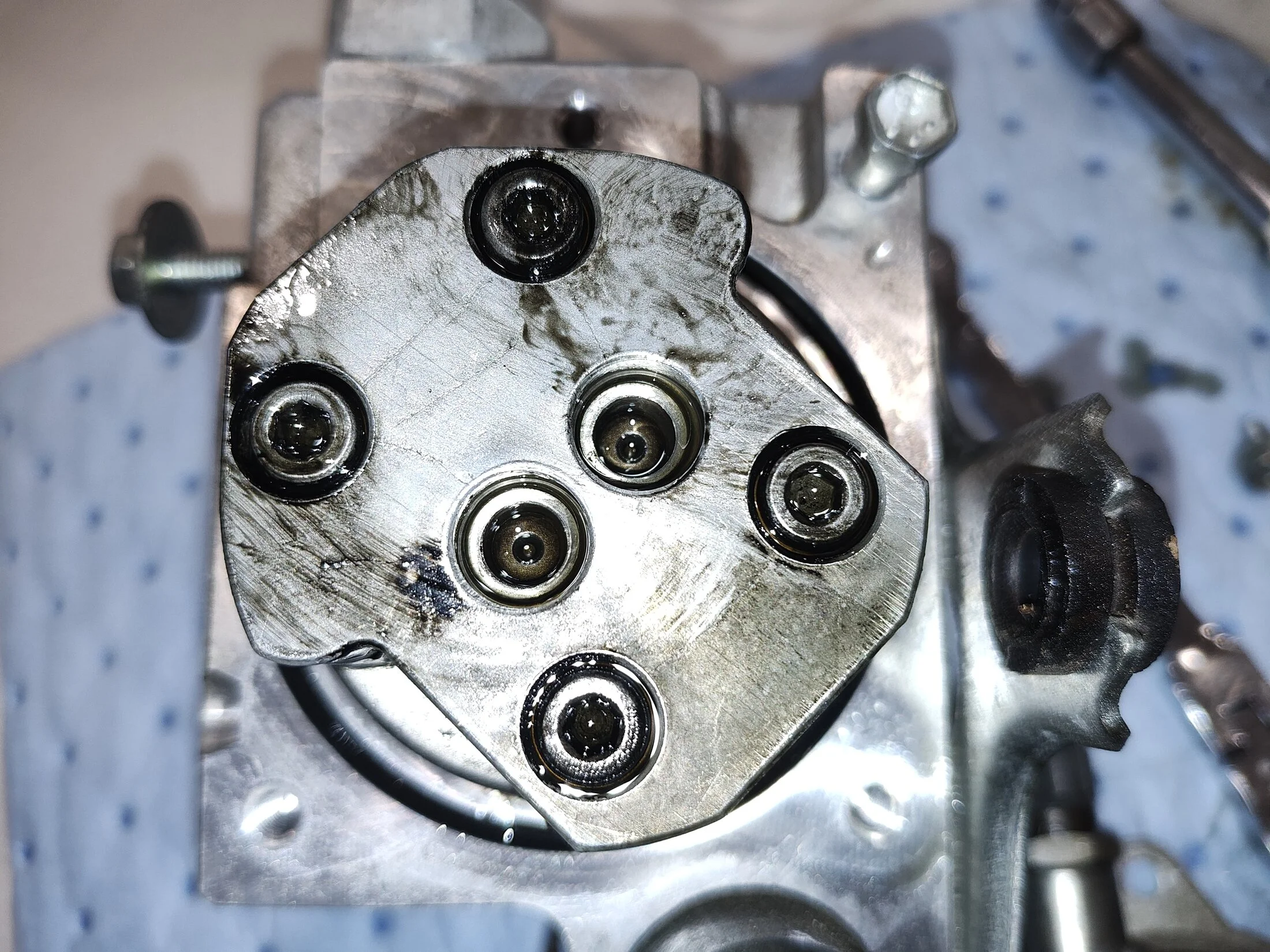

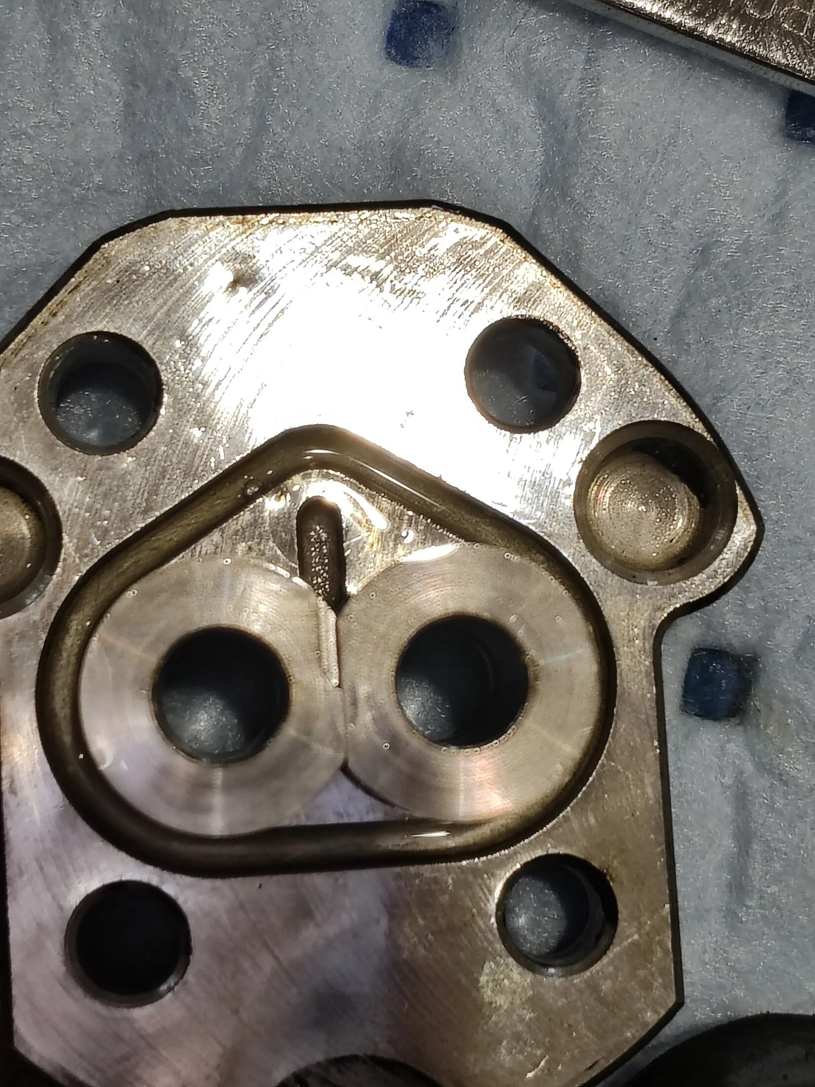

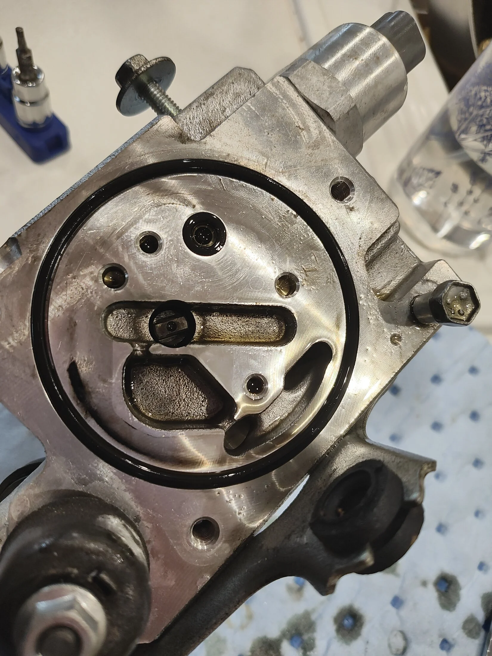

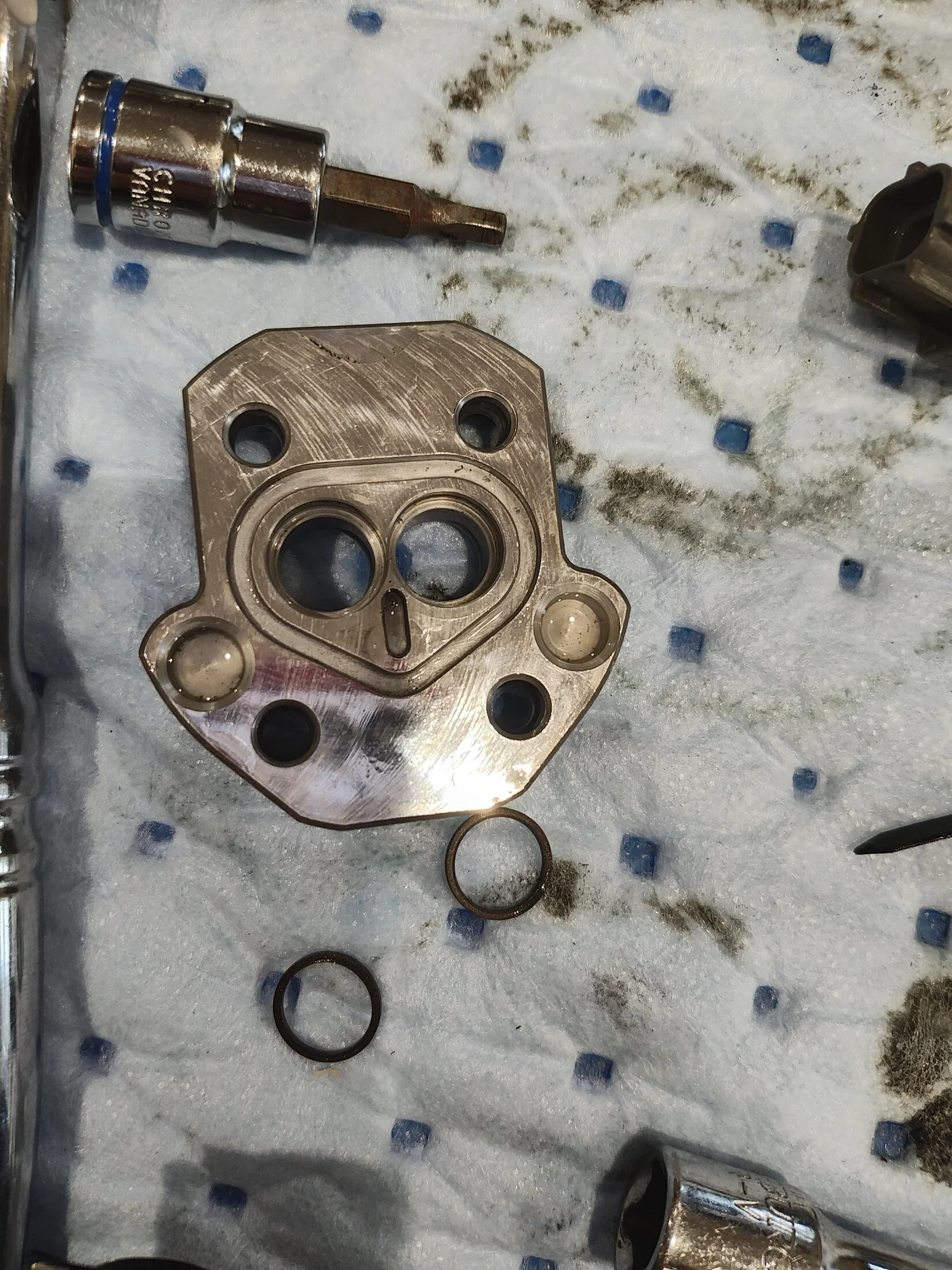

Got the AHC tank and pump removed, disassembled, and cleaned. Pump was nasty but as others have found, the internals were in great condition. Here are some pics to add to the collective experience. The only thing I noted was that the outboard end of the gearcase had both an oring and what appeared to be a fibrous or possibly metalic gasket. Also, therer was a connector that joins the motor shaft to the main gearshaft that I didn't see in other photos. Otherwise it went pretty smoothly, and parts came out of the washer spotless. Reassembly was unremarkable. I agree with the camp that says the slave gear orientation is inconsequential, as the gears are symmetrical and the free floats in groove which it sits.
Pump face with connection shaft
Sans connection shaft
Gaskets that sit on the outboard end of gear casing
Location or corresponding parts of all other orings

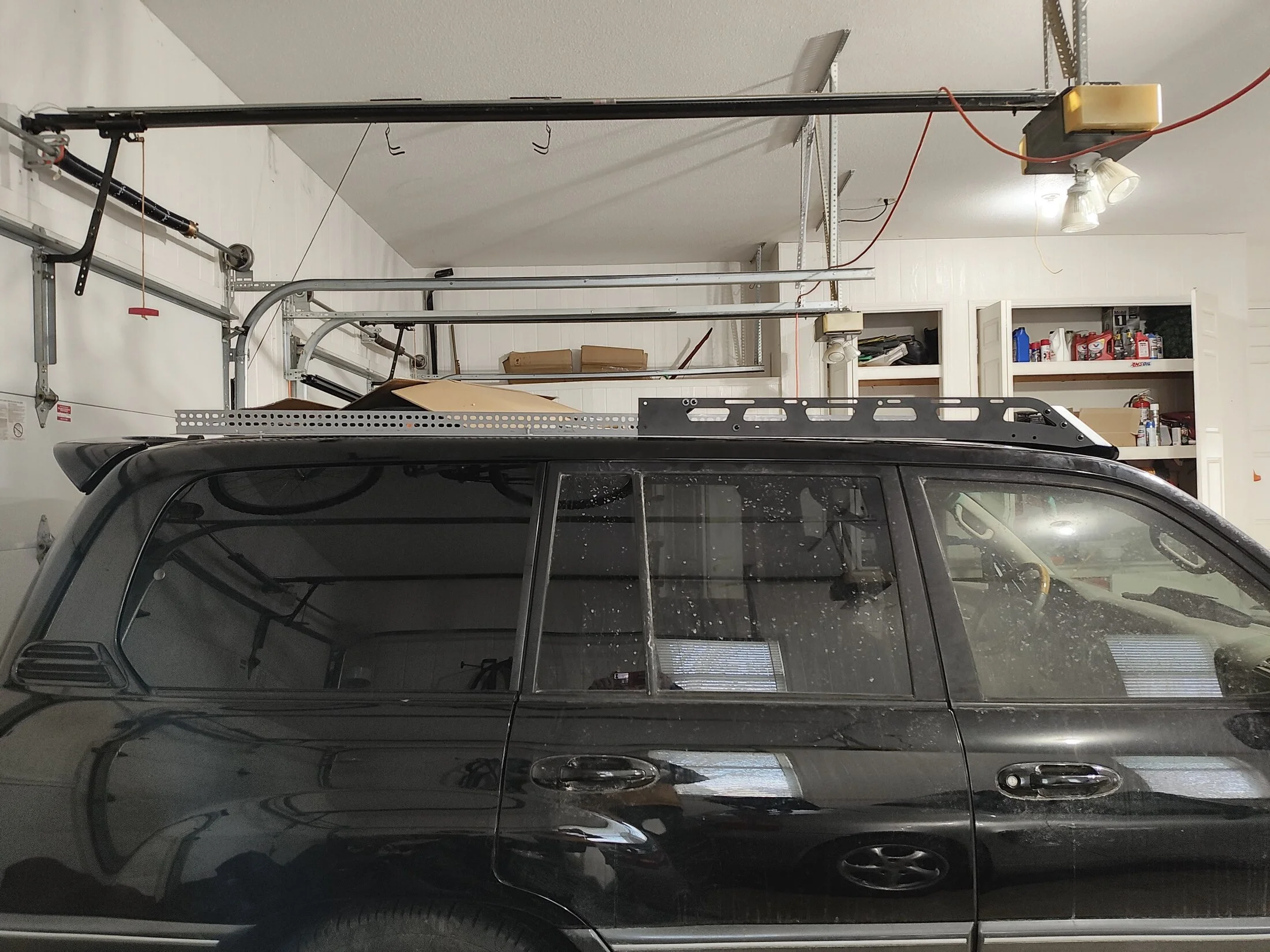

Oh, I forgot to mention. If anyone has ever wondered "will a roof rack from a gen 5 4 runner fit an lc100/lx470?" the answer is yes. The width of perfect. It requires some custom bracket work, the easiest is a 6' long section of slotted steel angle. The holes even line up pretty well too.

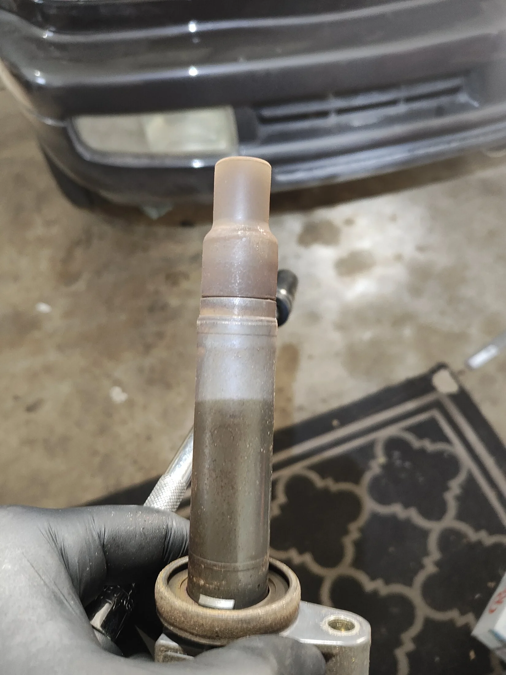

The rough idle at 2k RPM has been bugging me since we got the truck. It is subtle but I'm a stickler for that stuff so I investigated today. First thing I did was check spark plug torques - low and behold cylinder 6 plug was loose. I'm guessing that's why the ignition coil looked like this...
Tightened it down and the vibrations at 2k RPM are gone.
Note that this was after a dealership did a compression test! I will say it again - DO NOT TAKE ANY VEHICLE TO AUTO NATION TOYOTA IN ATLANTA. I hate s*** posting but damn, this is just not ok. Looks like it's time for new coils and plugs!
