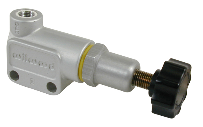

You could install a manual proportioning valve to tweak your brake bias. I think some folks have even installed this sort of thing in place of their LSPV. I'm not sure if this exact model will work....
Proportioning Valve - Product Summary
The new generation of adjustable proportioning valves combines the latest refinements to deliver precise pressure metering and strength from a compact forged billet design. Pressure adjustments range from 100-1000 PSI and provide for a maximum decrease of 57% in line pressure, the most of any available valve. Adjuster knob with fine thread tuning provides precise pressure adjustment. This adjustment lets you fine tune the front to rear braking balance by proportionally decreasing the rear brake line pressure. Valves weigh only 5.2 ounces and have two .25” side mounting holes spaced 1.00” apart. This valve varies from our standard Knob Style Proportioning valve, as the in and out ports are 3/8-24 inverted flare seats and do not require tube nut adapters to directly install 3/16 tubing with inverted flare 3/8-24 nuts.
I put slightly larger 4Runner calipers on my 1988 BJ74 but without the proportioning valve (LSPV) the rear brakes would still lock up.
When my LJ71 was on 33's with standard brakes & LSPV it stopped fine, but I put in one similar to this instead of the LSPV when I swapped axles & it works well. Should be a version available with the std Toyota M10x1 fittings too.
Another easy brake improvement if braking force is lacking as well as the balance being out is to swap in a double diaphragm booster off an 80 series. You just need to make a longer clevis on the pedal side.
