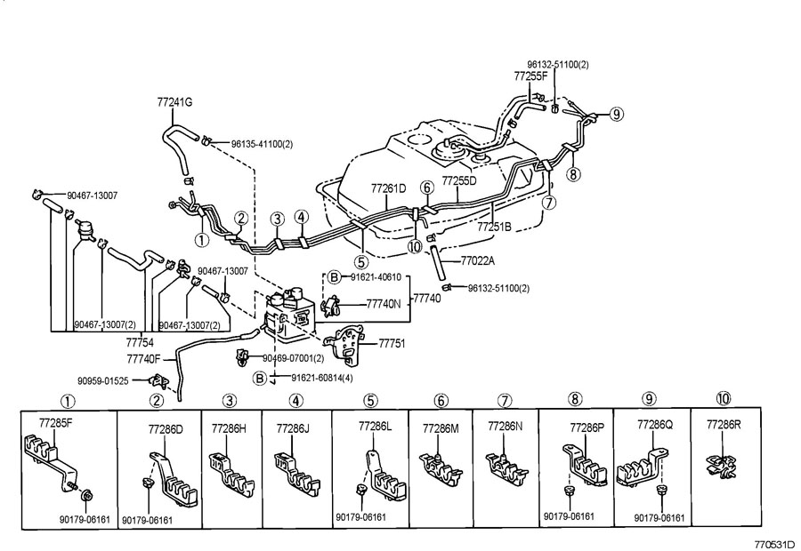

Man thank you so much, this is a game changer. Also do you know where to find a diagram for fuel lines or do we need to make them?
You will need the three main lines in the second picture... may as well buy all the mounts too:

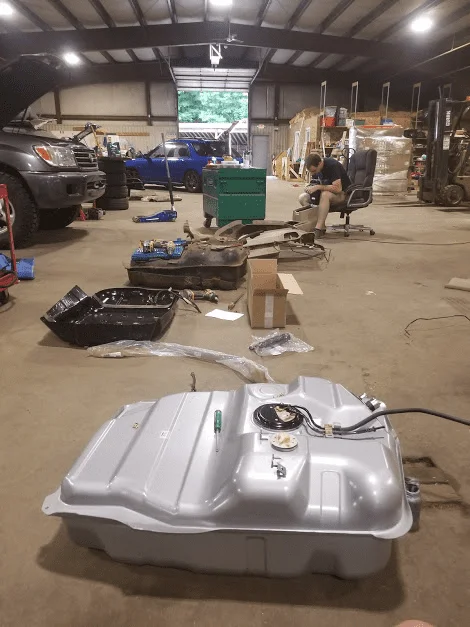

Rock auto tank, rock auto straps, used rust free skid repainted. Reused fuel pump sender. Feed, return, and evap lines OEM from dealer. The evap has a longer line, a rubber section, a short hardline. I deleted the short hardline and ran it all rubber. Snaking the OEM lines between the cab and frame SUCKS. They arent in the perfect OEM position, but I used a bunch of plastic fuel line clips to lock them down.
