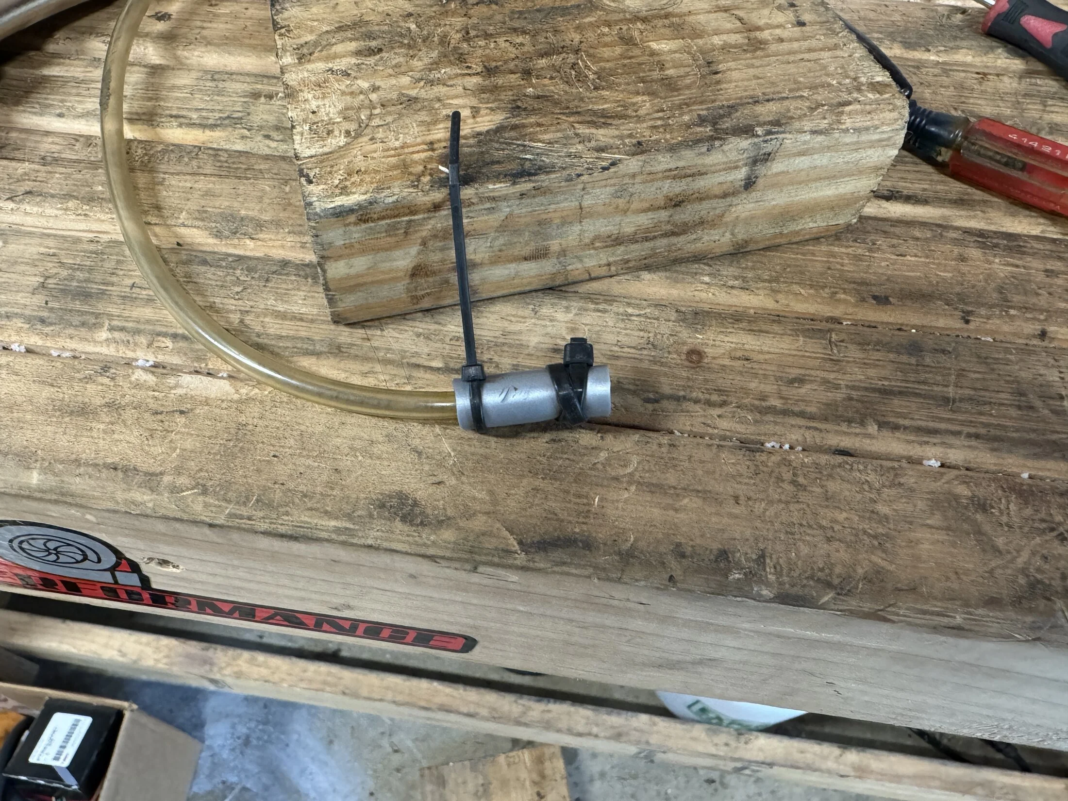

I've always used 1/16" ID vinyl tubing with a short section of softer silicon slipped onto the end of that. Two zip ties, one to hold it onto the vinyl, and another to adjust the correct diameter to get it tight on the bleed nipple, and you're set. I'll try to remember to get a picture when I get home later today.

It isn’t pretty but over probably 15 years it has worked on about a half dozen different vehicle manufacturers

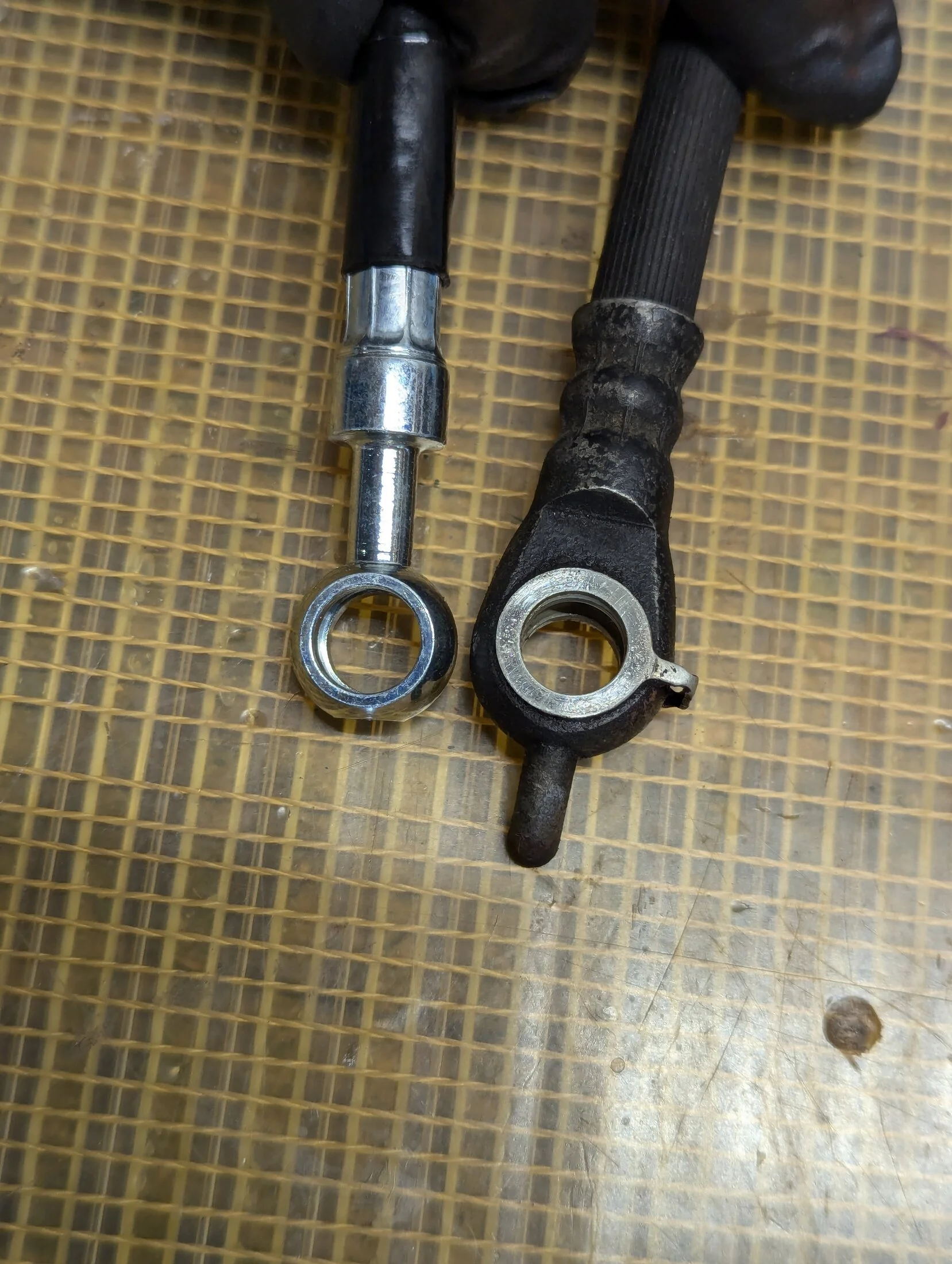

The banjo ends do not have the little "ears" on them to keep them in proper alignment when tightening the banjo bolt:
Similarly, the other ends that fit into the brackets at the hard lines don't have the "flats" that engage into the bracket to keep the hose from spinning while tightening the flare nut. I used an 18mm open-end backer wrench to hold it from turning.

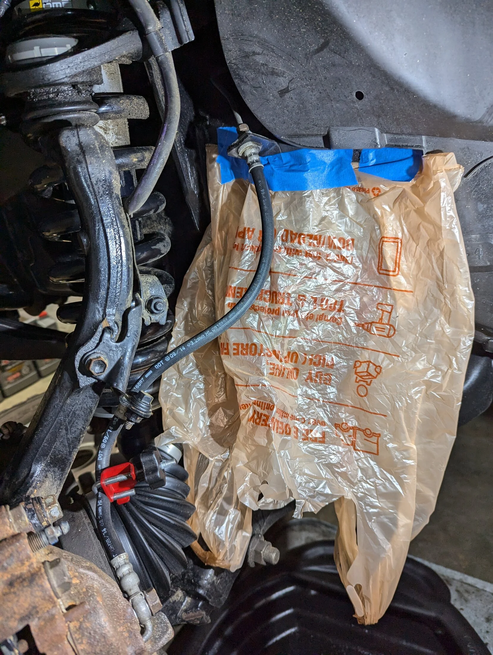

I didn't bother plugging the lines when they were open, here's how I did each line. I used a Harbor Freight line pinch clamp on the OLD line about mid point, then I broke all the fittings slightly loose. I removed the banjo bolt, cleaned the threads out to make sure no dirt entered the caliper (I actually pulled each caliper off and dumped out the old fluid, just to be thorough), then attached the new line at the banjo bolt, snugged tight. Then I quickly removed the upper end, first the little clip then the hard line flare nut, and quickly stabbed the new line on to the hard line. I doubt I lost more than a tablespoon of fluid at each connection, just put a catch pan under and be ready with tools and a rag, go quickly. I draped an old plastic bag on the front suspension to protect it from the spilled fluid (eats paint off!), this helped a lot with the mess. Oh yeah, I also swapped all the old bleeders out for Speed Bleeders (#639560). It is surprising how difficult it is to get 22 ft-lbs on those banjo bolts!
Front line all installed (pass side):
