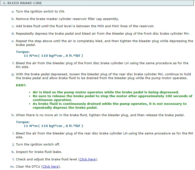

Steps:
1. Remove old fluid by sucking out from reservoir.. i used a big syringe... get as much without going below minimum
2. Fill up with new brake fluid.. i used the new bosch brake fluid. Compatible with dot 3, 4 or 5
3. Turn on ignition. Start bleeding in front right. Turn wheel to left most.. you can access bleeder. Have another person to pump and hold brakes. Bleed brakes until fluid clear.
4. Bleed left front. Turn steering wheel right most and bleed accordingly
5. Always check level of brake fluid in reservoir to make sure dont go below min.
6. Move to the rear right. Make sure ignition is on. Crawl underneath to access bleeder valve.. have someone step on brakes. Do not pump, just step on brake pedal. Crack open bleeder and fluid will flow out continously. Close when fluid is clear.
7. Do to left rear wheel. Ignition on. Brake pedal depressed. Open bleeder. Close when fluid is clear.
Flush done!! 30 minutes tops.
Pedal feel actually improved!! Maybe bosch fluid better.

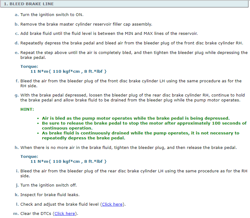

While that's probably true for old brake systems, the electric brake booster style system in the 200-series recommends starting with the front axle, passenger caliper.

I had the same question as I have a Motive Power Bleeder. The rear axle may not work because it seems to be electrically pumped? Rather than figure it out, I just had my daughter help to manually step on the brake per the repair manual.

In the past I was taught to flush the line furthest from the master cylinder first and move progressively toward the closest. Is that not how you do it on the cruiser? I have an adapter for the cruiser for my motive power bleeder but haven’t had a chance to use it yet.
I too have the motive but decided to go with toyota recommended method. Its so simple anyway. There must be a reason why toyota suggested to start in front... i agree, all y other cars start at the farthest brake from the reservoir ,not for this case... no need to bleed abs, no repairs done nor was the reservoir level drained to allow air to come in... this is for the basic maintenance flush

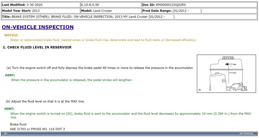

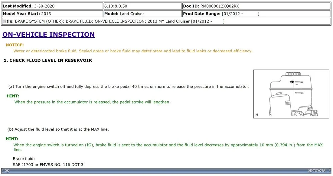

I don’t see it on the above procedure but pressing the brakes repeatedly with the ignition off to depressurize the accumulator is somewhere in the FSM. This pushes any old fluid located inside it out to the reservoir where it can be pumped back up with fresh fluid if it’s available next time the ignition is switched on
In fact on 100-series you are supposed to bleed the accumulator before checking fluid level.. otherwise if you fill the res and it bleeds down for some reason when sitting for a while it’ll overflow the res

I think this is what you are referring to:
