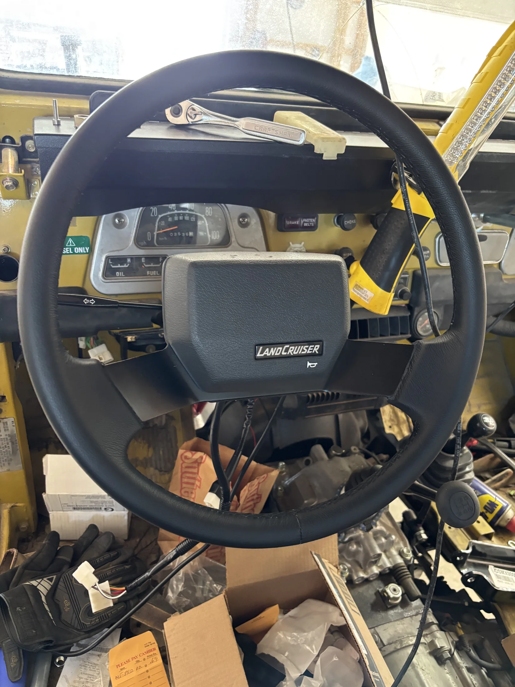

@POPO AGIE has a good point. You might be able to adapt the later model smaller steering wheel or one from another model. I know at some point they did change the spline count for a couple of years.
Mine is a 78 and I did a test fit with the new wheel and dropped right on.
I looked at a lot of after market and Land Cruiser wheels and liked this one. Only has a horn so the wiring was nothing to worry about and no cruise control that my kit has a the buttons that will mount where seems the best.

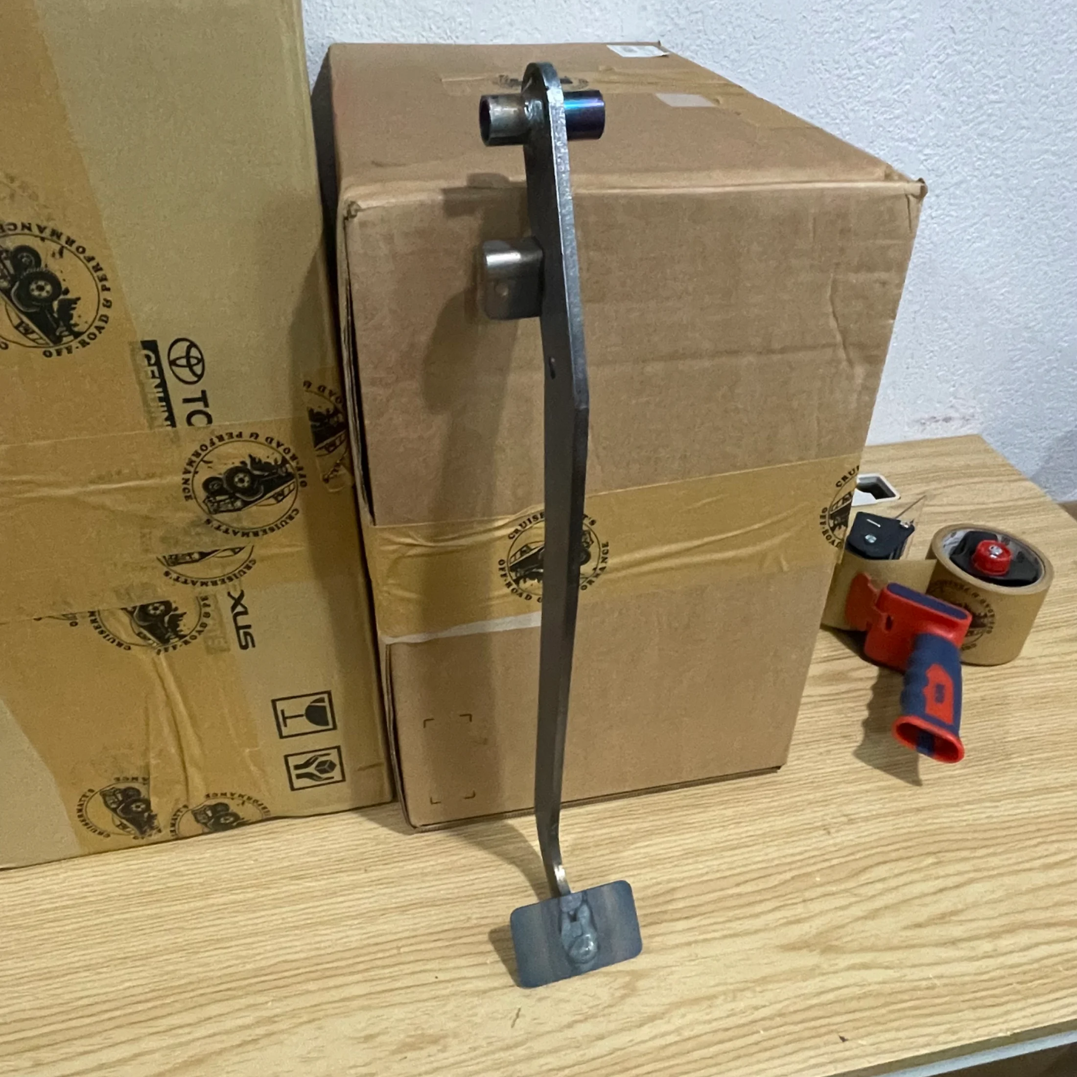

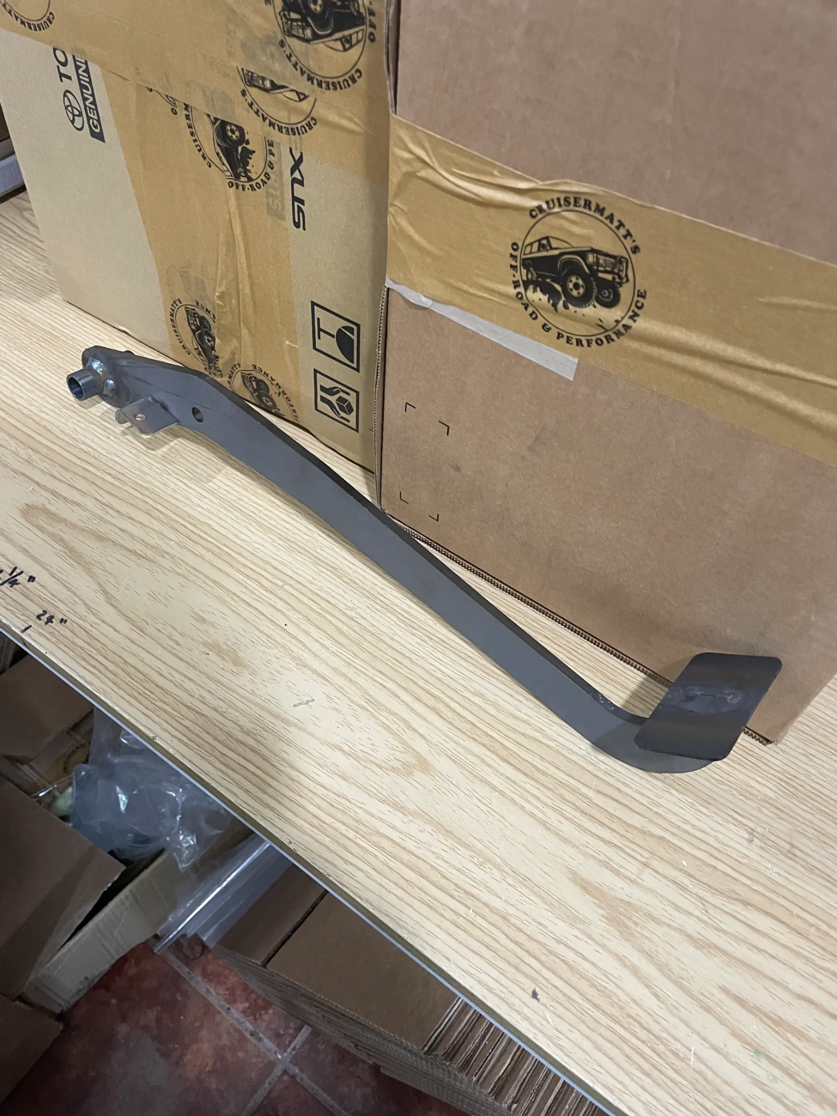

This is *almost* exactly what you are asking for :)
EDIT - I just saw your location is UK. Is your vehicle RHD? I'm not sure how different the RHD 40 pedals are.
I manufacture a lower brake pedal for those with automatic transmissions. (brakes are used way more, and transition from gas to brakes needs to be much more ergonomic then with a manual transmission).
It should work well for you as long as it doesn't interfere with the clutch pedal since it is a bit more to the left, I can install on in one of my stock 40's and see how close it gets and take some measurements. Or potentially modify the deisgn for you a bit.

Hi Matt,
This looks to be the perfect solution!!
Will PM you. Cheers.

Please see my note about RHD. If you can post a few good pictures of your pedals (showing the entire pedal/mounting) that would be helpful.
