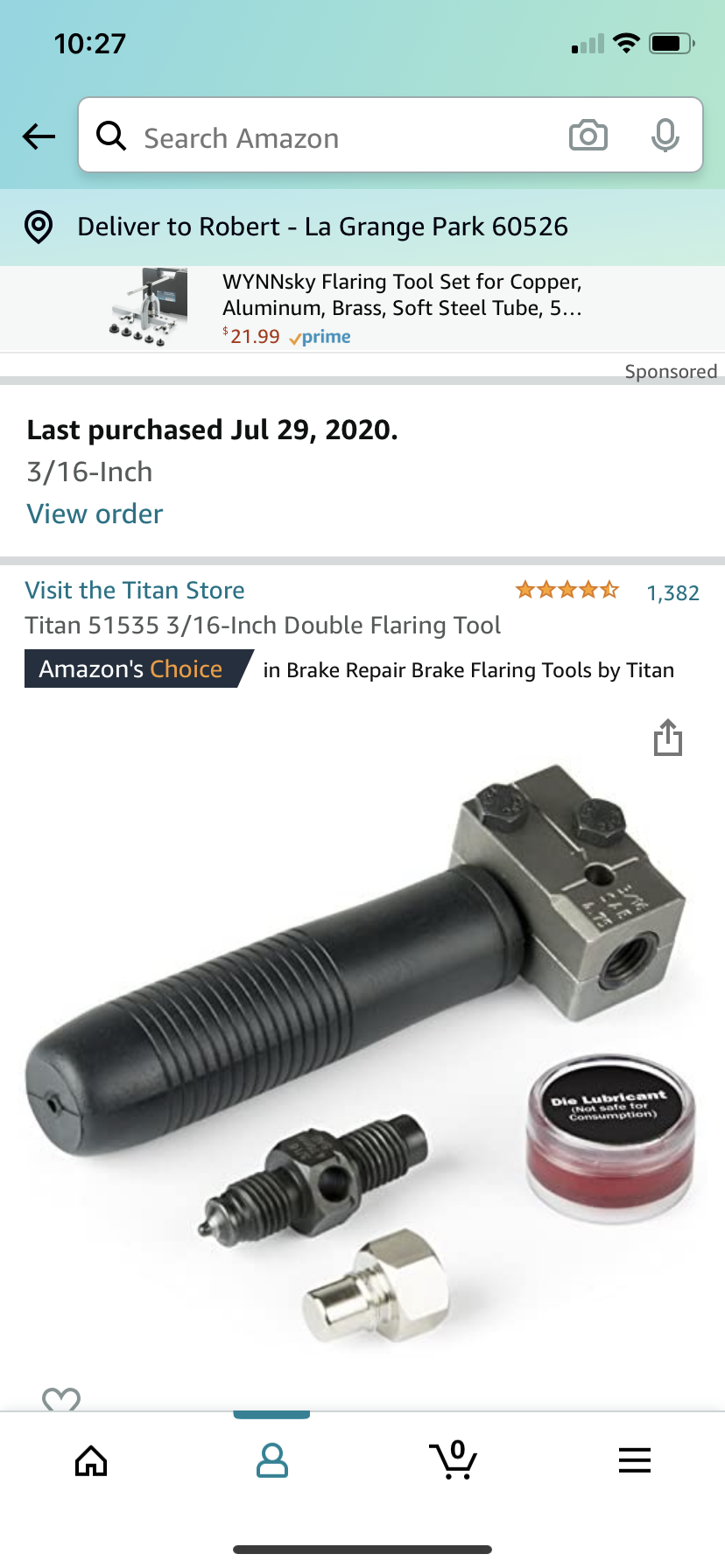

The flare tool I purchased and couplings. Made a very nice double flare.
