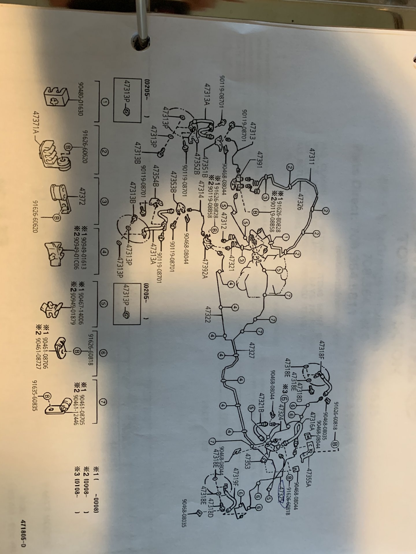

Thanks for the info! I went onto partsouq to try to identify the parts that I would need. But I cant seem to find/see the hardline and fittings. Do you have any part numbers I can search for?
Enter your VIN on Partsouq and look at the category power train /chassis tab and youll find the Brake Tube and Clamp category for the diagram and part numbers of the brake system.
You need the hardline from the booster all the way back.
