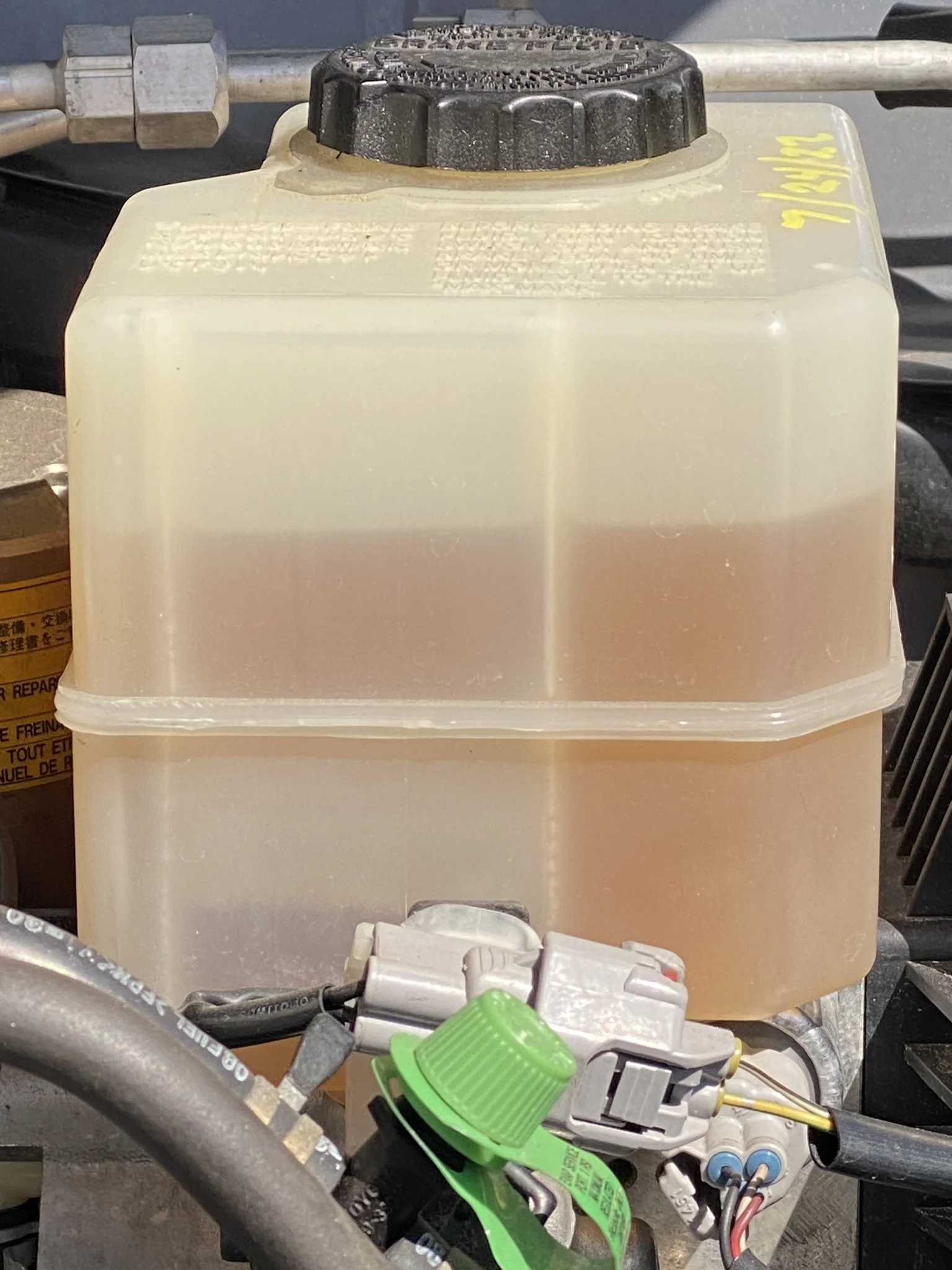

I have no idea how long the brake fluid was in my truck. I can see that my brake master assembly appears to be original and the truck now has 289,000 miles on it. I bought this LC100 with 261k on it. I flushed the rear about 6 months or so ago with Toyota oem when I was doing rear brakes.
when I eventually have to replace the expensive brake master assembly, which I hope I’ll get another 50,000 miles or more out of my original, and when that fails I plan to use OEM Brake fluid from Toyota for my new $1300.00+ assembly. I’m not really sure if it’s gonna make a difference what fluid I use. When I was a less experienced do-it-yourself mechanic I never cared about brake fluid and I never changed it and by luck 🍀 I never had any problems with the 10 different vehicles I’ve owned.
Staining inside the reservoir, can give clue to age. If toyota factory fill, it can last for 7 to 14 years (Depending on humidity, where operated) without much if any staining or darkening of fluid.
Staining of reservoir, may happen sooner, if any other brand brake fluid added (topping). Topping should not be needed, unless brake fluid removed. Removed like when, replacing pad and or rotors.

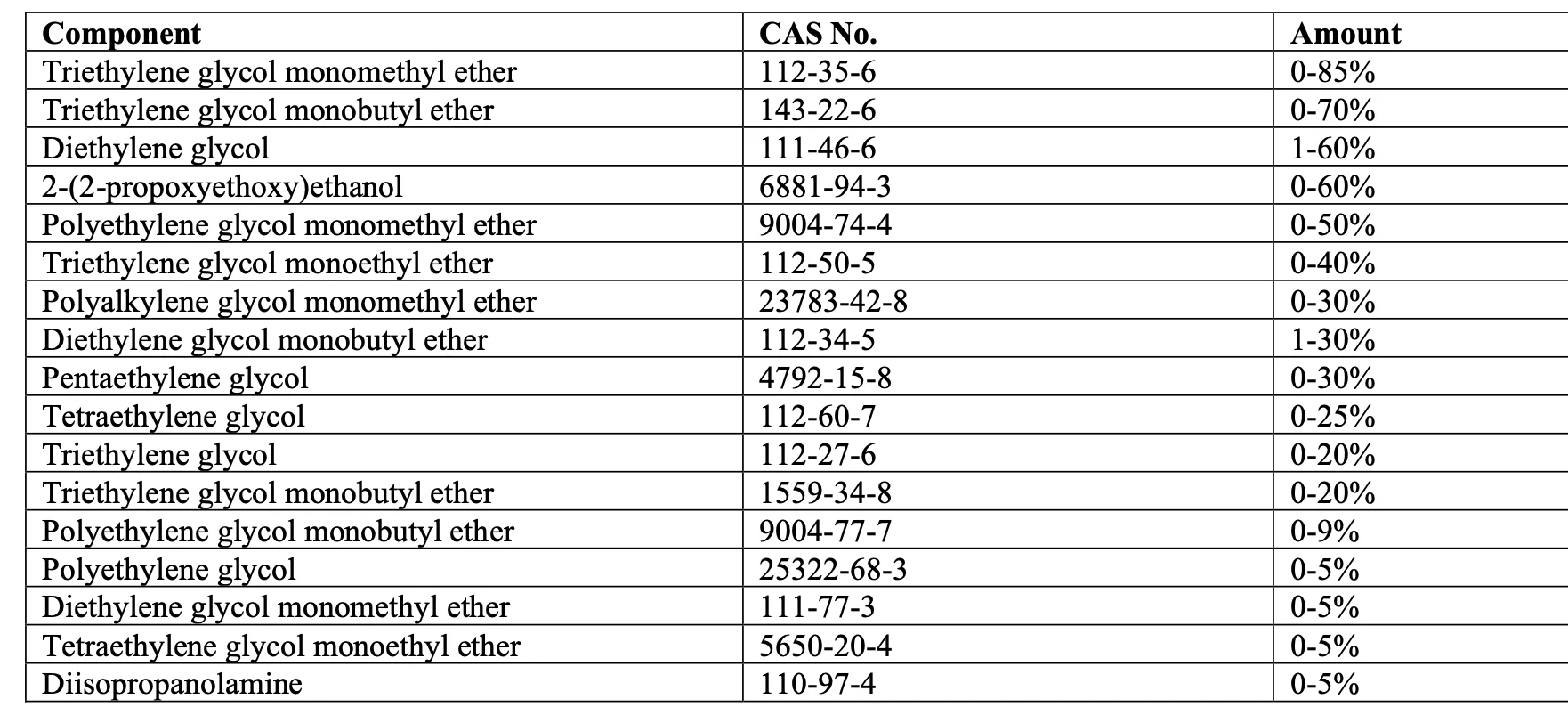

HERE IS WHAT IS IN PRESTONE SYNTHETIC DOT 3 BRAKE FLUID. EXACT AMOUNTS ARE TRADE SECRET..

In general, anything that has glycol/ether in the name will break rubber down over time. If you were to search the definition for each one of these agents listed above, you'd find yourself having to look up more terms to lead to an understanding of what each one agent does, and trust me, you'd be VERY DEEP into the chemistry before you had an understanding of it all unless you are Steve Hawking. I'd rather just trust the Toyota fluid and move on.
I'm curious if they're purposely arriving at those percentages, or if that's just an analysis of the resulting fluid after whoever makes it for Toyota combines the alcohol and glycerine.

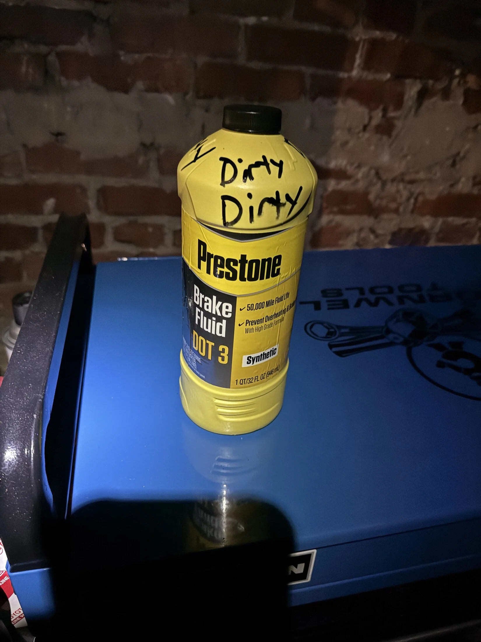

Did u end up flushing the prestone out?
I did a complete flush, twice, 4 months ago and this morning i noticed the fluid looks greyish already.
I have another sealed 1L prestone bottle, I was thinking of another flush incase the new fluid already got contaminated with some sort of residues in the system after the first flush?!!
