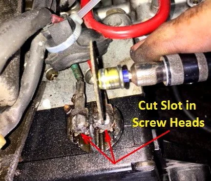

I cleaned up the connection a bit just so I could see what I am dealing with.
No way to use the heads of the screws as they are....so I cut a slot in each one:
A flathead screwdriver is now a good fit, BUT if they don't break loose easily in the morning after soaking in penetrating oil, then I'll probably have to grind the heads off. Looks like there are nuts underneath the posts and I don't want to break the plastic or twist off the post connections.

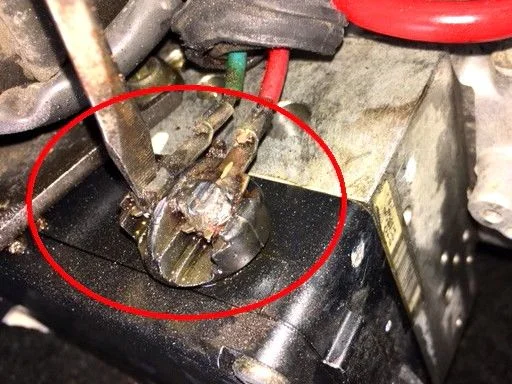

So did mine..... until the next day. Working on mine today, by coincidence. I was shocked to see how corroded the wire connections were at the ABS unit. Not too bad at the motor but at the ABS unit you can't even tell these are screws. Not even sure yet how I am going to get them off.
At motor:

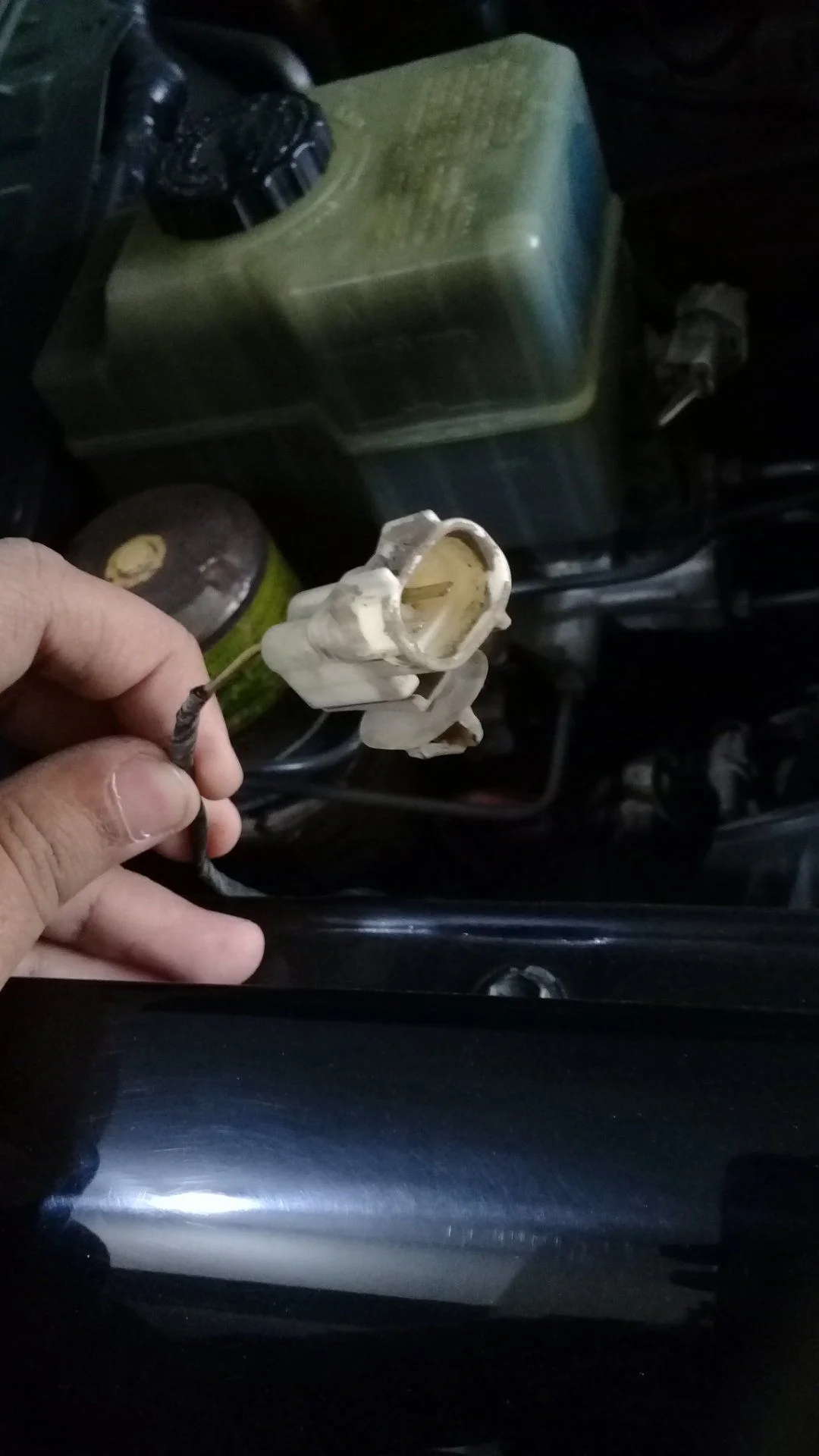

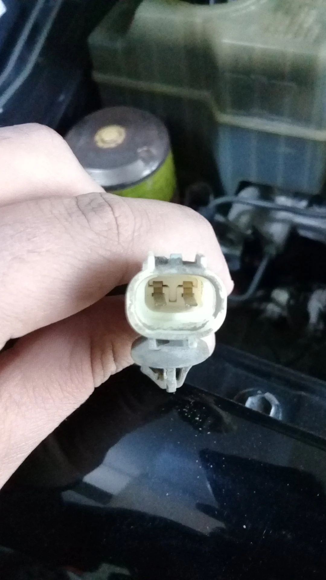

And btw i found this wire under accumulator.
Looks like it is recently unpluged.
