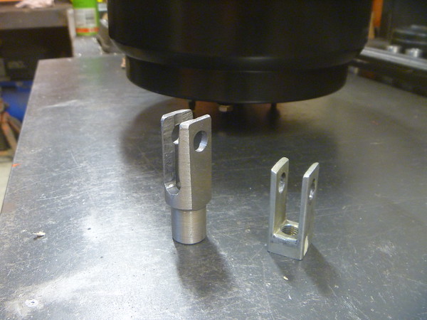

I'm having a hard time imagining it. Do you have a picture of that setup?
Thanks everyone!
Ahhh! cleverly simple. Muchas gracias!

I made a longer clevis to adapt it up in my LJ71, works great, an absolute no-brainer of a mod if you're running big tyres &/or heavy loads.

Just did this upgrade, wow. Brake pedal feels way better and the truck stops much quicker. Extended the rod ~1" (25mm), using an old rod fitting, drilled it out, tapped it all the way through (M10x1.25), cut it to length (1"), then welded it to the 80 series pedal clevis.
