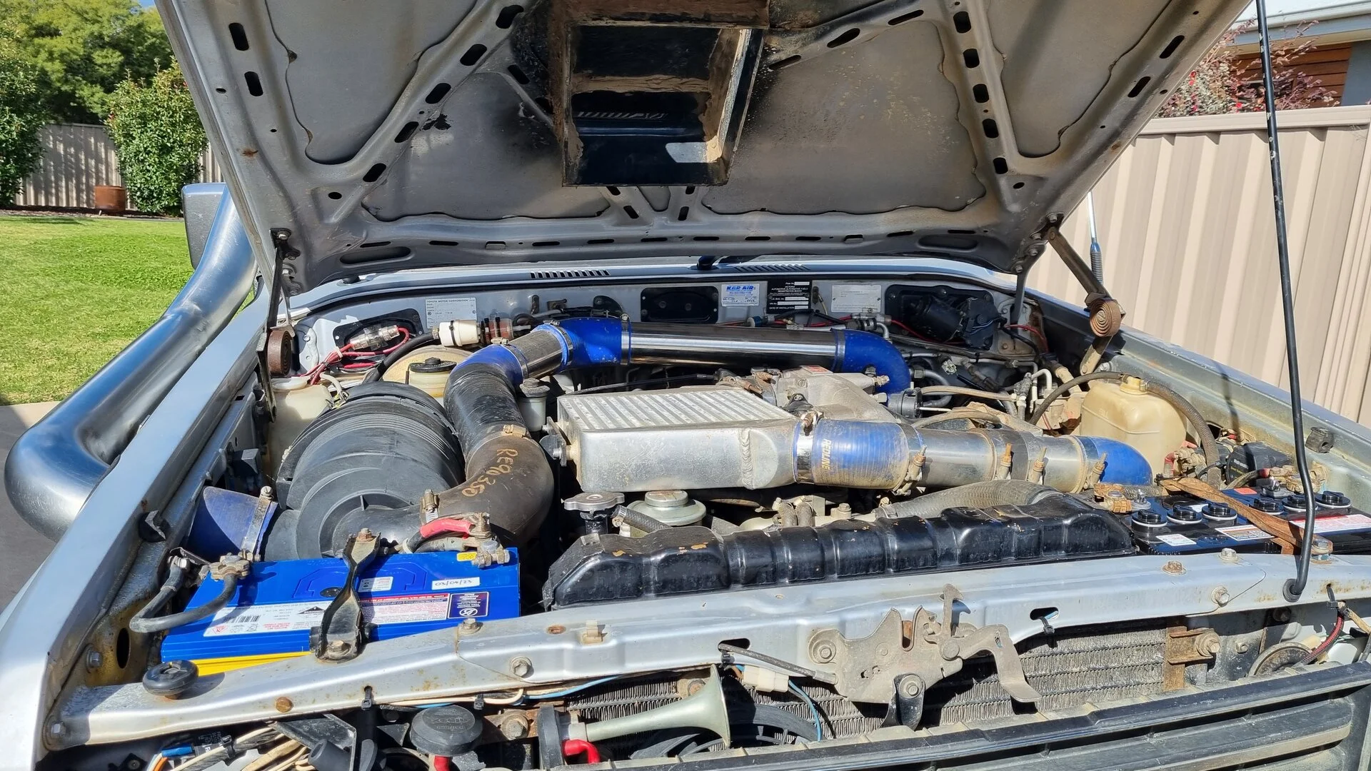

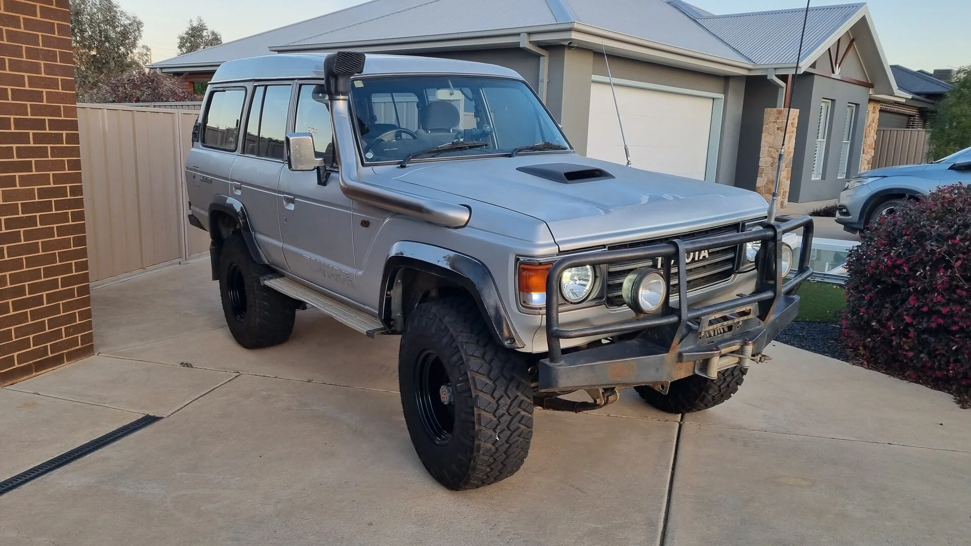

Pics of truck for good measure because obviously this thread is worthless without pics.

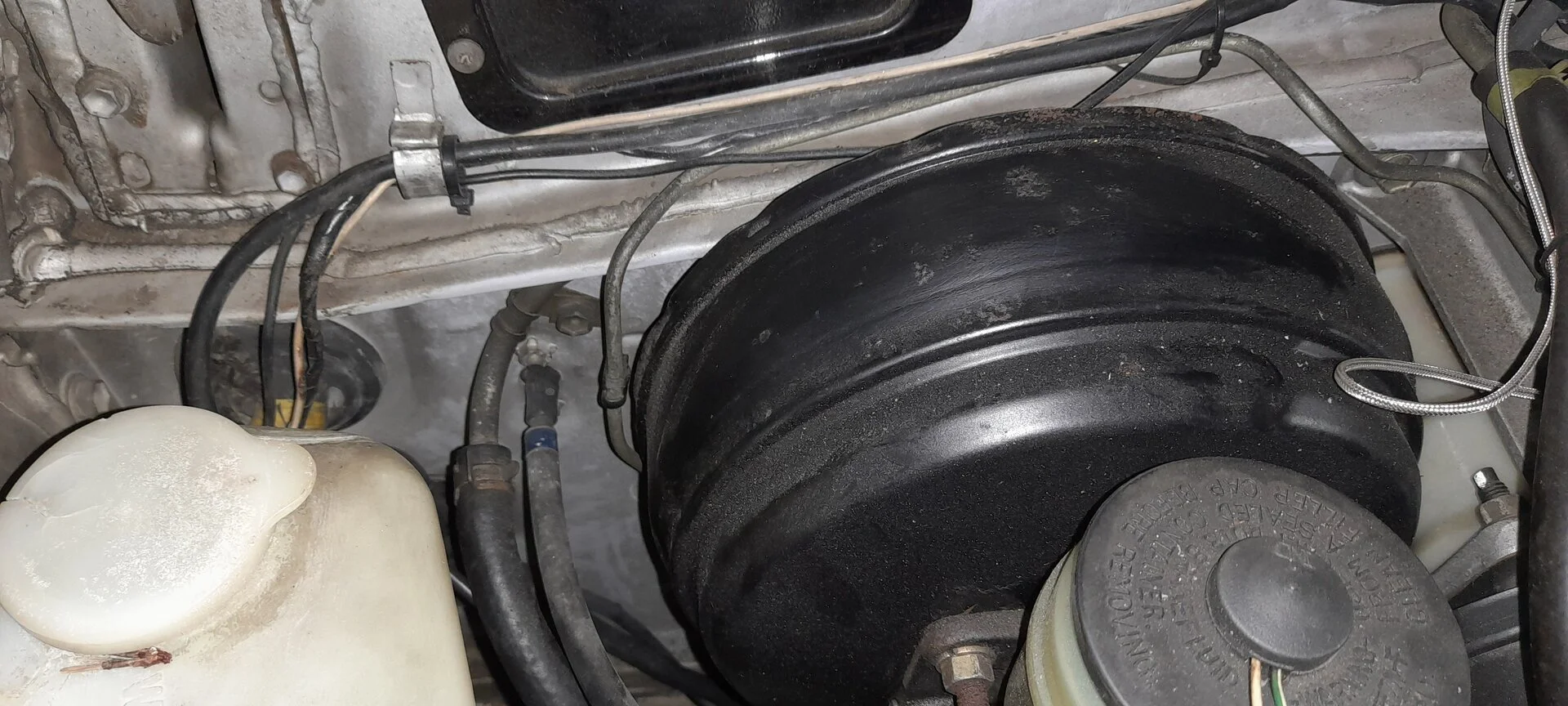

I have fitted a double diaphragm booster beside my clutch booster without issues - although it came out of a '94 or so Hilux.
Apparently they are the same dia. as the late 60 or 80 series ones just the vacuum port is at annother spot.
Can make a pic tommorow.

No worries. She got new wheels today in case anyone is interested, went from 16x8 N22 offset to 16x10 N30 to give a bit more tyre clearance to the springs at full lock

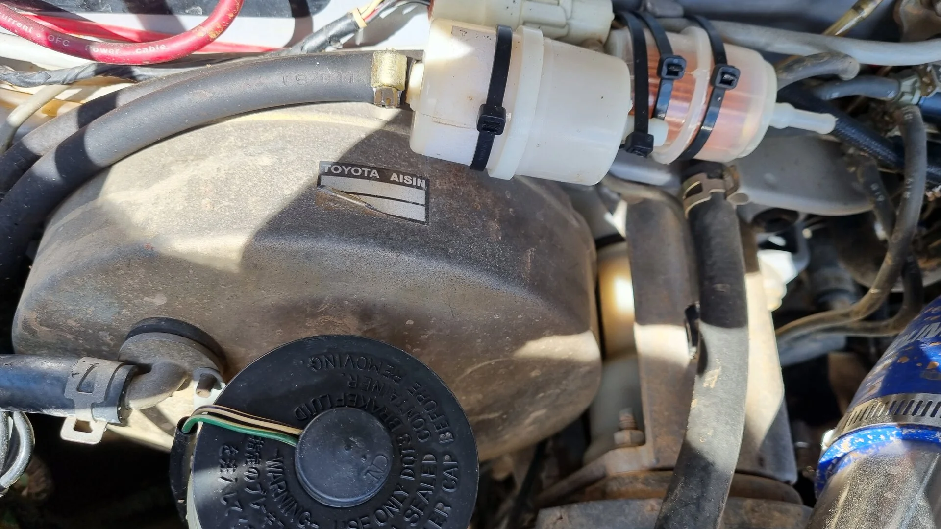

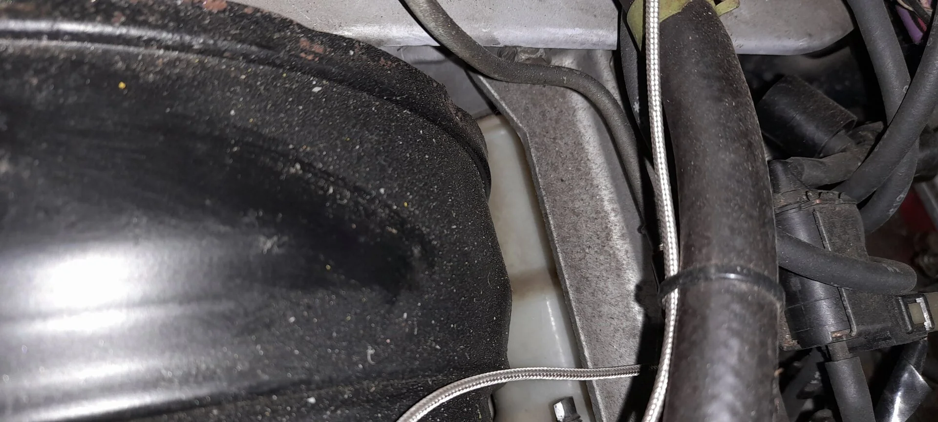

So here are finally my pics from the double diapragm booster. As stated earlier that one is from an ~ 94 Hilux but I believe it is the same dia. as the 80 series one. Just cheaper here...that one also has to be mounted upsidedown and the only difference is the position of the vacuum port which is not a issue at all. The Aisin sticker is of course only readable from underneath ... Other than that it was plug and play - It fits like the single diaphragm one, maybe a tad larger.
But be aware that the double booster is not making your brakes any stronger - that is a common disbelieve - it just helps you to push the pedal...I dont want to be without that help anymore though.

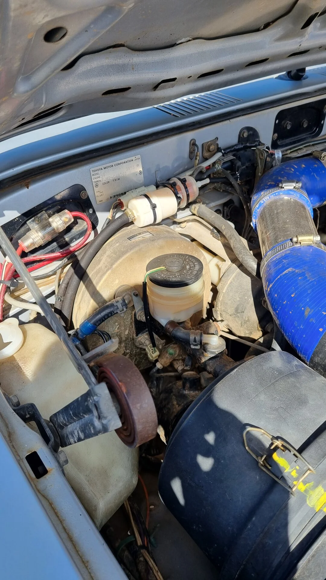

For anyone looking in the future, an 80 series brake booster does fit with a clutch booster, it's tight and you need to unbolt the clutch booster/master assembly at the firewall to get it in, but it does fit and does provide a significant upgrade over the originally fitted booster.
I used an Advics version of 44610-60570 which is for a HZJ80 (we can supply if anyone else is looking for one, I don't believe OEM is still available)
